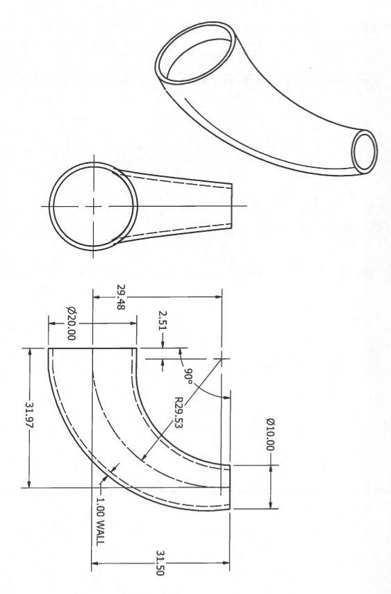

I need help modeling a reducing elbow from sheet metal fro production Paula Restrepo 26 Aug, 2020 09:49 PM I can't get it to follow the radius and need it from sheet metal to get the flat pattern for production. redelbow.JPG Accepted answer J. Riend Answered on 27 Aug, 2020 10:47 PM One way is to model Half of cone with Loft, then Flatten feature. (SW2019) Good luck. bent cone.PNG bent cone.STEP bent cone.SLDPRT 0 Other answers
