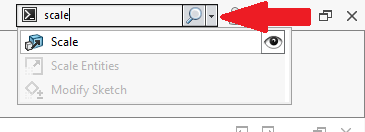

"And as @FredSWUG mentioned Scale feature in SolidWorks can be found in "Mold Tools" or simply searching in "Search Commands" on the top-right
