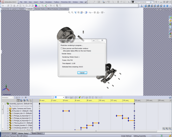

Hi, I tried to render one animation in photoview and the only result I am getting is 2-3 sec. of render animation and that is all. And duration of animation is 15 sec., so what should I do?
P.S.: I have AMD Radeon HD 7670M, i3-2370M 2.40 GHz and 4 GB of ram.

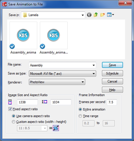

Can you upload some screenshots of your settings before you begin your render?
Yes I can. :)

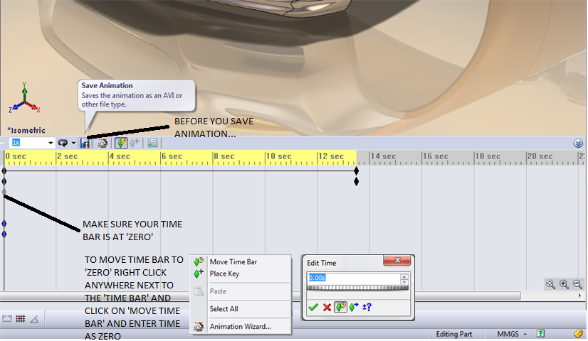

Thanks! Hmmm, Interesting. One thing I can think of is that, is the 'timer bar' for your animation at 'zero' when you 'save animation to file'?
So if I understand You I should in option 'frame information' set from zero to time when the animation is at it's end?
Ummm, not at the end but at the beginning, just before you save. please see attached.

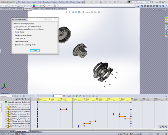

In file Assembly_ispravno.SLDASM you have animation.
Step 1
Step 2
Thank You very much :).
