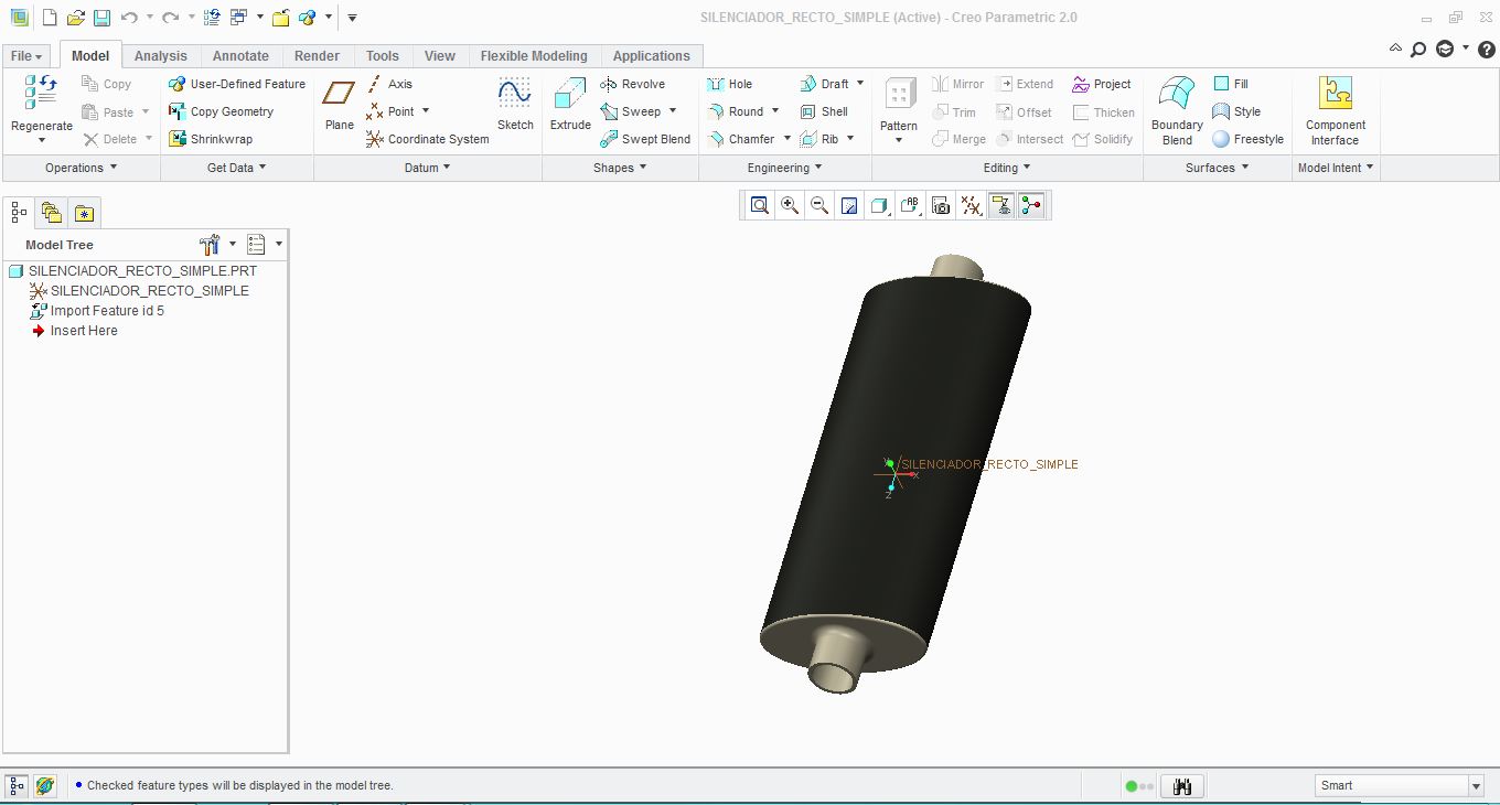

Planes not displayed in creo ? (Not talking about Plane display check box )
I am using creo parametric 2.0 , i need a little bit help about configuration.
When i open any file which is not modeled on my computer creo do not show reference planes. I have tried to change a settings my using tree filter option , please help me .
Usually imported files don't need planes they need only o coordinate system. To have the planes in your model you need to have a template what will be used when you open (import) an non native Creo file.
Setup your config.pro by trying this.
! Use default templates when opening a translator part
intf_in_use_template_models yes
This will use your standard start parts as the start file for an imported
file.
