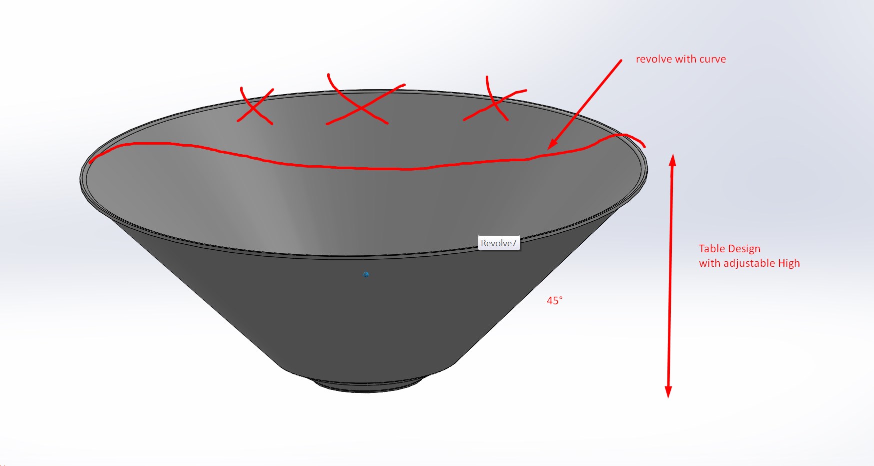

revolve with curve on top end
Hello, I'm pretty sure this can't be achieve with just a revolve feature, but I asked anyway.
I'm looking for a way to create a cone with variable high (design Table) and the top edge to follow a curves instead of being regular.
What should be used instead, a loft?
Using an another sketch to cut the curve will never be smooth on the intersection with he edge I'm afraid.

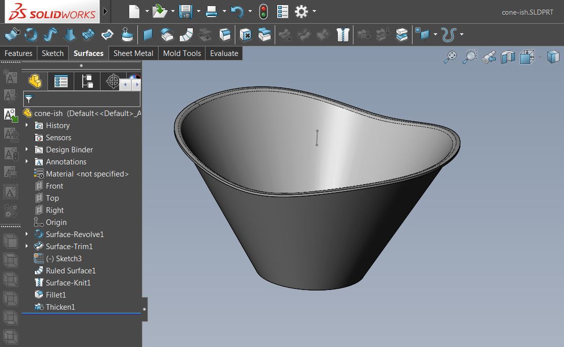

I did what I think you're asking about by:
-revolving a surface
-trimming it's top to achieve the desired curve
-adding ruled surface to curved edge to create the flange around the top, knitting it with the trimmed surface and blending them together with a fillet
-thickening the surface to create solid geometry
I skipped (forgot;-) making a design table to drive the height, but that's simple enough.
Maybe this gives you some inspiration. There are probably other ways, such as lofting as you have mentioned, but this seemed the most straightforward to my tired-from-the-day brain.
Done in no time where I will have done it in half a day, Respect. Still have to deal with the design table, but I've been able to do it on a single sketch so I guess I will be able to do it on top of other Feature as well.
