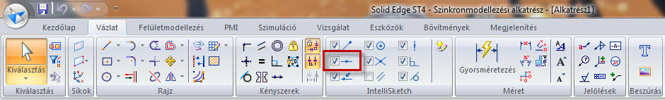

Solid Edge midpoint snap Jonathan Smith 17 Oct, 2011 12:05 PM Hi all! Where is it possible to add midpoint snap while doing sketch in Solid Edge? Can anybody upload a quick screenshot please. Thank you! 3 Answers Tóth Béla Answered on 17 Oct, 2011 05:00 PM Sketch menu, IntelliSketch - toggle Midpoint relationship indicator ON middle point.jpg Ivan Stojicic Answered on 19 Oct, 2011 07:38 PM Toth already answer it :))) Ian Answered on 8 Dec, 2011 07:43 AM And don't forget your mice! ;-) Hold down the "M" key when clicking and it will select only the midpoint. Use "I" for intersect, "C" for center or "E" for endpoint.
