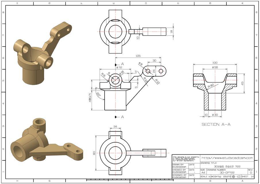

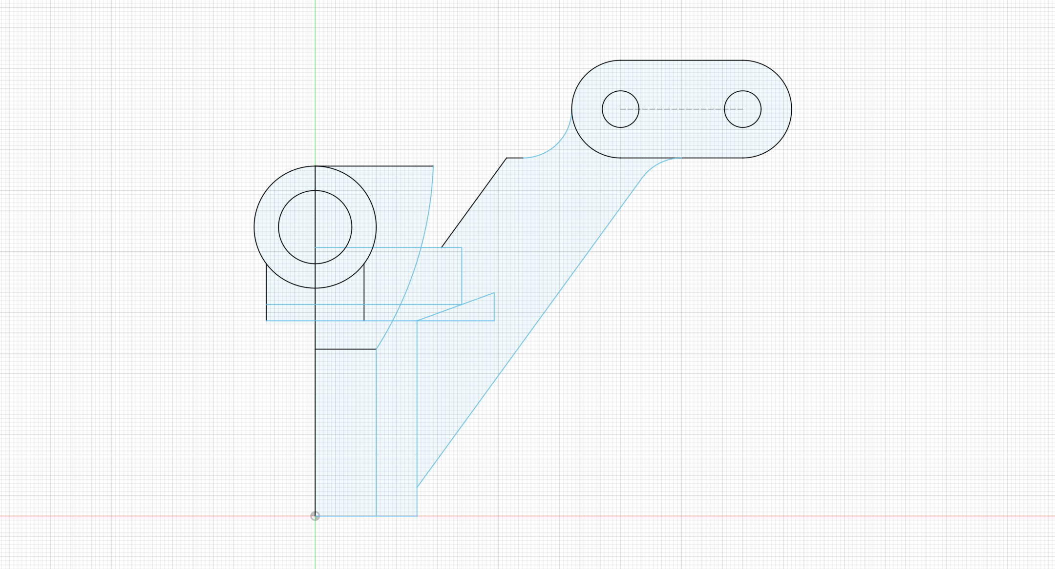

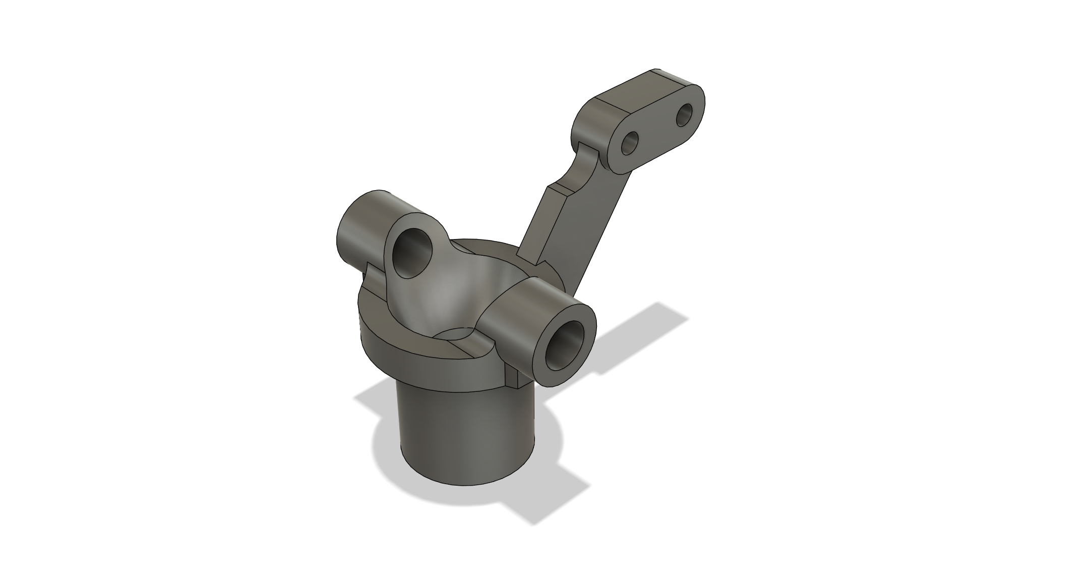

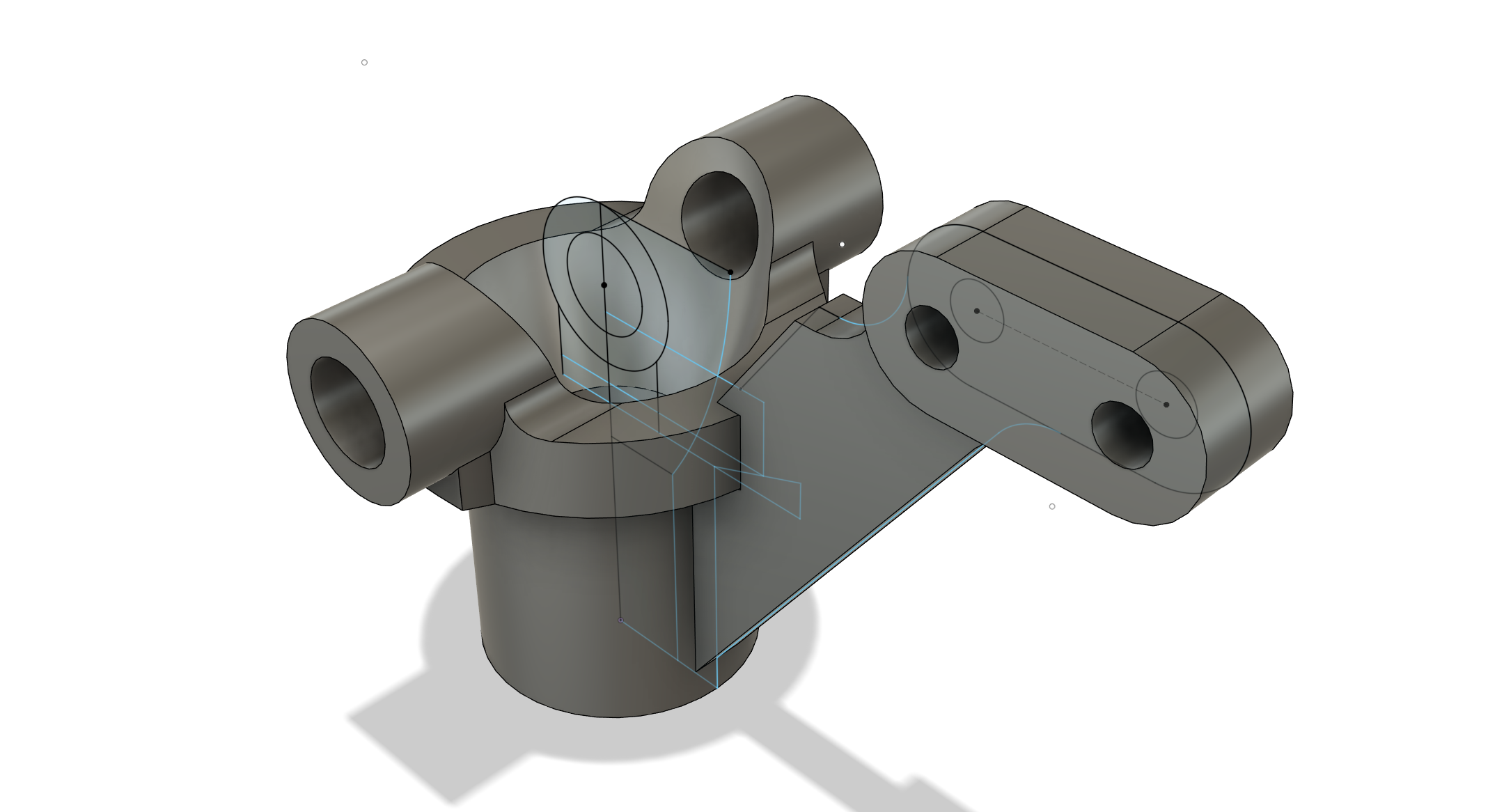

someone help me with this pitrofitch . 23 May, 2025 08:53 PM i dont know how to do it please help out WhatsApp Image 2025-05-23 at 17.25.46_d67f295f.jpg 3 Answers wang alex Answered on 24 May, 2025 02:20 PM Fyi- pip.STEP Jack K Answered on 24 May, 2025 11:54 AM Use the Part Design workbench 1. make a shaft of the center hub 2. add Pad for the arm 3. add Pad for the circular bearings 4. remove the hole with a groove easy Carlos J. Veloso Answered on 24 May, 2025 02:51 PM With a single sketch drawing you should be able to accomplish the model. 30-OP722 ISO.png 30-OP722 ISO-Sketch.png 30-OP722 Sketch.png
