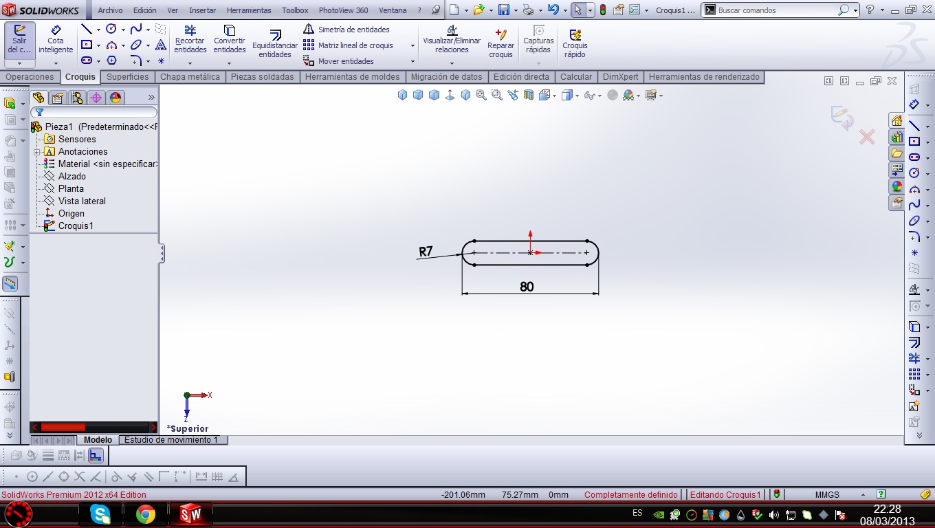

Taking the key way measurement in SolidWorks draw

Hold the shift key while you select roughly the mid point of each radius and it will give you the dimension you are looking for (80mm). As you have probably already found out, selecting the radius without holding the shift key will give you the dimension between the centres of the radius.

It looks like you want the center to center distance, say for an endmill, correct?

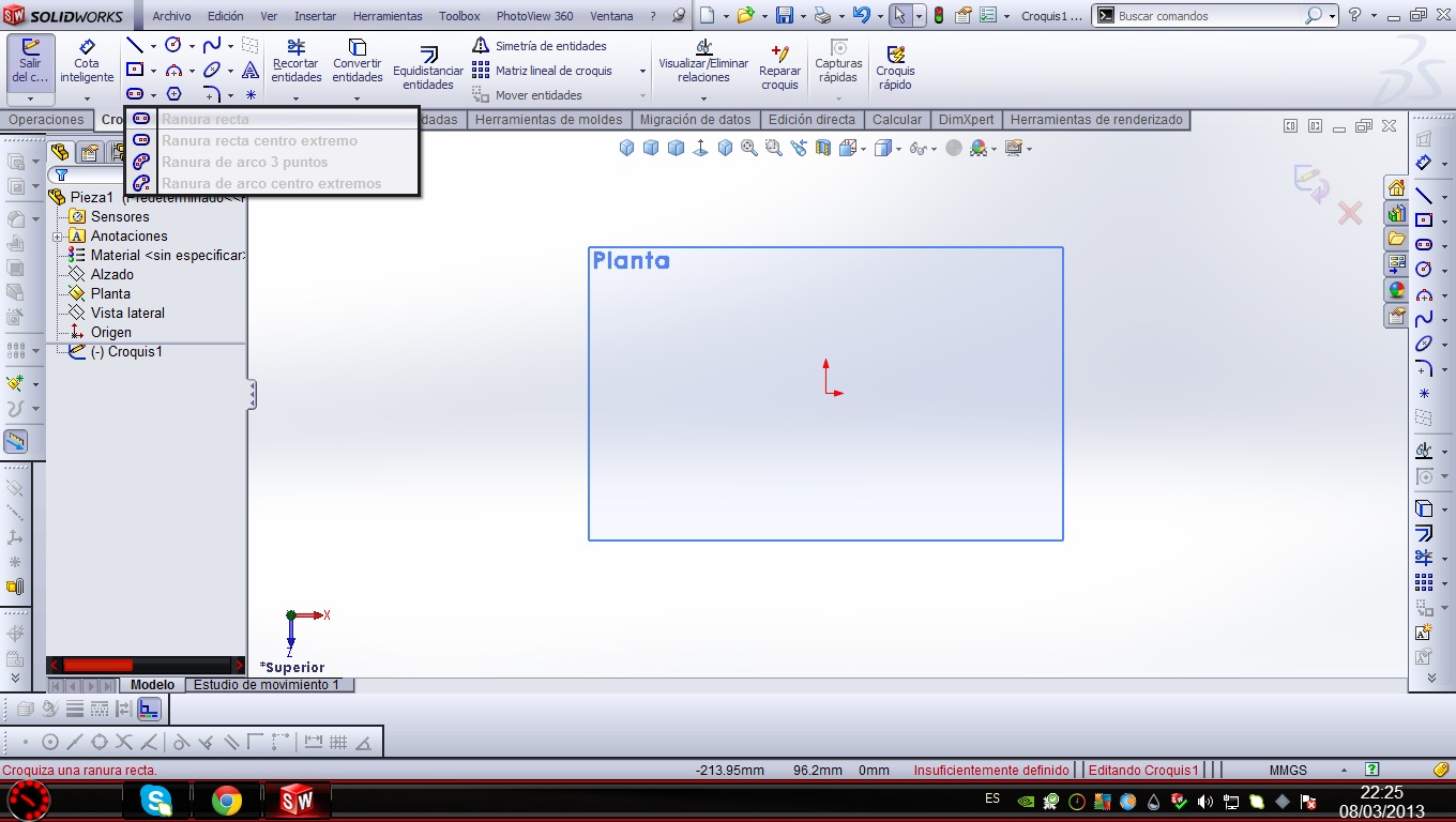

In any case, the total slot dimension is 80, the radii are 7. There are 2 radii, one on each end, so 80-(2*7), or 80-14=66. If you draw this in Solidworks using a straight slot, the center line is this dimension.
