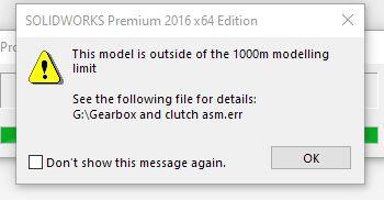

I recently Download a STEP file of a model and I am trying to open it in SOLIDWORKS. I did extract it properly and had worked with STEP files before But still this time it's not working.
It is showing the following Error
" The model is outside the 1000m modelling limit " ( refers to the attached picture for more clarity )
please suggest me a permanent solution to this :)
Accepted answer
As the error says, the file is beyond SW's limit.
You'll need to scale the file down before importing it.
