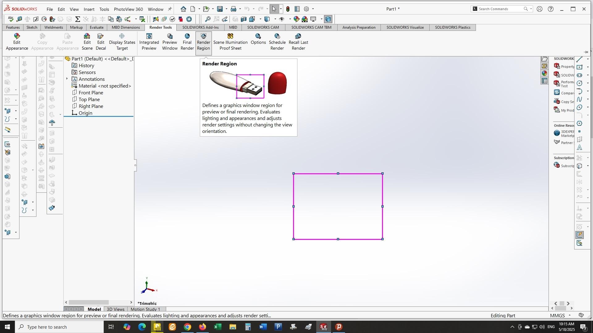

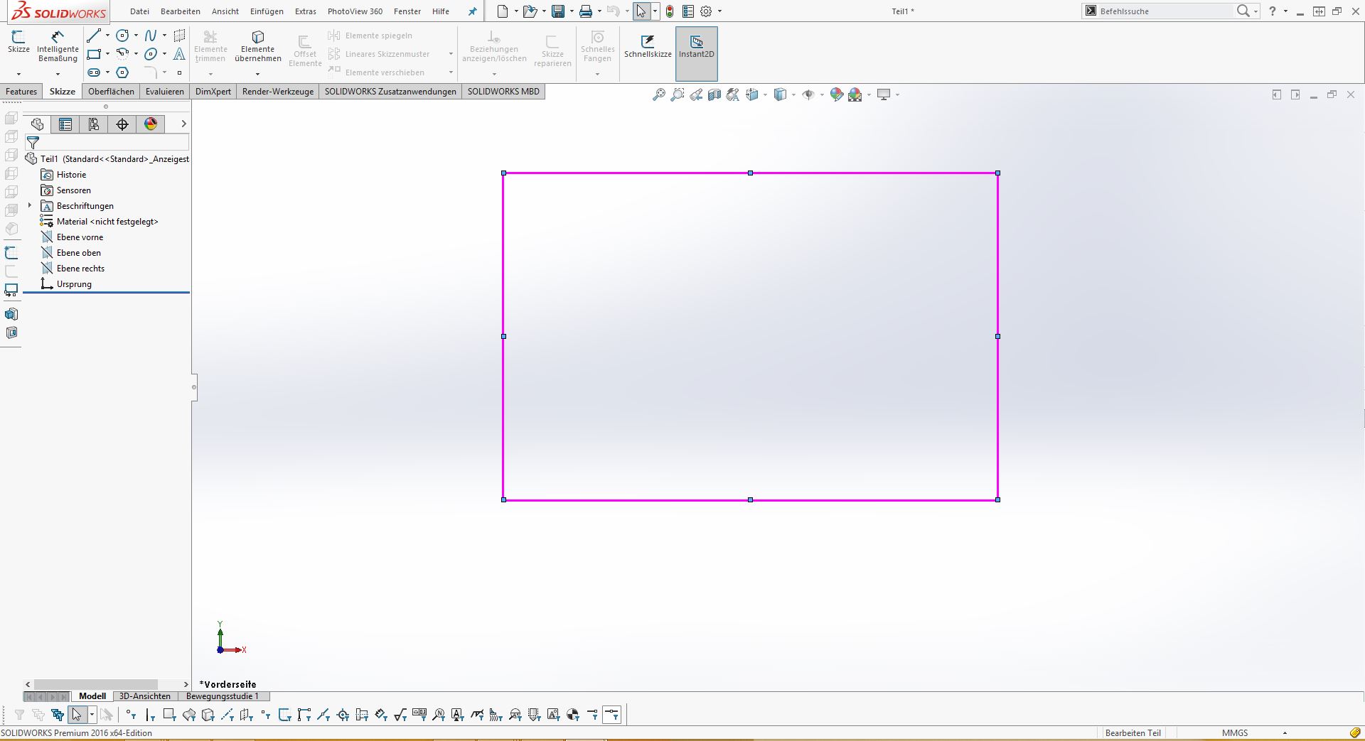

What is this and how do I turn this off in Solidworks 2016? SolidTweaks 25 Aug, 2016 01:11 PM I accidentaly pressed some key or imported some image I guess. This box has not gone since then. Does anyone know what this is and how to disable this? 1.JPG Accepted answer Stephen Nyberg Answered on 27 Aug, 2016 07:08 PM I think that may be a render area, check the PV360 tab. 2 Other answers Kawsar Ahmed Khan Answered on 24 Feb, 2023 09:33 AM photoview360 & click on render area. Mahdi Beigi Answered on 18 May, 2025 07:06 AM Render tools Tap See Attach File Render Tools.jpg
