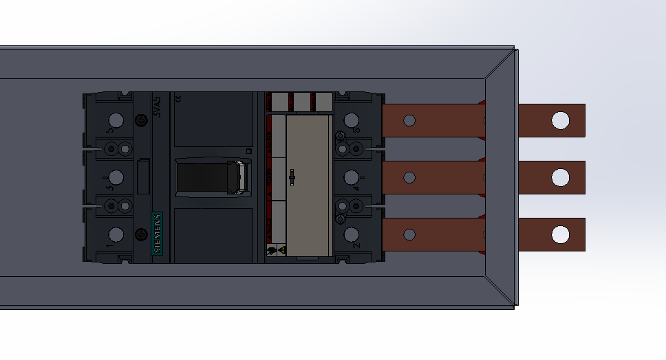

What's the best way to Isolate busbars in 4b form?
Will Isolation between busbar extensions using polycarbonate be effective for a 600A circuit breaker?
and what is the best way and material for Isolation? considering space between busbars and heat generated from busbars?
Also how can I support the extended busbars outside the compartment...is there some kind of a clip that does that?
