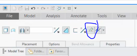

Where to find Normal To Surface in Creo 8.0?
Initially, I was working in creo 5.0 and it had Normal To Surface option in menu but when I checked in Creo 8.0, I was unable to locate that option. I have attached screenshot of creo 5.0 wherein the Normal To Surface option was available.
Dear Rohit.
In Creo 8 sheetmetal they have added another command called Extruded cut. Earlier in Creo 5 the Extrude option was used to add and remove material. In Creo 8 they have seperated it. In Creo 8 Sheet metal Extrude command adds material and Extrude cut removes material. The extrude material has all the options you require
