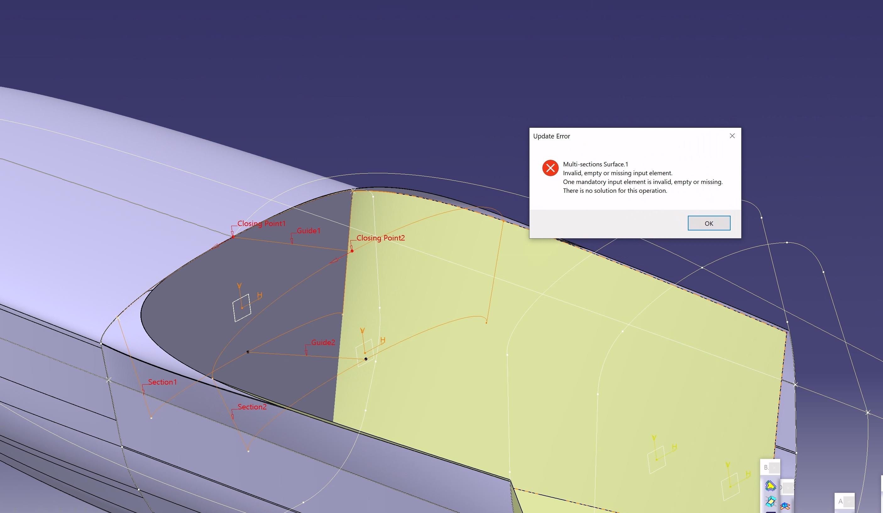

Hi again,
I'm trying to finish up the main parts of my cockpit and for some reason, I can't multi-surface my dashboard, I cant figure it out for the life of me.
Accepted answer
It was because I placed the guide above the skin when it should've been under

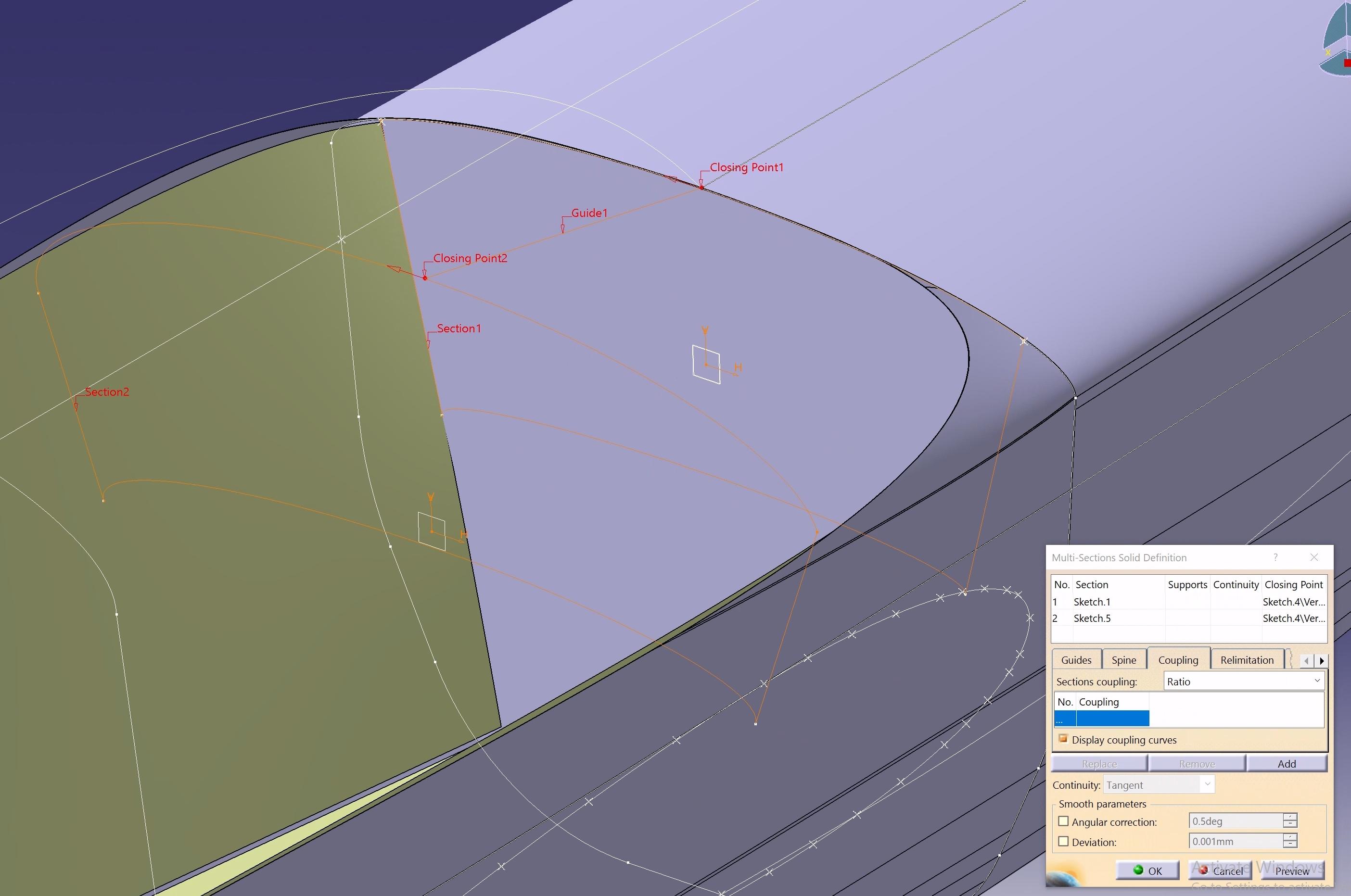

Everything looks OK in the attached image. Can you include a picture of the Multi-Section panel so we can see what the inputs and options are.
Taking a wild guess based on the error message: Check both sketches to verify they have closed profiles with no extra points.
