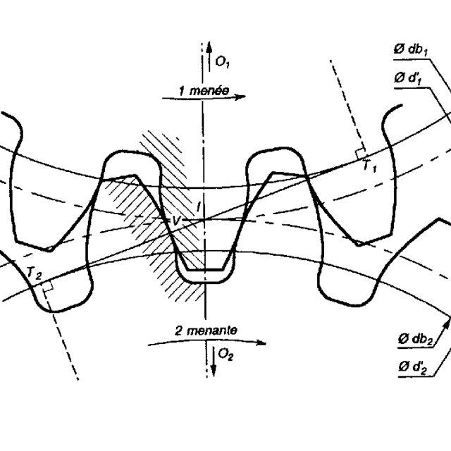

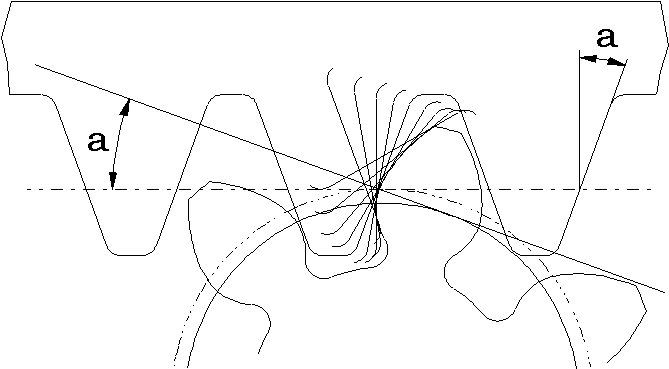

Hello Mohamed!
Wheels can be made with few teeth (6, 5, etc) but they generate an undercut effect at the root of the tooth that weakens it. I am attaching two figures, one with normal toothing, in which the number of teeth generate strong profiles (with a wide base) and another figure in which you can see how a wheel with fewer teeth works, which requires reducing the thickness. from the base of the profile.
On the other hand, the reason an odd number of teeth is requested (11 or 17 in your case) is to get each tooth on the small gear to work "against every single" tooth on the other gear. When the amount is even, there is a situation where each tooth of the small wheel always meets the same teeth of the big wheel, and this can lead to uneven wear.
I hope the comment will help you.
Best regards!

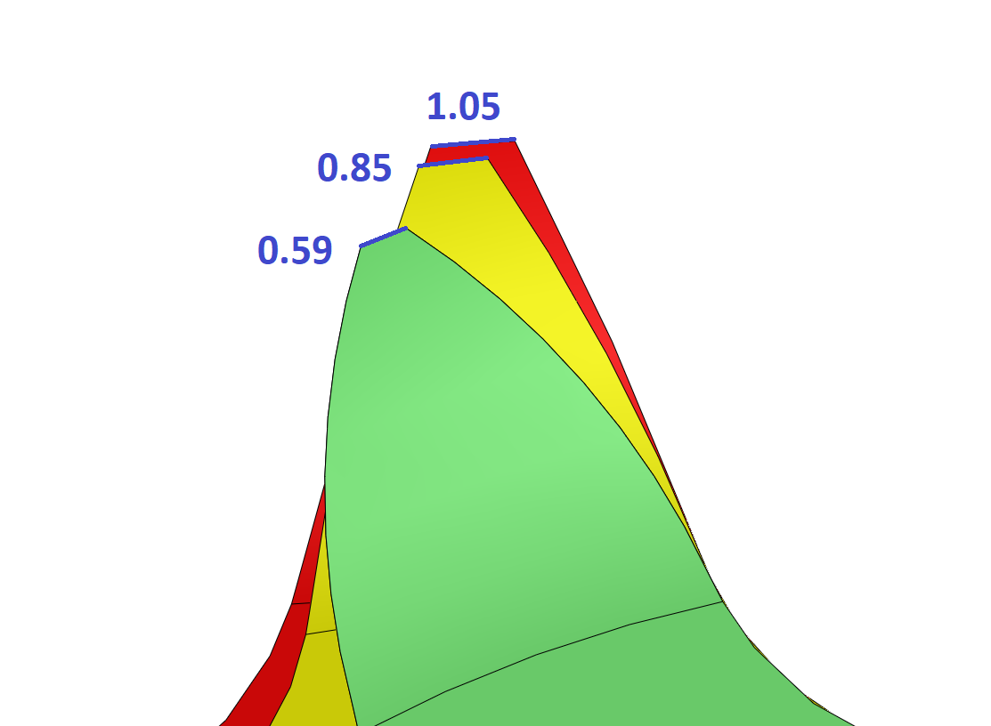

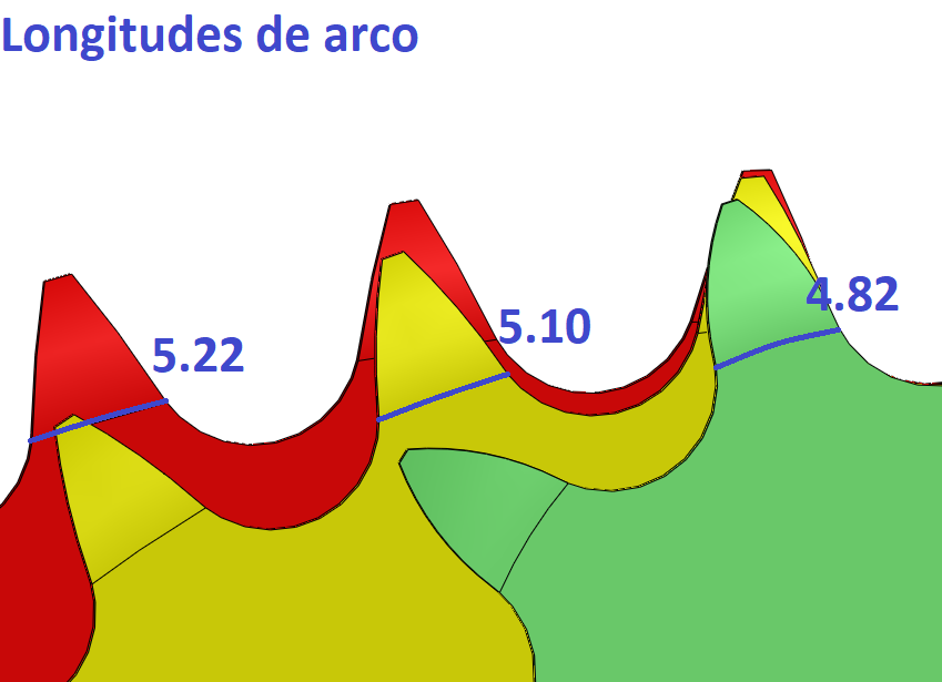

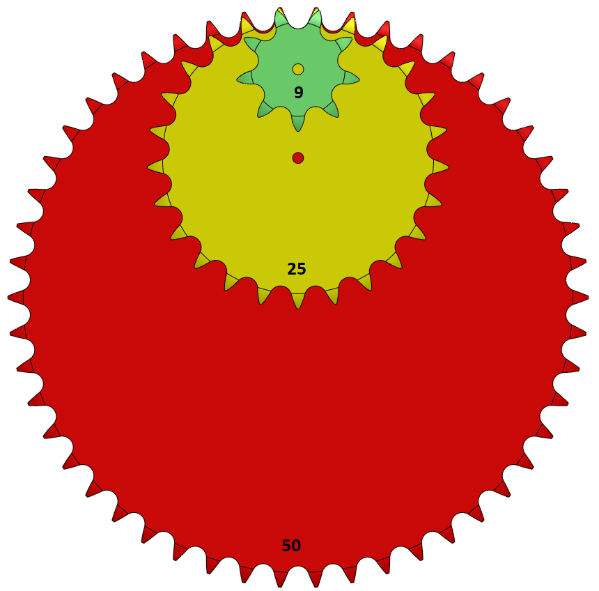

To add something visual to Bob's comments, I'm posting some pictures (from the SolidWorks toolbox) comparing a 9 tooth sprocket to a 25 tooth sprocket and a 50 tooth sprocket.
You can observe the geometric issues that lead to the weakening of the tooth when the amount is less and less...
Without intending to enter into a sterile discussion, the reasons why there is weakening of teeth (in the root when they are gears that mesh, and in the head when they are chain wheels) are quite similar: they are due to the kinematics of the gear (tooth -tooth in one case... and chain tooth in the other).
Of course there are also "technological/constructive issues" like the heat treatment ones cited by Bob, but I think the deeper reasons are purely kinematic... and lead to a reduction in resistant sections which makes the loads/transmissible torques less. when the number of teeth on any sprocket becomes smaller. It's a good exercise to draw a 4-tooth wheel (either involute or chain... and exaggerately observe this effect).
Best regards!
