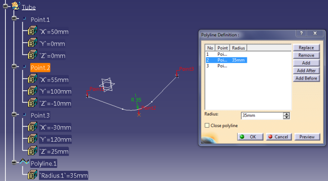

    2. In the Tube GeoSet define 3 points at any reasonable coordinates. Using these three points create a polyline and assign a radius - Fig.1.

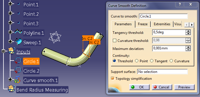

    5. Isolate the two extracted edges. Now the Inputs GeoSet should contain two isolated circles. The problem is that sometimes CATIA may not recognize these edges as circles on imported geometry, therefore it is better to use any curve as an imput. To turn the two circle into curves use Curve Smooth command (Insert>Operations) - Fig.3. Isolate both curves and delete the circles, now the Inputs should contain two isolated curves.

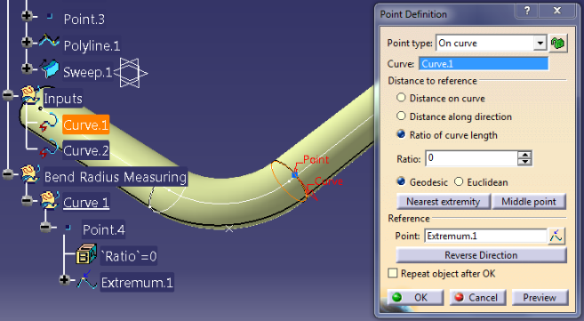

    6. Now go to the Bend Radius Measuring and create a new GeoSet in it, name it Curve 1. Using one of the input, create a point on curve, see more details on Fig.4.

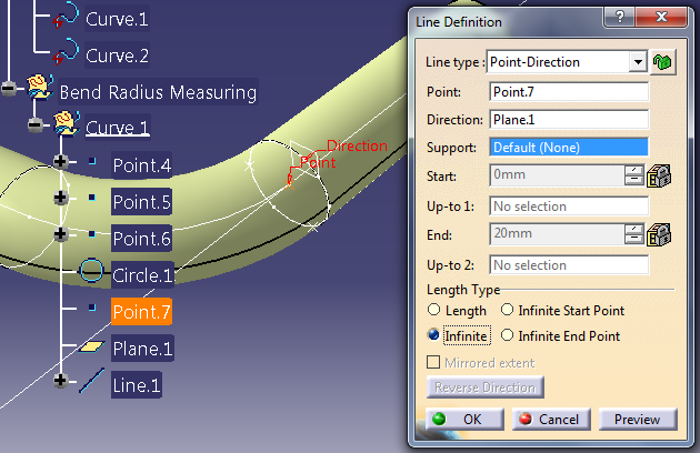

    9. Use this plane and the center point of the circle to create a new line - Fig.6.

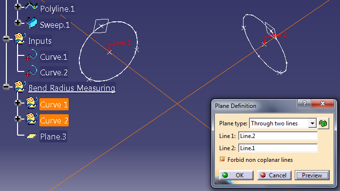

    11. Using the two lines create a plane - Fig.8.

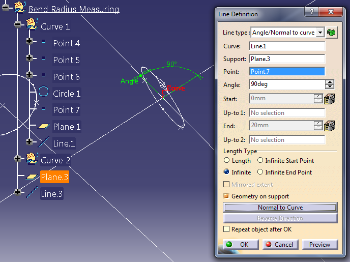

    12. Use this plane, center point and line from Curve 1 GeoSet to create another line - Fig.9. It has to be normal to the line form Curve 1 GeoSet. Create a line in the same way for the second curve.

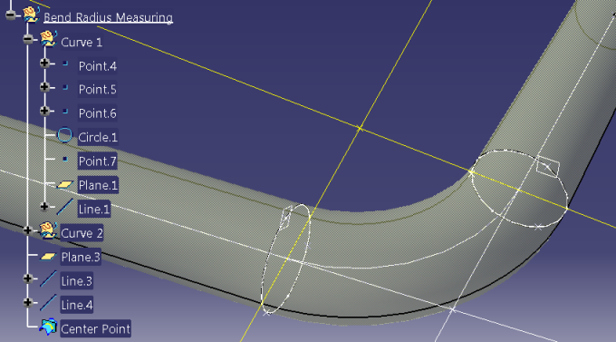

    13. Intersection of these two lines is the center point of the bend radius (yellow). Name this point - Center Point - Fig.10.

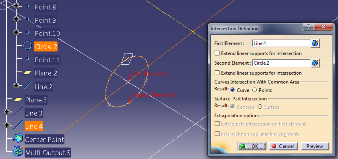

    14. Create another intersection, like it is shown on Fig.11. Result of this intersection is a multiple result, it means it has more than one solution. In Multi-Result Management window select option - keep only one sub-element using a Near. As a reference element use the Center Point.

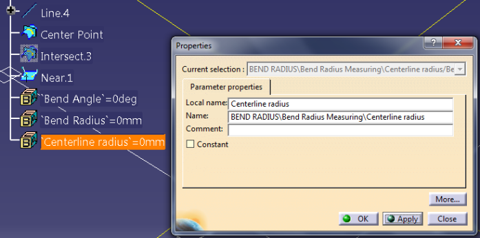

    16. Edit their properties and change their local names - Fig.13.

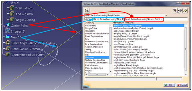

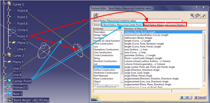

    18. Formula of the Bend Radius parameter is shown of Fig.15.
  16. Step 16:
    19. Smilar formula has to be created for the last parameter, use the Center Point and one of the center points of the input curves - Fig.16.

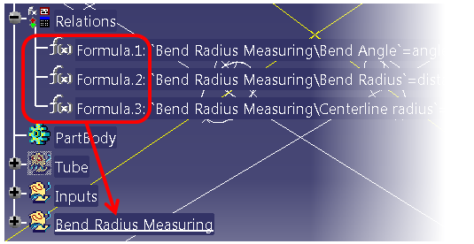

    20. New formulas have been created, drag&drop them to the Bend Radius Measuring Geo Set - Fig.17.

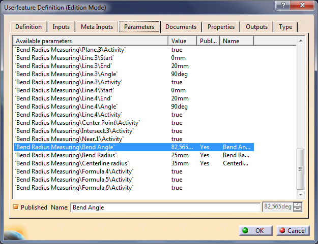

    23. Go to the Parameters Tab and the three parameters created in step number 15. Publish these parameters and modify their names - Fig.20.

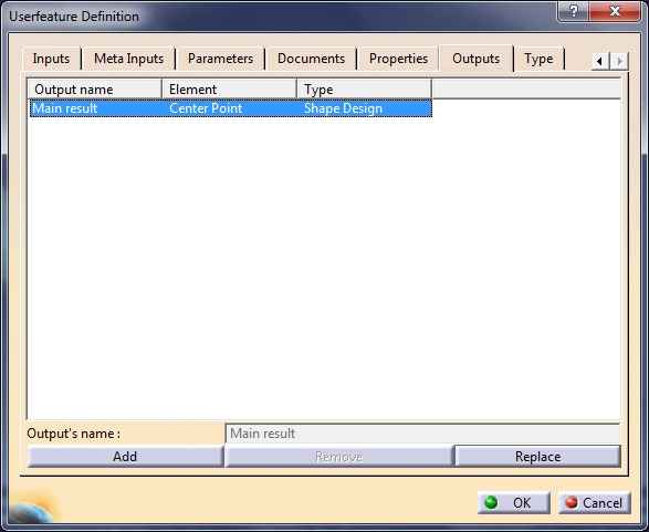

    24.Go to the tab Outputs and make sure that the main result is the Center Point, if it is not, replace the main result with it - Fig.21. You can also go to the Properties tab to change the icon of this UDF. Click OK.

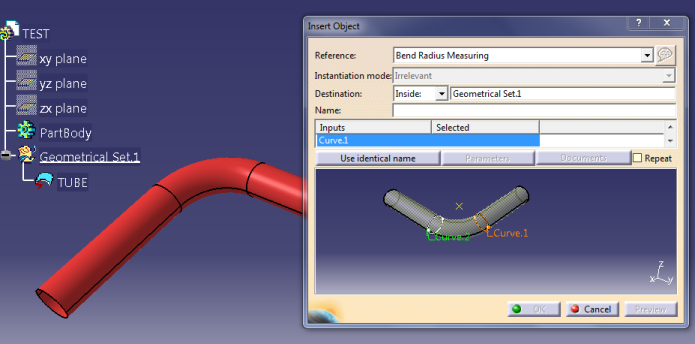

    26. To use the UDF create a new file and another tube in it. Go to Insert®Instantiate From Document and select the CATPart from previous point. In Insert Object window choose a destination and as an input select two curves - Fig.22.
  23. Step 23:
    27. The bend has been measured and the parameters have been created - Fig.23.
