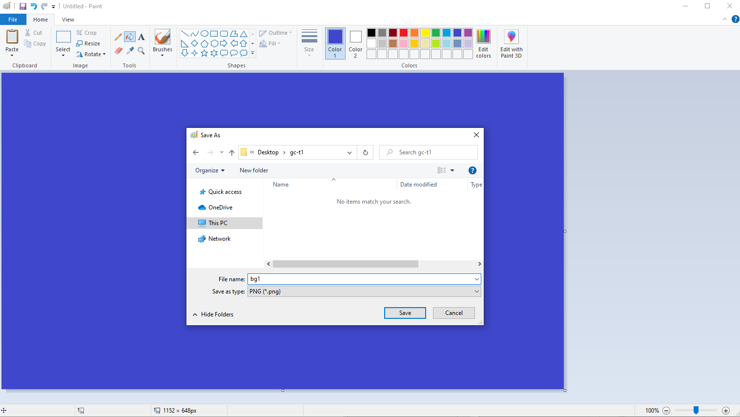

Step 1: Create a blue image by paint
Open windows paint and create a blue image.
then save it as any name.

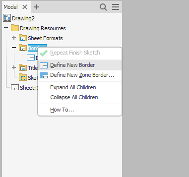

on Borders select "Define New Border" or "Define New Zone Border" and customize your border zone. no exit.

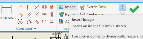

On top Ribbon find "Image".
and select your blue image that created in STEP1.

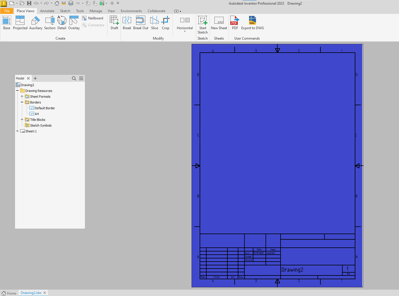

and resize by zone borders.
in the end exit sketch.
new. we have this image:

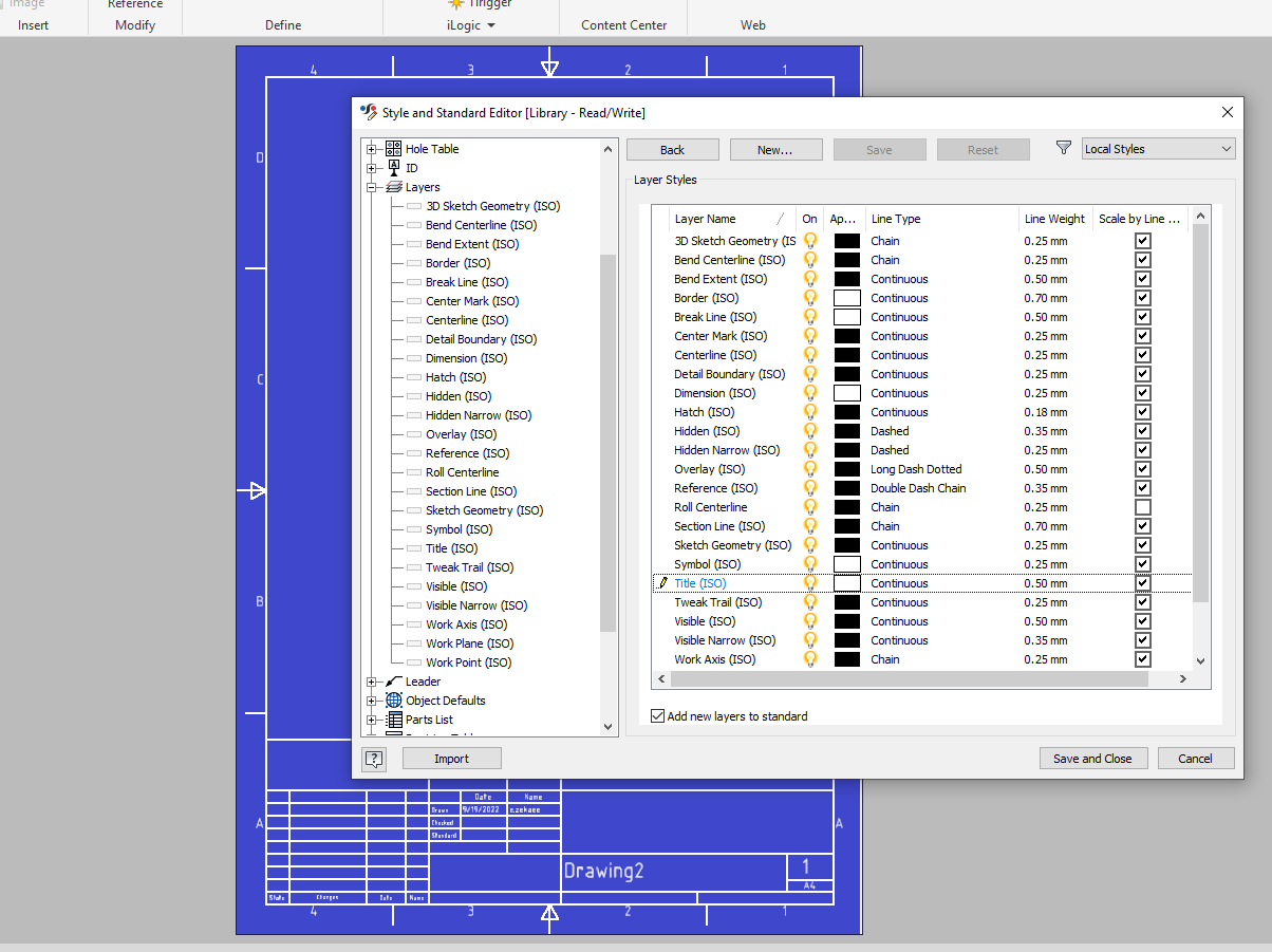

Step 4: Setting Layers
Change Layers colors for any objects.
Like borders, dimensions, visible,...
"Visible" is important.

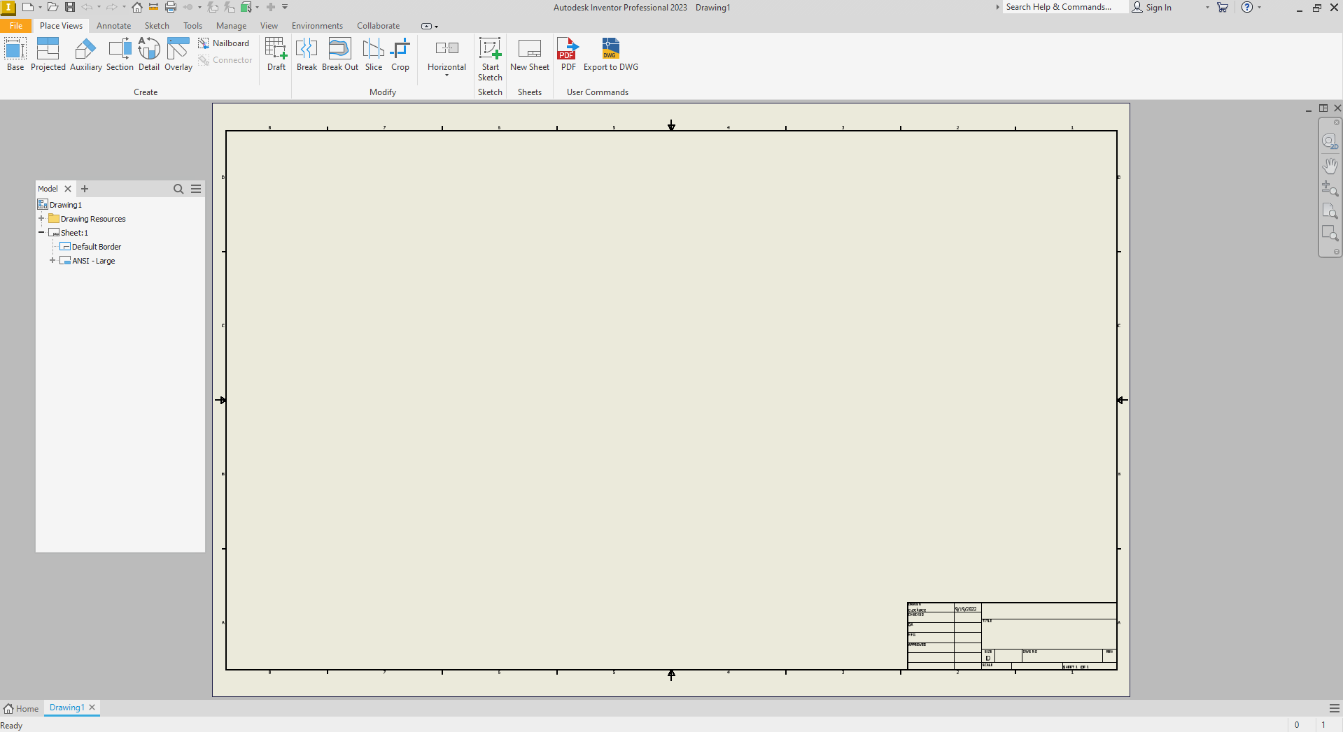

Step 5: Create drawing view.
Now it is ready to draw anything or insert a model view.
