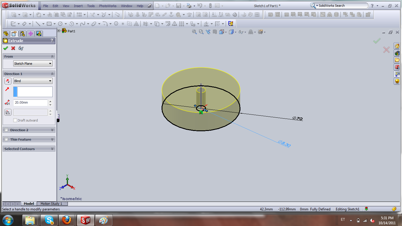

Step 1:
Create an extrude

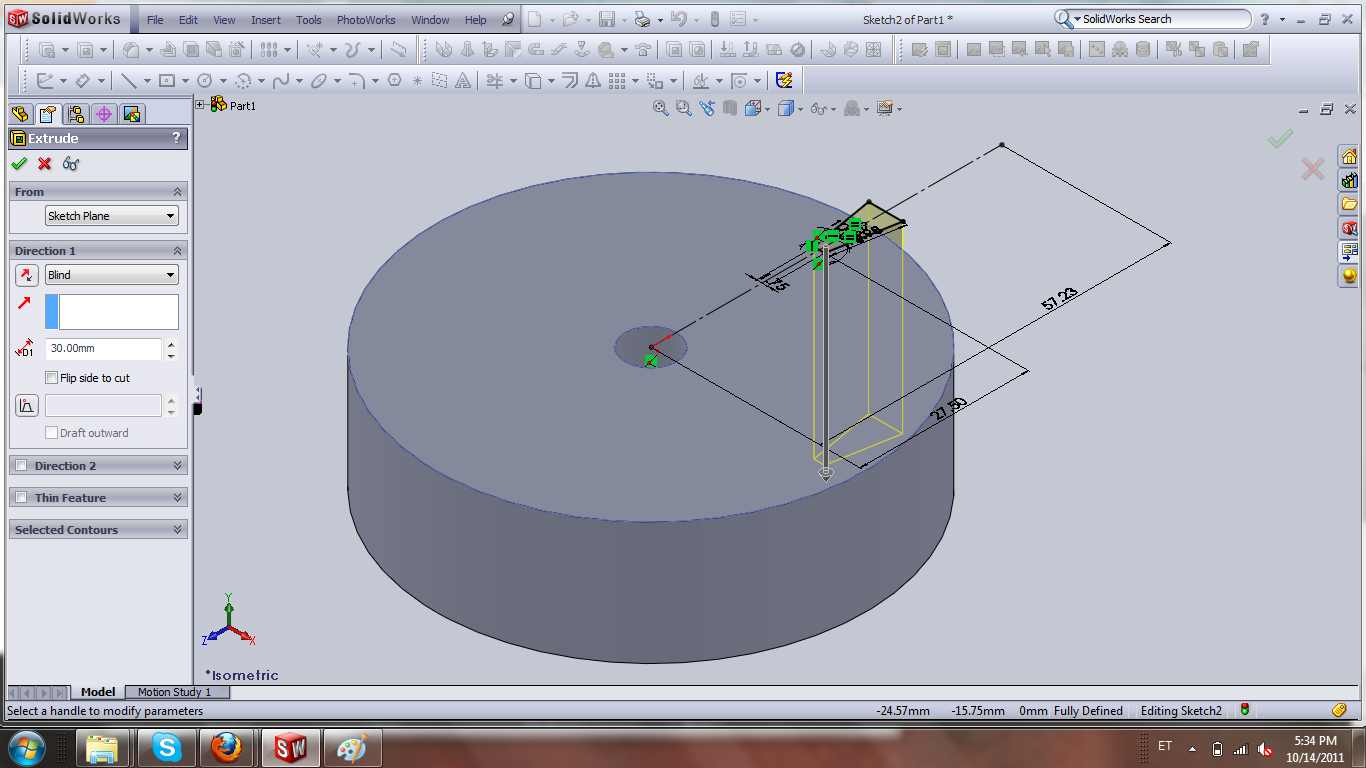

Step 2:
Create a cut for the toofs(random values entered)

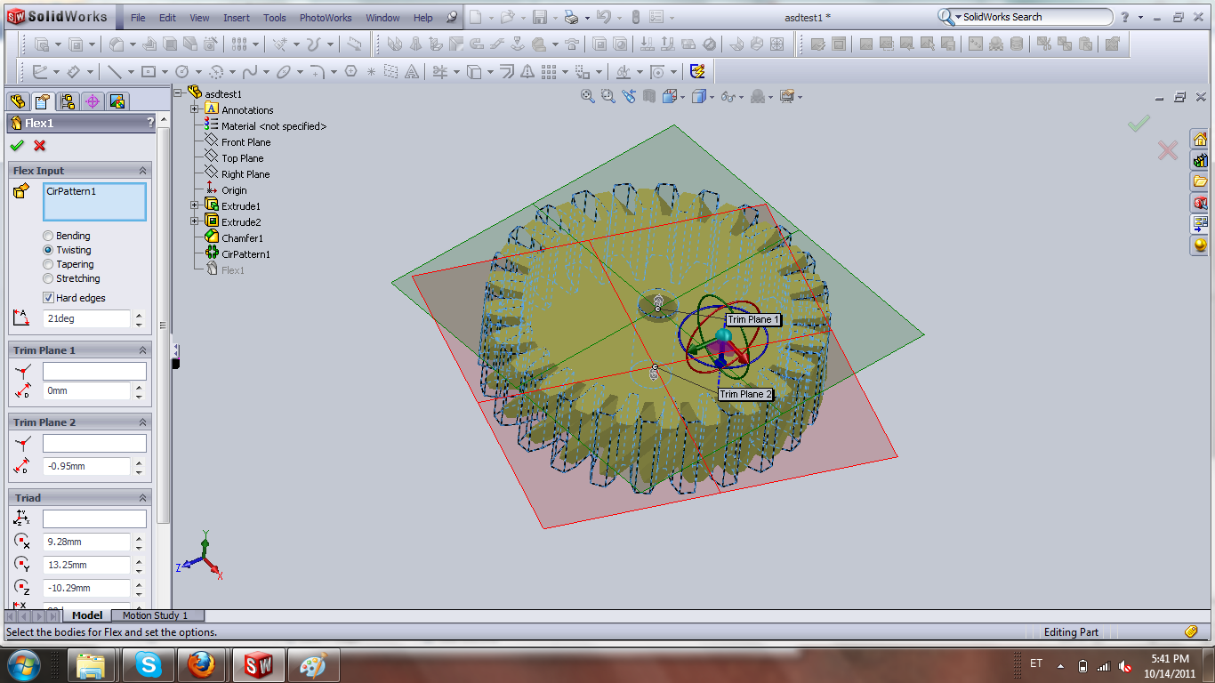

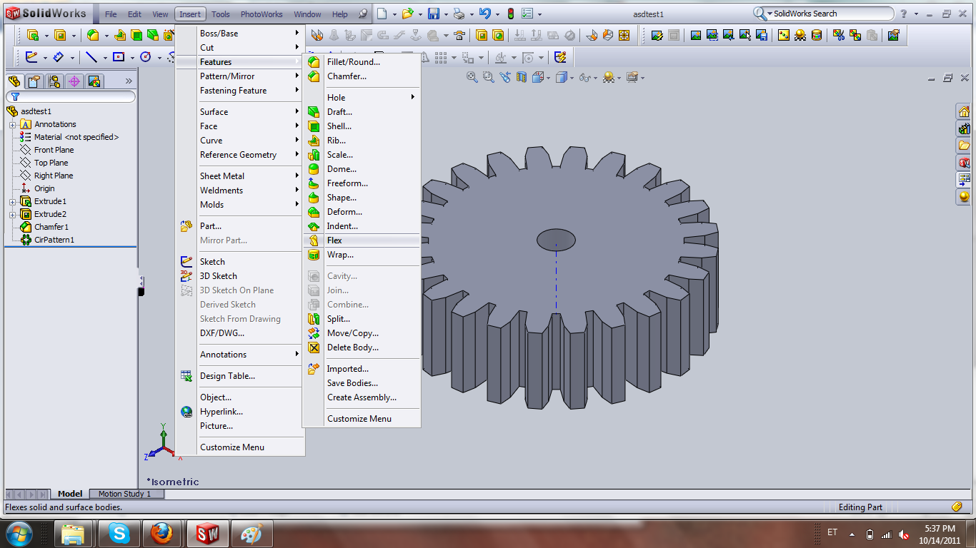

From the insert tab select features and then flex feature

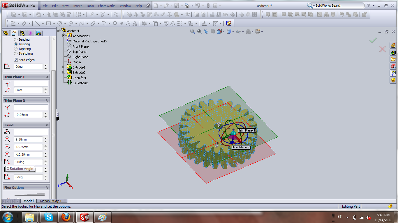

Step 5:
Make sure to change the planes (i used x-plane), to 90 degrees
Step 6:
Change the twist value from the top to the desired value

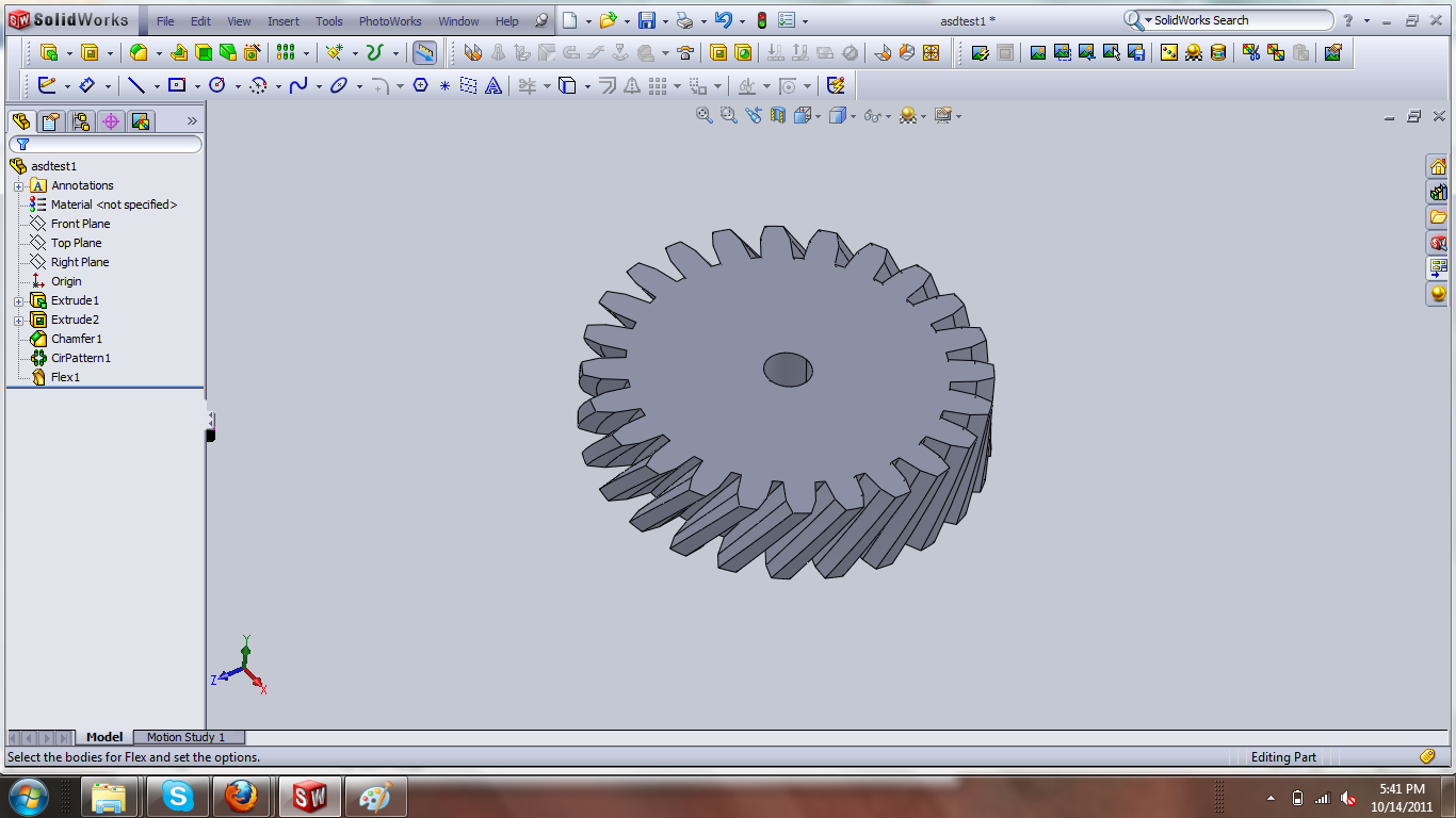

Step 7:
Enjoy your newest creation and a new trick you just learned :)
