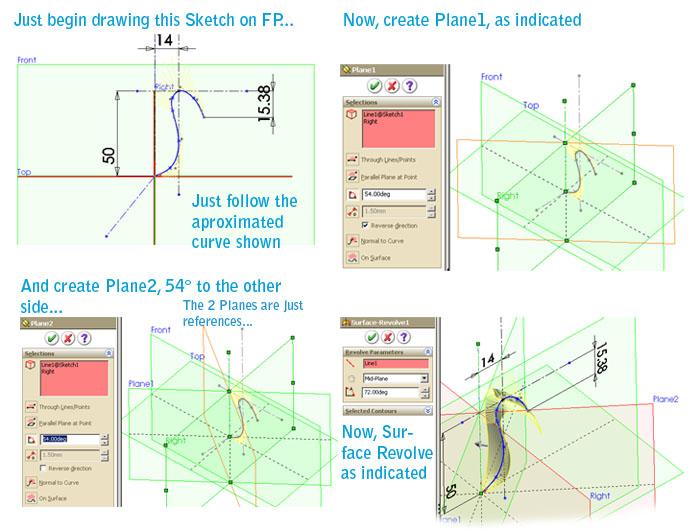

  1. Step 1: First Sketches, Planes & Surfaces
    Well, here we go!
    Remember that: FP means Front Plane, PM for Property Manager, FMDT means Feature Manager Desing Tree, SK for Sketches, and so on....
    Have fun!

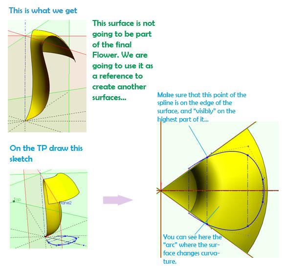

    First we are going to need an Auxiliary Surface...
  2. Step 2: Cutting Auxiliary Surface
    Also we are going to pattern...

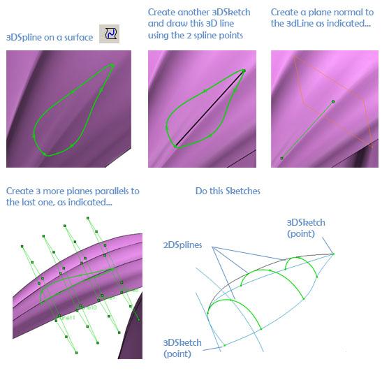

  3. Step 3: Sketching the Petals Wrinkles
    The spline contour does not have to be "exact", is a free form, but don't overdo as it may have unexpected results.

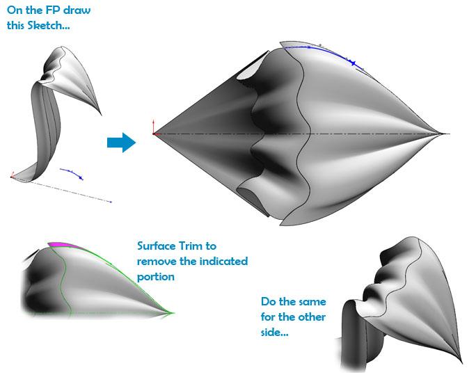

  4. Step 4: New Partial Petal
  5. Step 5: Completing Petal

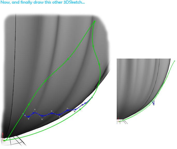

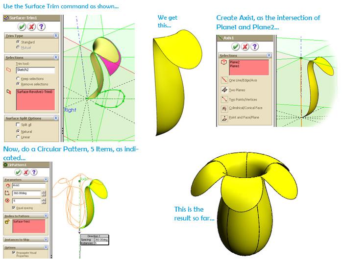

  6. Step 6: Cutting out the side of petal
  7. Step 7: Refining the Petal
  8. Step 8: Creating the final Pattern

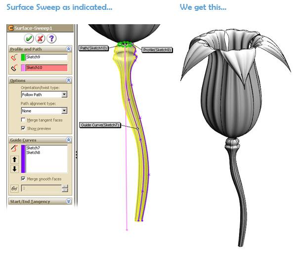

  9. Step 9: Modeling the Stem

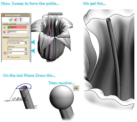

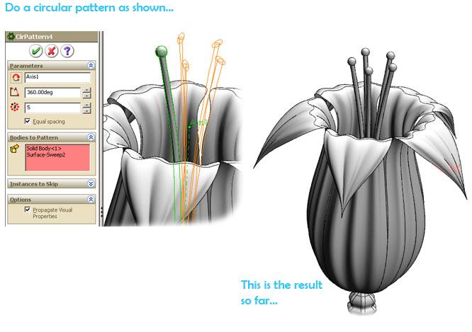

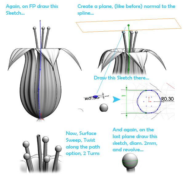

  10. Step 10: Modeling the Pistils
    But first extend the last surface.
  11. Step 11: Center Pistil. Another one

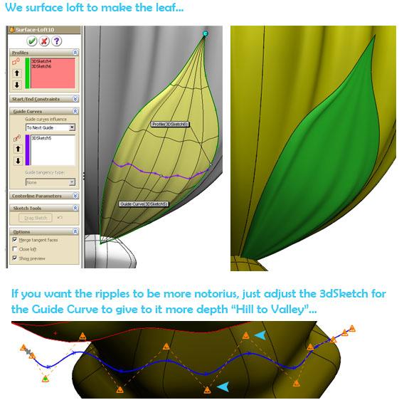

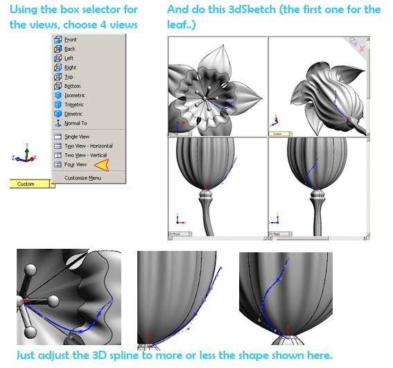

  12. Step 12: Modeling the Leaves
    For the next step we need to use four views...
    Remember that these are free form Splines. Do not overdo.

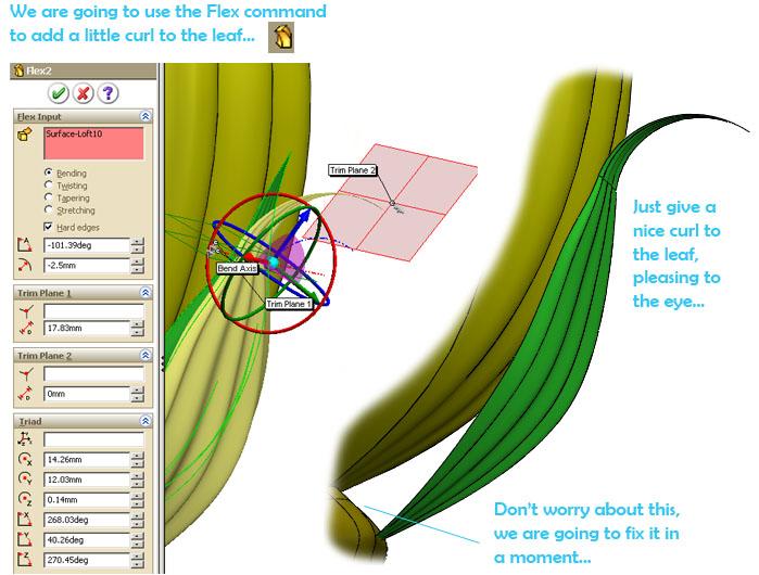

  13. Step 13: Flexing the Tip of the Leaf
  14. Step 14: Moving (Adjusting) the Leaf

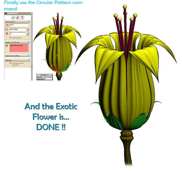

  15. Step 15: FLower Done?
    Well, not so!...

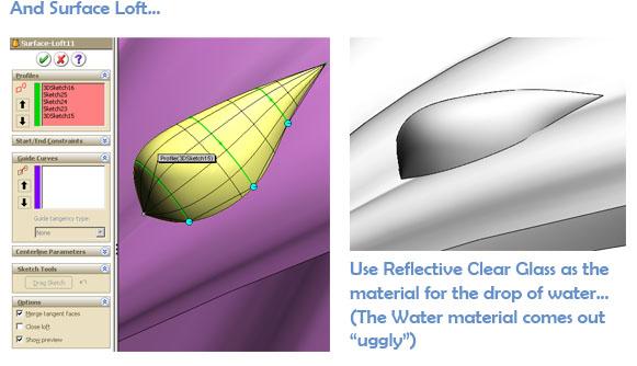

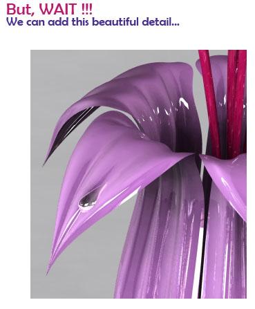

  16. Step 16: Adding a Water Drop
  17. Step 17: Final Step
    Just render to your liking!
