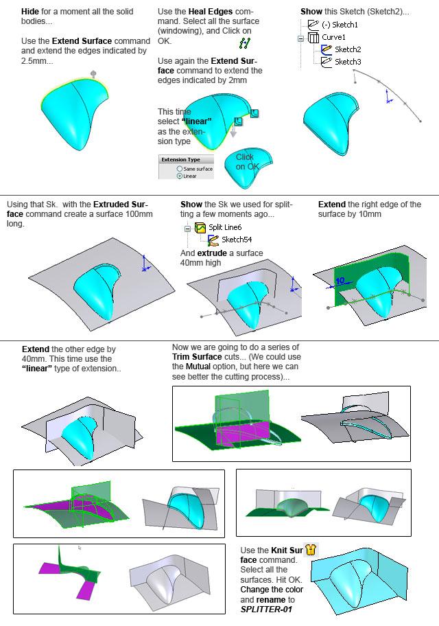

  13. Step 13: At last!.. First Surface...
  14. Step 14:
  15. Step 15: Loft vs Boundary Surface...
  16. Step 16: More work!!...
  17. Step 17: The other Surface...
  18. Step 18: Trimming to Improve Quality...
  19. Step 19:

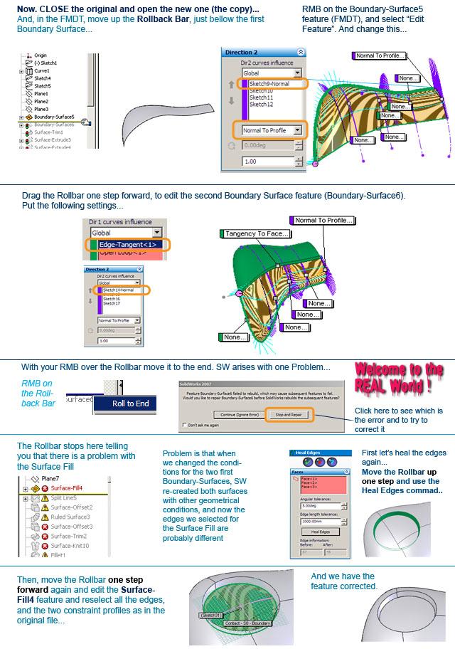

  87. Step 87: Oh Oh... Welcome to the Real World!
  88. Step 88: No a good Transition...How To.
  89. Step 89: Warning... But do not worry.
  90. Step 90: Some other tweaks...
  91. Step 91: Nice Results!!...Advises...
