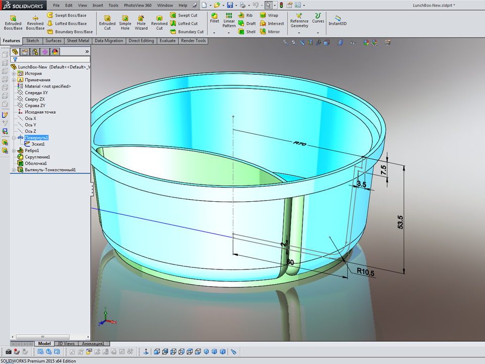

Step 2:
Make sketch with 'Offset Entities' (because you will add 'Shell', so why not make it in 1st sketch) and 'Revolve' it.

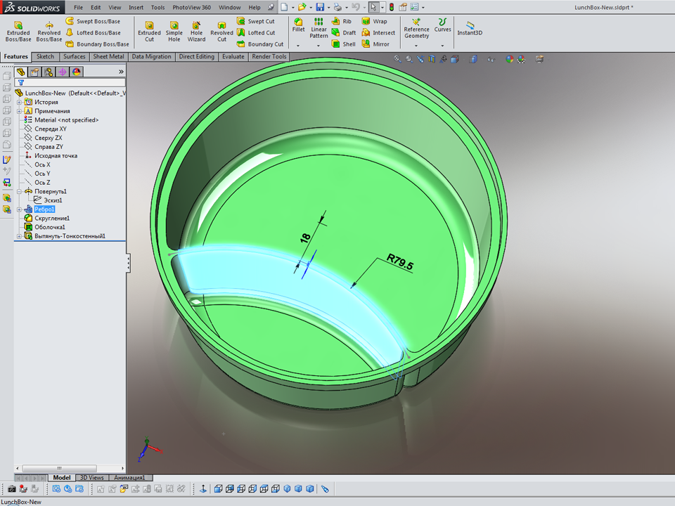

Step 3:
Next time you may not use 'Loft' because we have better command named 'Rib'

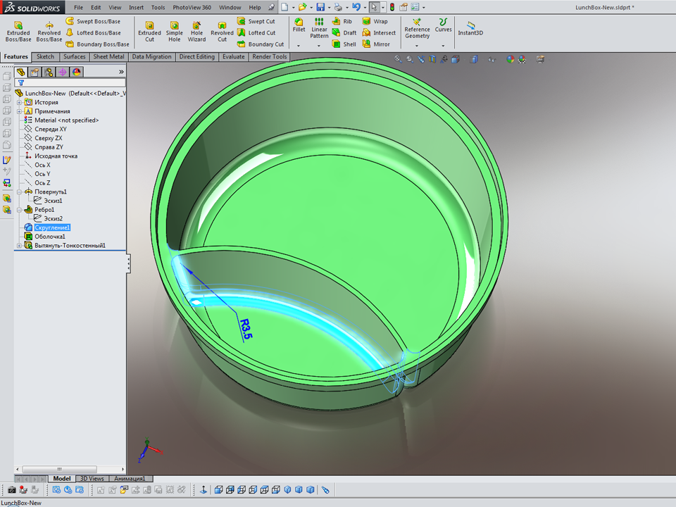

Step 5:
'Shell' as it was before..

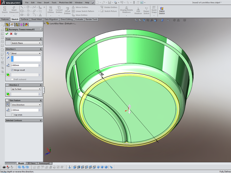

Step 6:
And the last step 'Extrude-Thin', but now I didn't make new Plane, just extruded it in 2 ways from the bottom surface of box.
