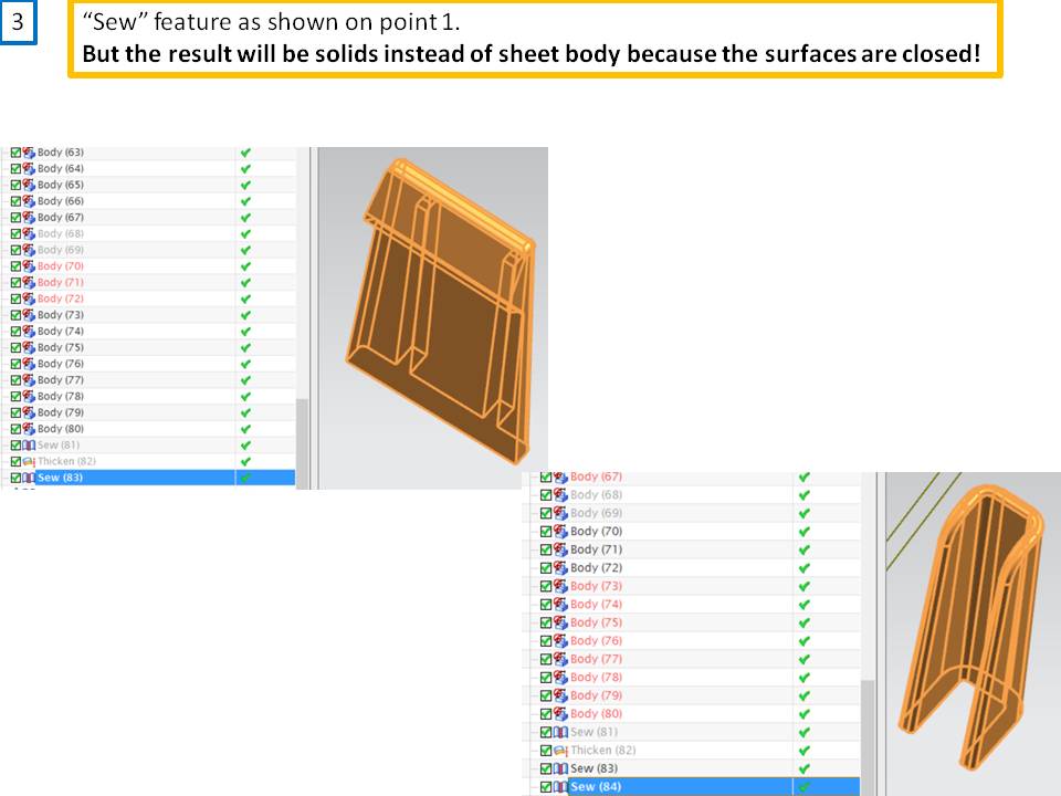

Step 1:
1. First Sew 1/2
Step 2:
1. First Sew 2/2

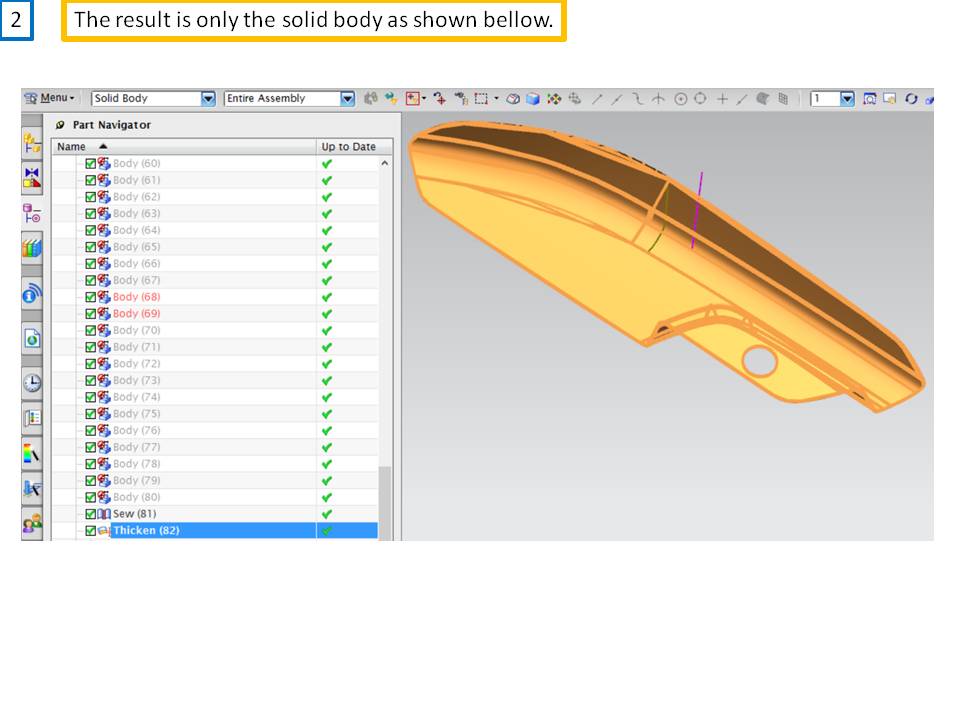

Step 3:
2. Thicken 1/3
Step 4:
2. Thicken 2/3
Step 5:
2. Thicken 3/3

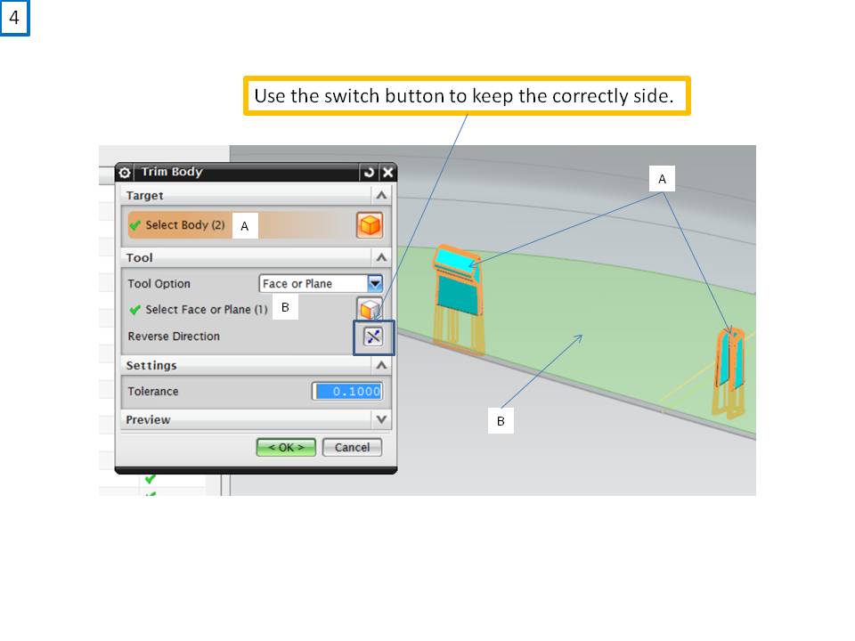

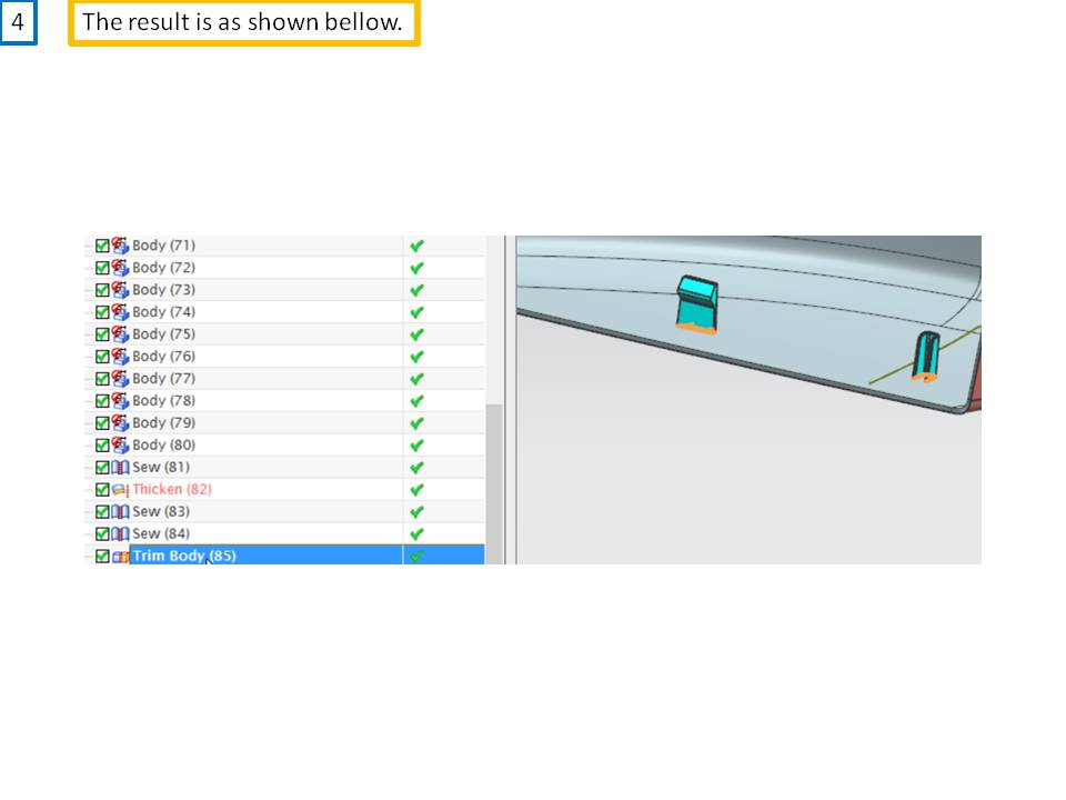

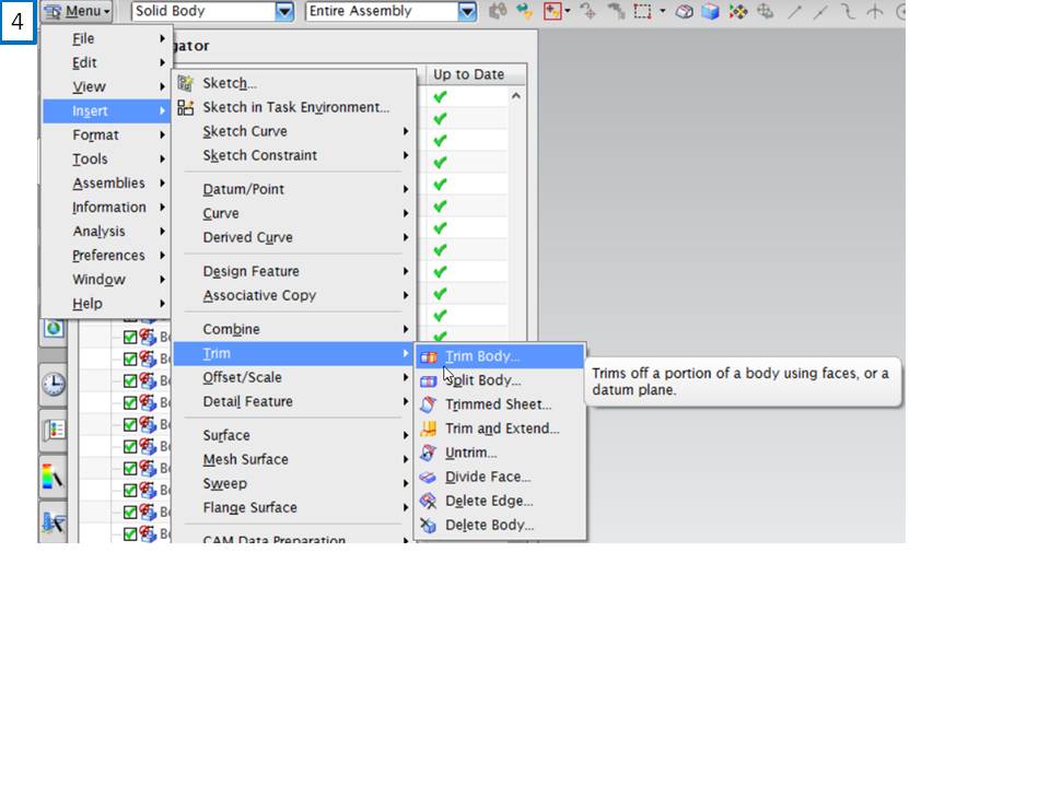

Step 7:
4. Trim Body 1/3
Step 8:
4. Trim Body 2/3
Step 9:
4. Trim Body 3/3

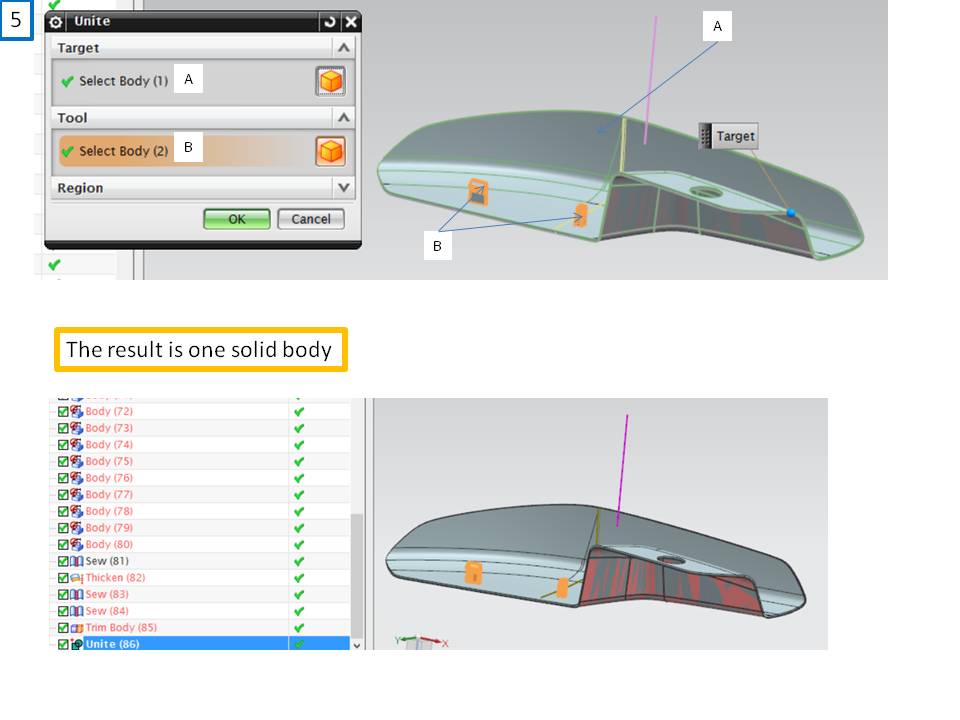

Step 10:
5. Unite 1/2
Step 11:
5. Unite 2/2

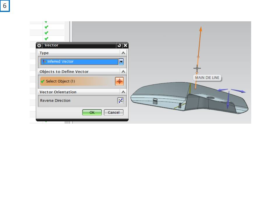

Step 12:
6. Slope Analysis 1/3
Step 13:
6. Slope Analysis 2/3
Step 14:
6. Slope Analysis 3/3
