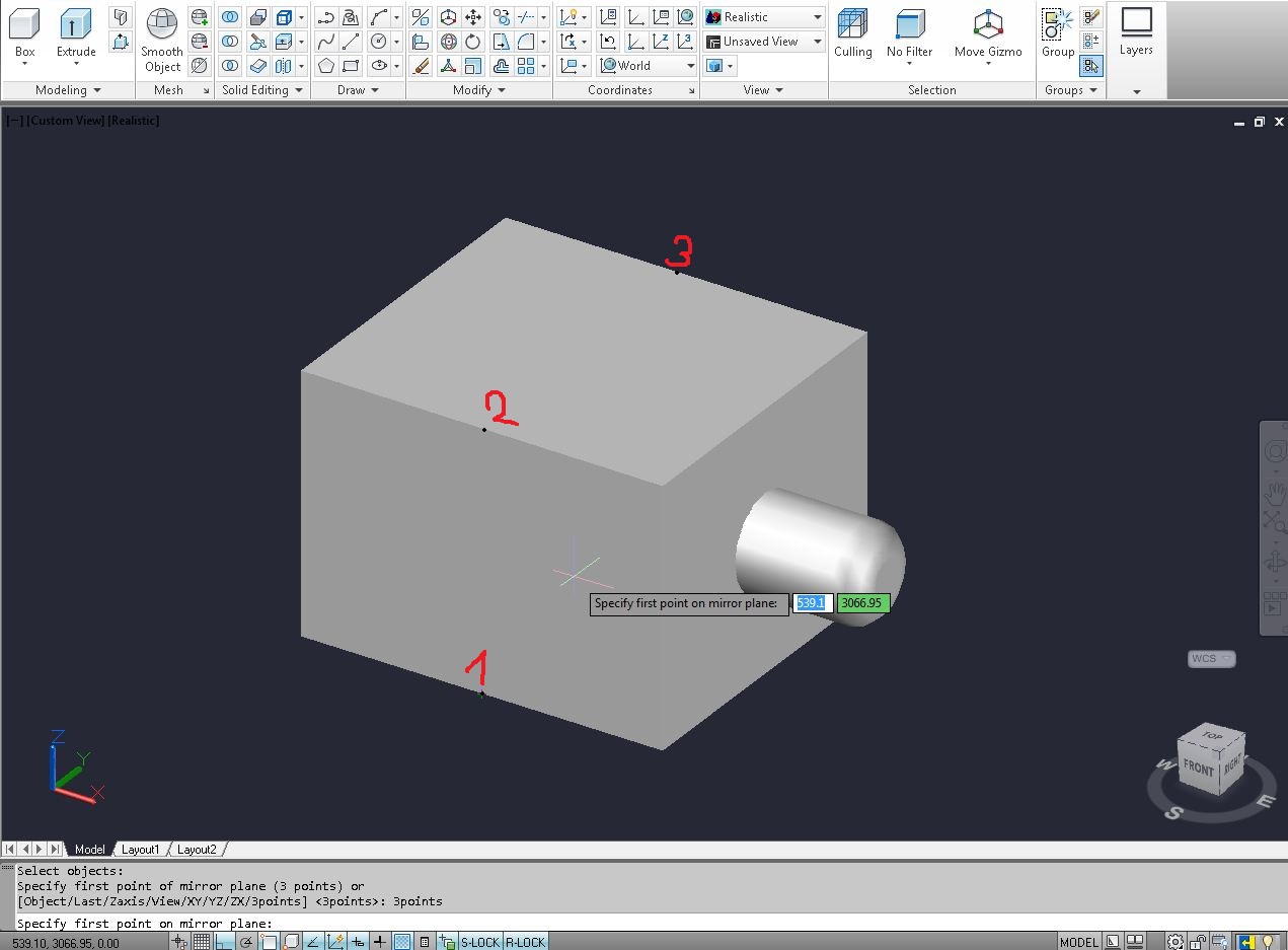

I have this simple model with a box on the picture and this shape at the right face.I am going to show you how to mirror it to the other side of the box.

Now I need to specify 3 points on mirror plane,if you press down-arrow key on keyboard you will get more options for mirror,now I am gonna show you 3 points.
Step 4:
Now these are the 3 points you need to select,why these you may ask?
Well,in AutoCAD there are no actual planes like in other software which can be used for mirror so in AutoCAD you need to select 3 middle points (with this option) to mirror your body.
Here it is,now lets go to another option.
