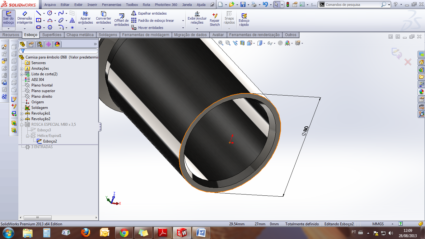

Step 1:
1 – Create a circular sketch matching the external diameter of a cylinder which you want to make a thread, in my case I needed to develop a special metric thread with a 80mm diameter, 3.5mm pitch and 15mm length, it also needed to have three entrances clockwise.
