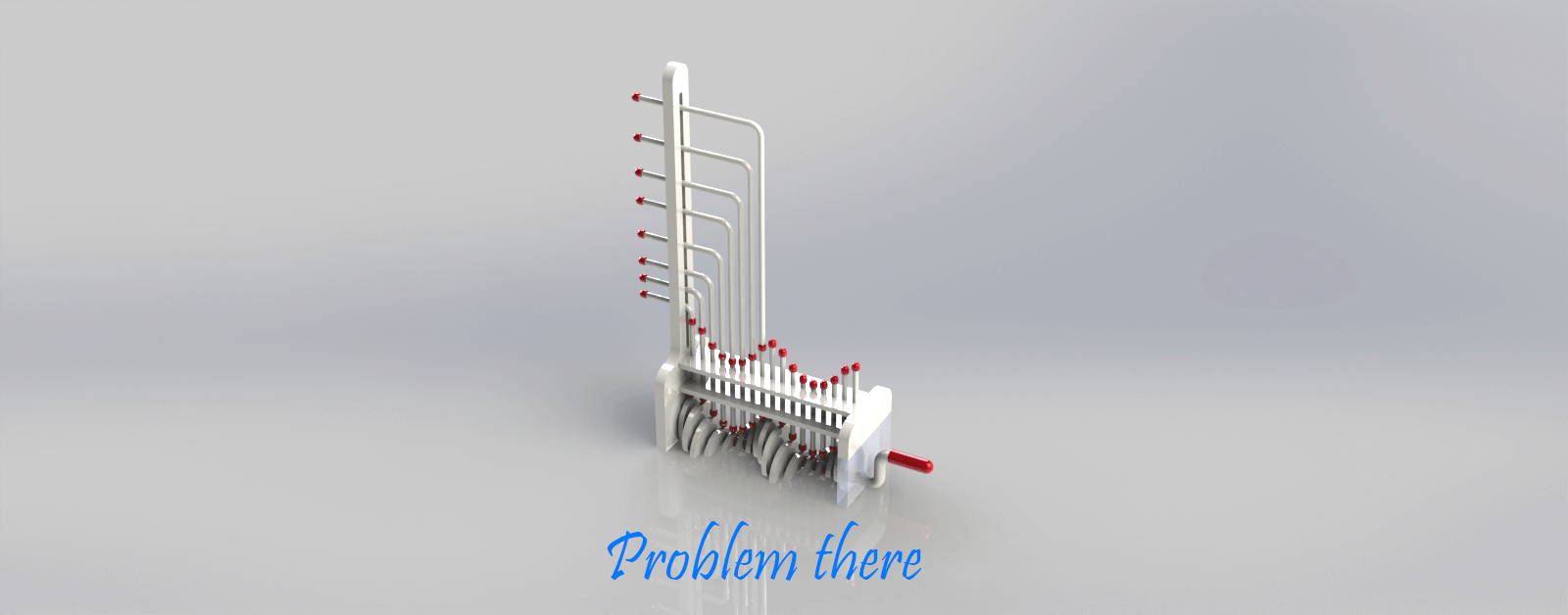

But this is what you'll get in the "Final Render".
As you can see, the model is cut from below.

Step 4: Comparing the results
This is how the rendering looks before and after changing the floor's offset.
