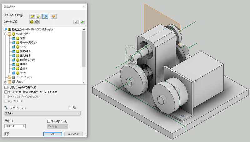

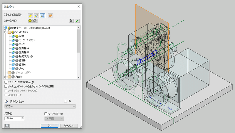

Parts model creation

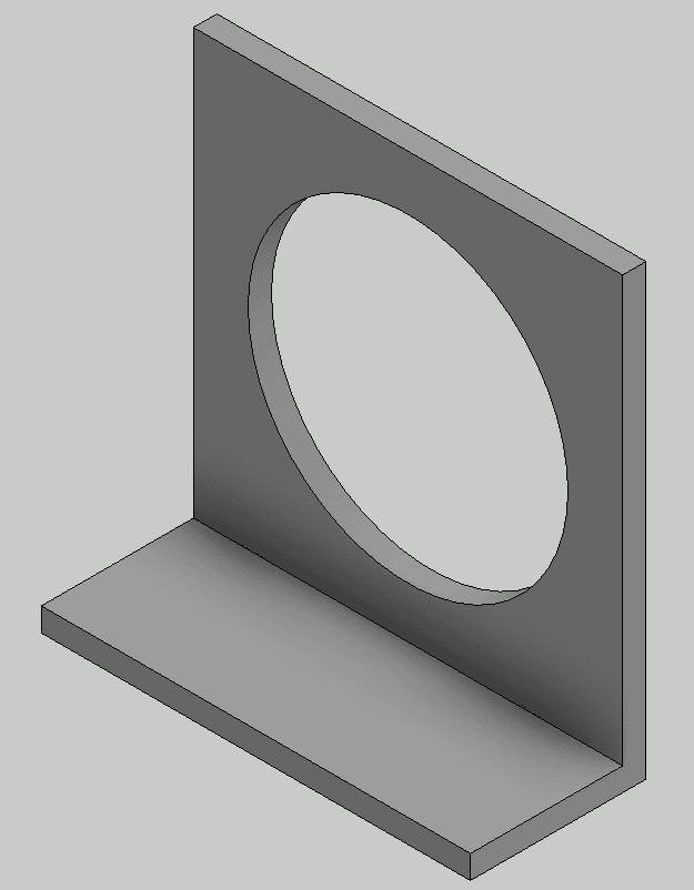

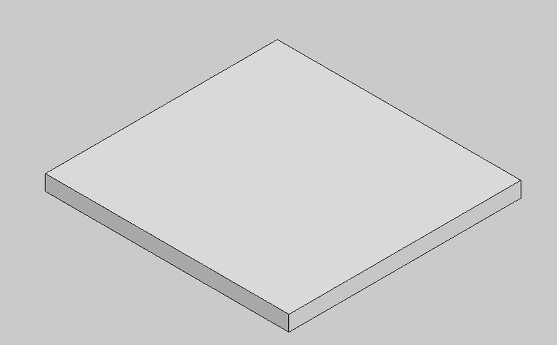

BASE PLATE
From the new part, open the LOD200 parts model using the features of the derived component.
The figure below shows the dialog box of the derived component.
Derived only the solid model of BASE PLATE. Also, the sketches, working objects, and parameters are derived only from those related to his BASE PLATE.
Select only objects related to BASE PLATE
BASE PLATE parts model created (not yet completed)
Follow the same procedure to create other part models.

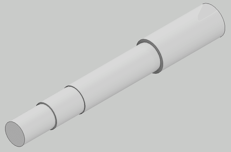

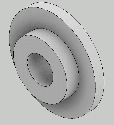

SHAFT(A.B)・BEARING BOX・SPUR GEAR(A.B)
SHAFT
BEARING BOX
SPUR GEAR(A.B)

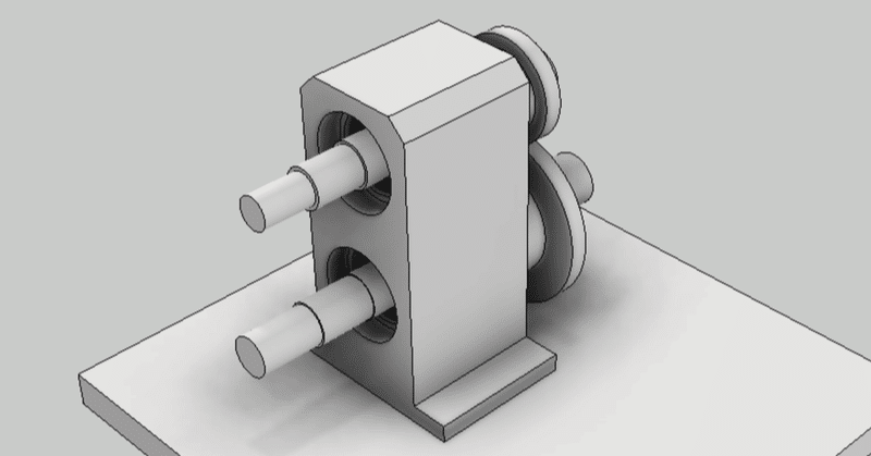

Assembly model creation
Place the created part model on the assembly model. Since it is based on the skeleton model, it will be automatically laid out in the correct position.
Parts are placed in the proper position
I like this technique very much because I don't have to use assembly constraints such as mate and flash.

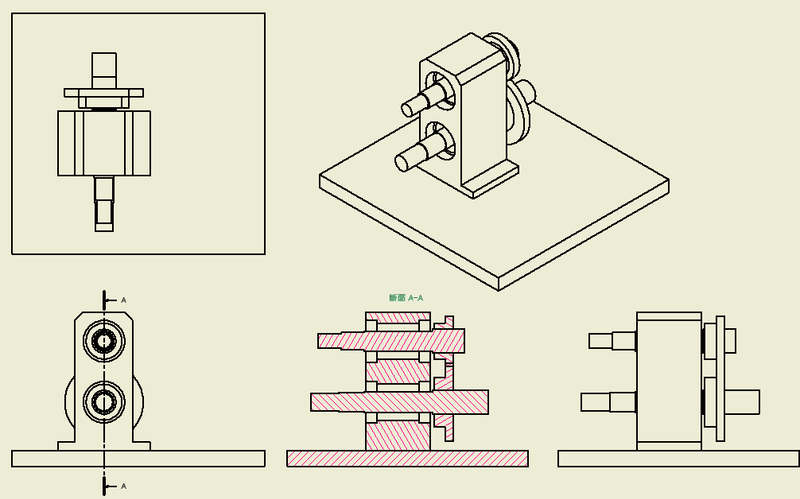

2D drawing creation
Create a 2D drawing at the same time. Create a three-view view and a cross-sectional view of the output shaft. At this stage, it should look like the figure below.
As you proceed with the detailed design, you will have parts, assemblies, and 2D drawings.

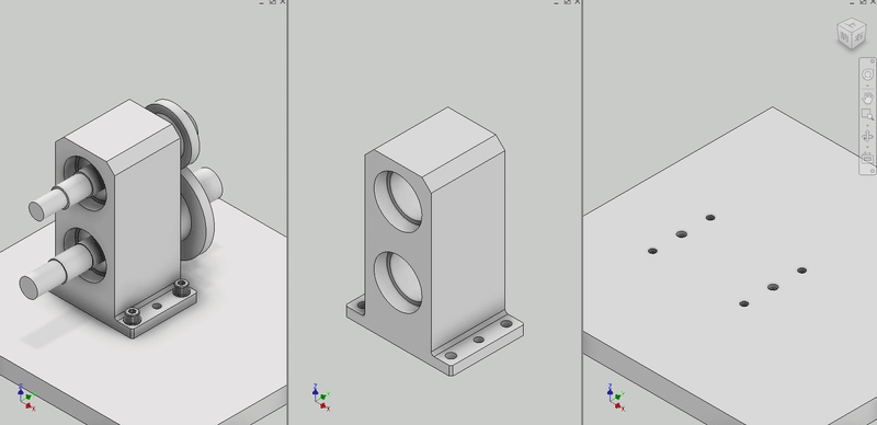

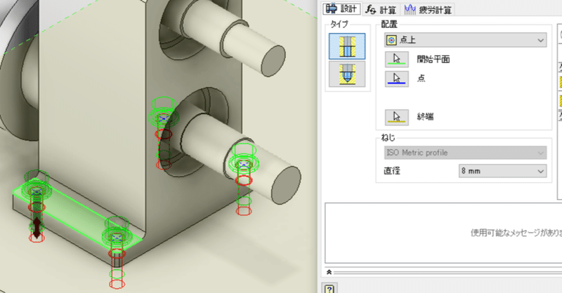

Sketch definition of hole position in bearing block
Create a sketch on the bearing block and define the location of the holes as "points". The mounting screw holes (4 places) and the positioning pin holes (2 places) are sketched separately.
Create holes and fasteners at the same time with the bolt fastening generator
Open the assembly model.
The sketch created on the bearing block is displayed.
Run the bolt Fastening generator.
It makes holes in both the bearing block and the base plate in one operation, and also arranges bolts and washers. There are no mistakes in position, size, or type.

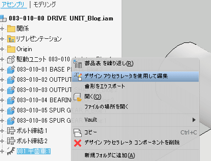

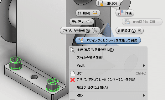

What about design changes?
Execute "Edit using Design Accelerator".
The Bolt Fastening Generator dialog box will appear, where you can modify any changes. If there is a hole position correction, correct the position in the hole sketch in advance and then run the bolt Fastening generator.
Benefits of using point options
In the placement option, you can use an existing hole, but if you select a point, the hole will be created automatically. It is easy to use because the size of the hole can be changed and the sketch can belong to any place.

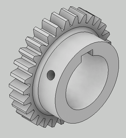

Spur gear component generator

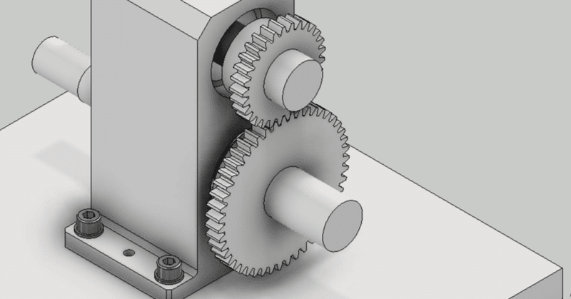

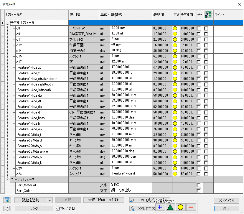

I used it for conceptual design, but I also use it for detailed design. Let's run the spur gear component generator from the assembly model.
Open the gear template created in the concept design (LOD200) phase. Select Features as the model creation method. When featured, gears are added as features to the existing model (the two parts on the right in the figure). (If you select a component, a new part model will be created.)
Specify the gear assembly position and perform the calculation.
Check the preview. OK to complete the gear model.A tooth profile has been added to the gear parts model.

Design changes using design accelerators
Design changes are made using the Design Accelerator, similar to the Bolt Fastening Generator.

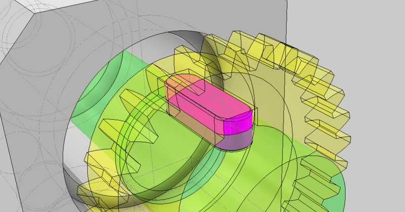

A key is used to transmit torque between the gear and the shaft. The size of the key is determined by the shaft diameter. Dimensions and tolerances are determined by JIS. As an aside, it should be noted that JIS and ISO have different sizes even if they have the same shaft diameter.
Parallel key connection generator
The key design uses a parallel key connection generator.
Run the parallel key connection generator on the assembly model.
Select the JIS double round key.
Set the key mounting position and size.
OK
Keyways have been added to the axes and gears, and the keys have been placed in the assembly model.

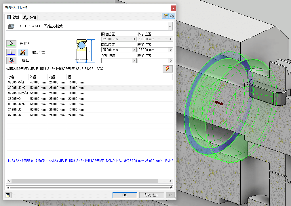

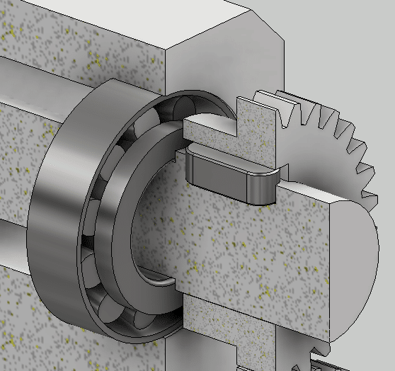

Step 5: LOD300 Bearing
Bearing

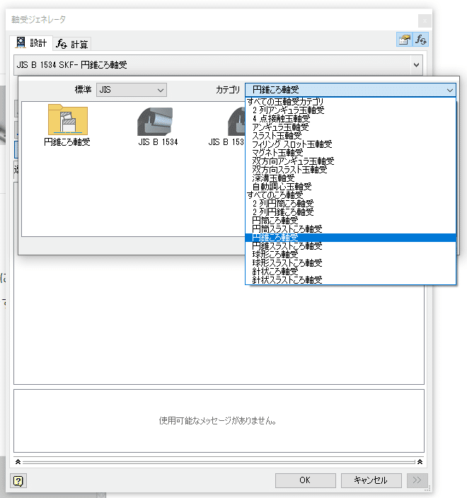

Bearings can be placed directly using the Content Center, but it is convenient to place the bearings using a design accelerator. Using the Content Center requires less effort, but there are many types of iMate and it cannot be tied up well. The design accelerator can be placed reliably. Also, even if you make a mistake in the direction, you can easily correct it. Of course, you can easily change the type and size.
Bearing generator
First, choose a standard. Here it is JIS. Next, select the bearing type (here, conical roller bearing) from the category.
Then select the datum for placing the bearings. Select the cylindrical surface (either the shaft side or the hole side is OK) and the end face. Candidate bearings are displayed according to the size of the selected cylindrical surface. A preview of the bearing selected by its name is displayed.
OK will place the bearing.
Place the four bearings in the same procedure.
It is easy to understand when the cross section is displayed.
Check the assemblability on the 2D drawing. If there is any interference or gap, go back to the LOD100,200 skeleton and modify the sketch dimensions.

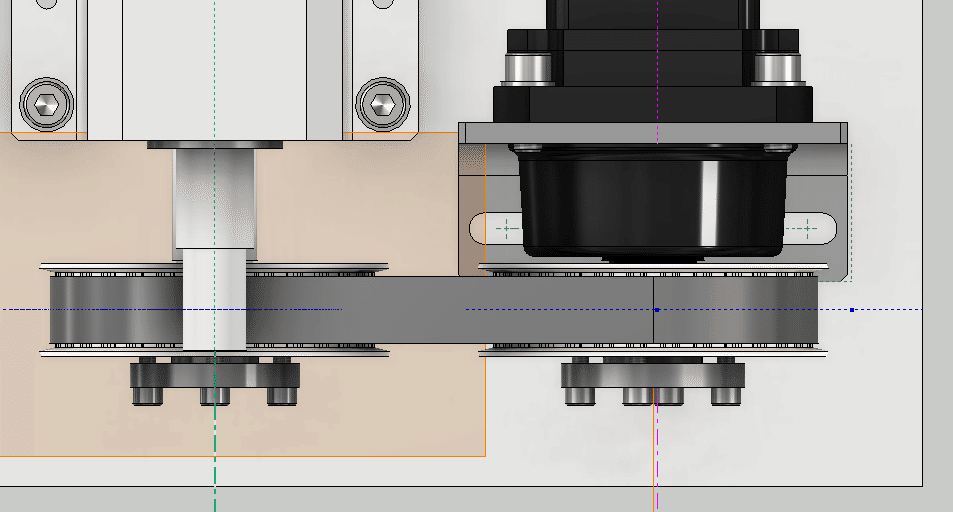

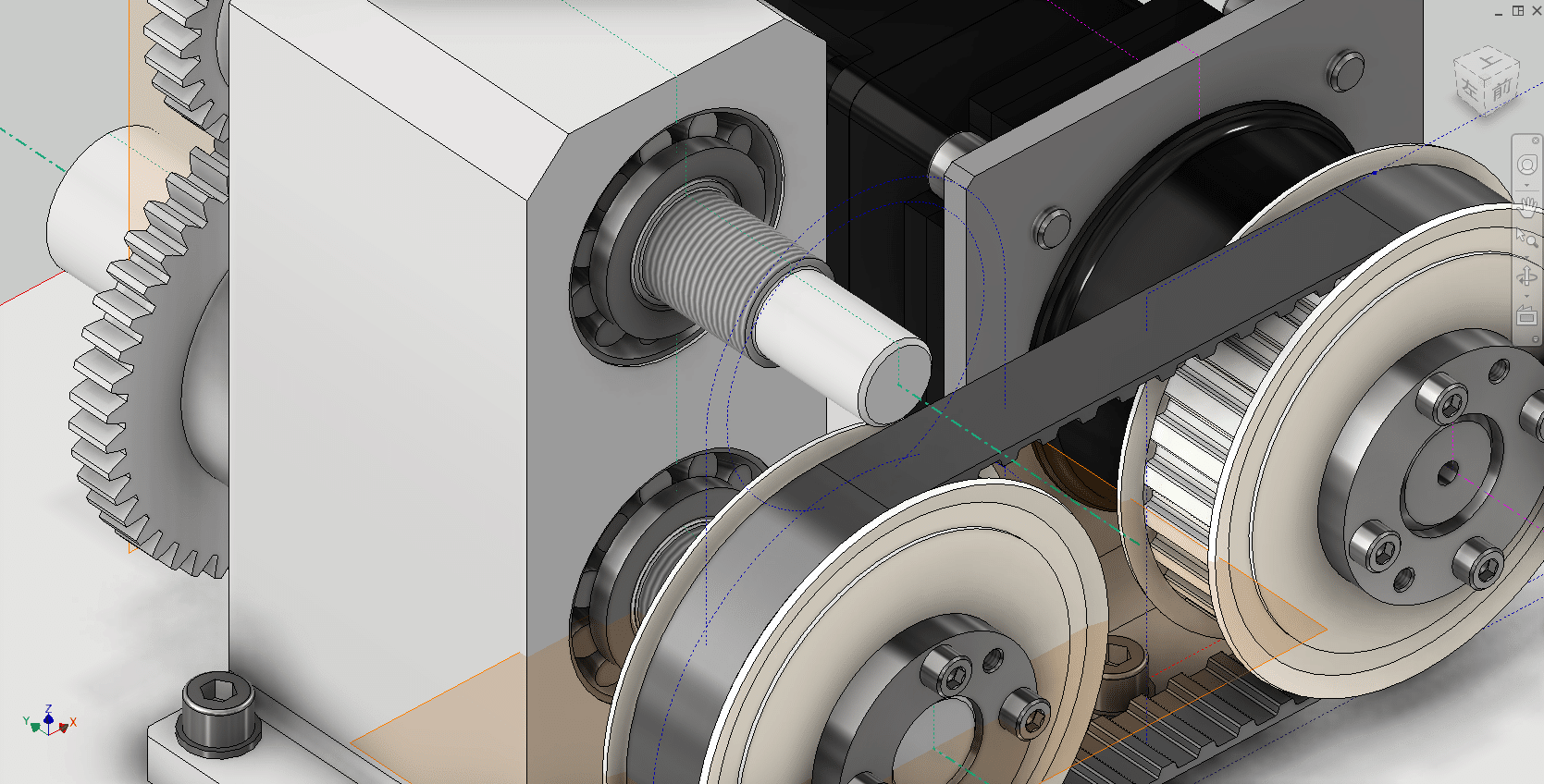

Step 6: LOD300 Detailed design of timing belt and pulley

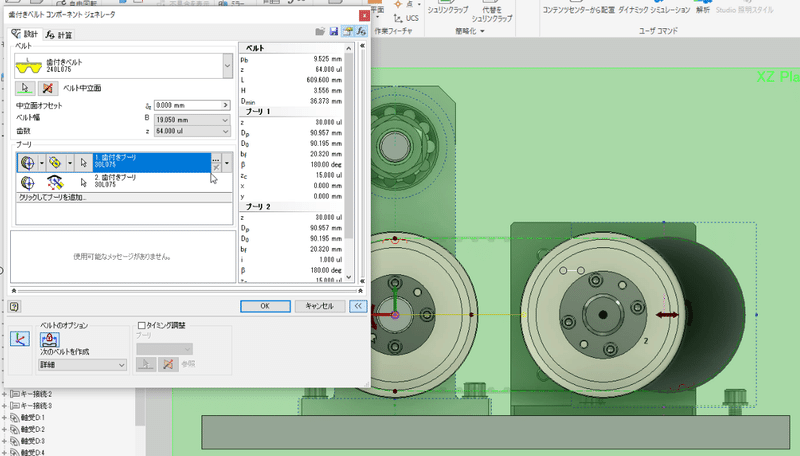

We will use the result of the timing belt design check performed on the LOD200. Use the template saved at that time to perform detailed design.
The timing pulley for the timing belt is a purchased item. Selected from Misumi's website. It is also convenient to download as a 3D model. Prepare shaft diameters of 22 mm and 25 mm.
Place the LOD100 skeleton on the assembly model
Place the skeleton on the assembly model as a reference for the placement of the toothed belt. Timing belts and timing pulleys are placed with reference to the geometry on this skeleton.

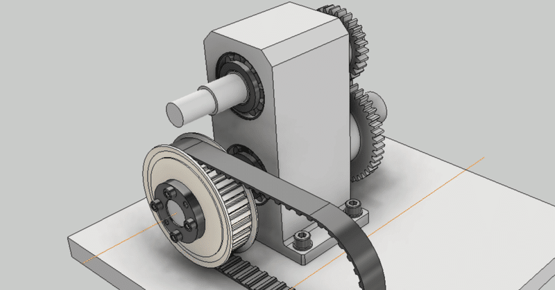

Timing belt placement
Place the timing belt using the saved template. When placing, refer to the geometry of the skeleton model.
Since the pulley will be placed later, select virtual. If you select Details in the belt options, the tooth profile will be displayed on the belt.
The length of the timing belt is not a good value. The position of the drive shaft deviates slightly from the position of the skeleton. This deviation will be adjusted by making a slot in the motor mounting bracket.

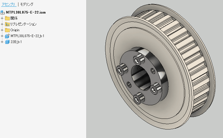

Arrangement of timing pulley
Hide the skeleton once to avoid confusion. The pulley is placed with reference to the geometry of the timing belt.
Place the timing pulley in a suitable position. Then, from your browser, check the geometry to use for the constraint.
Place using constraints. Please refer to the video.
Follow the same procedure to place the timing pulley on the drive side.
Confirmed with 2D drawing

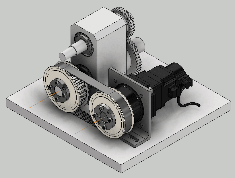

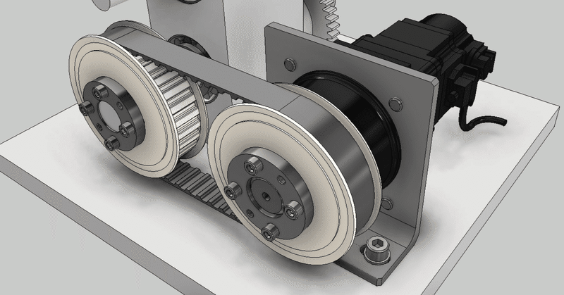

Step 7: LOD300 Servo motor installation
Install the servo motor according to the position of the timing pulley.

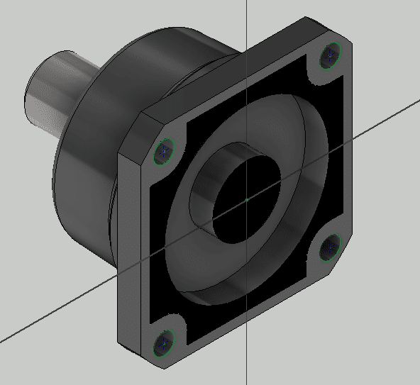

First, create a subassembly model that includes the servo motor and mounting bracket. The next step is to constrain the assembly model to the timing pulley and base plate.

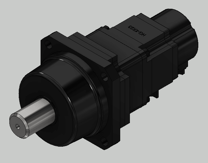

Servomotor
For the servo motor, use the original model referenced in GrabCAD.
# Mitsubishi HG-KR23G1-1.5 Servo Motor.iam
This model is a STEP file. There are mounting holes in the gearhead parts, but they are not recognized as hole features. Therefore, add a sketch and place a point at the hole position.
Creating a servo motor assembly

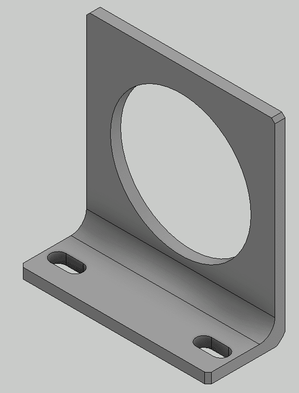

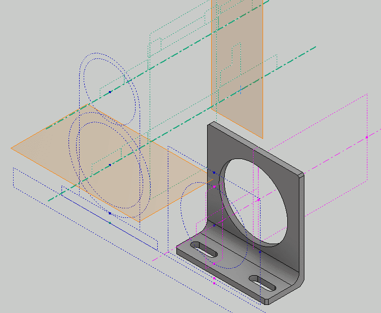

Create a motor mounting bracket from the LOD200 skeleton.
It is made by bending a plate with a thickness of 9 mm. The motor mounting holes will be drilled later using a bolt fastening generator.
Create a new assembly model and place the motor mounting bracket at the origin.
Placed at the origin. Skeletons are placed for comparison, no placement is required in the actual design.

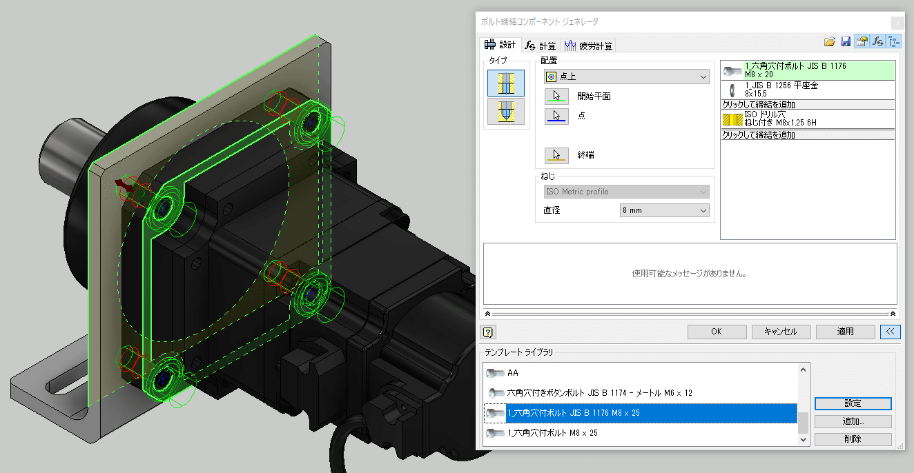

Mount the servo motor on the motor mounting bracket. It is constraint by the rigid of the joint.
Place the bolts using the bolt fastening generator. At the same time, mounting holes are created in the motor mounting bracket.
Servo motor assembly placement
Install the servo motor assembly on the drive unit. Constrain the skeleton and timing pulley shafts and the motor shaft, and constrain the bottom of the bracket and the top of the base plate. The axial direction of the motor is constrained to the sketch of the skeleton.
* It is also possible to restrain the components between the skeleton and the servomotor assembly, remove the restraint in the mounting direction, and restrain the shafts. This may be easier to understand later.
Use the bolt fastening generator to place the bolts on the bracket base plate. The location of the holes in the base plate is specified using the skeleton sketch.

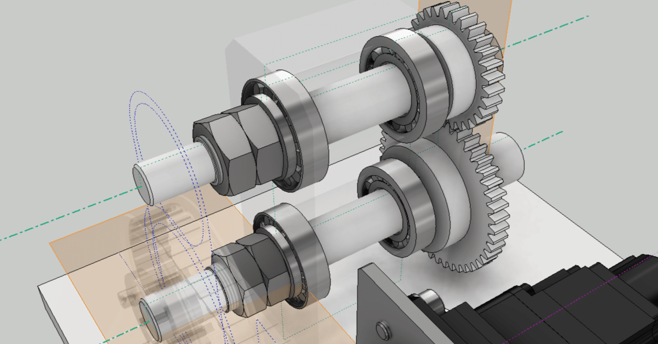

Step 8: LOD300 Detailed design of output shaft and related parts
Finally, make Detailed design of output shaft and related parts. This completes the design of the 3D model.

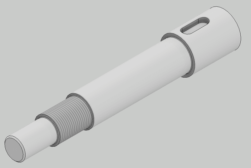

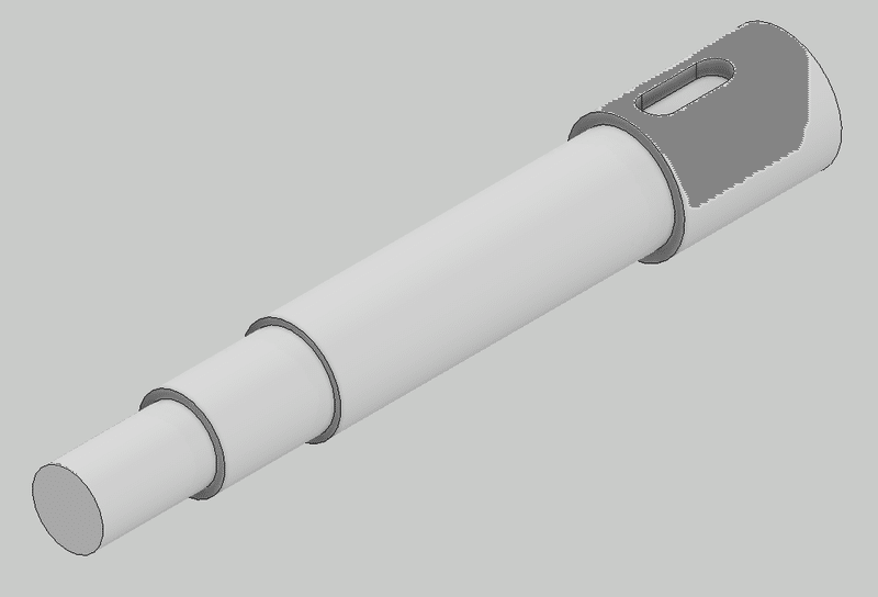

The keyway has already been created in STEP4.
Add a detailed shape to the output axis. Add fillets and chamfers. Also, add a fine screw for the nut.
Fix the bearing with a double nut
Place a Type 3 nut from the Content Center. Make sure the screw is a fine screw. And place it. Since there is still a degree of freedom in the direction of rotation just by arranging it, use angle constraint to fix it in a good-looking position.

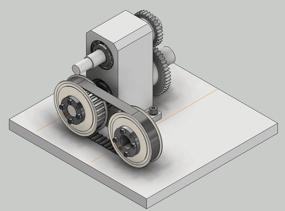

Completion of assembly model
Bearing blocks are transparent for easy understanding
Completed by hiding skeletons and working objects.

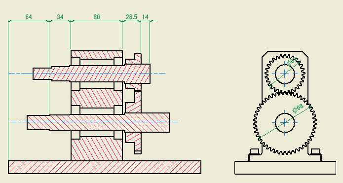

Confirmed with 2D drawingConfirmed with 2D drawing

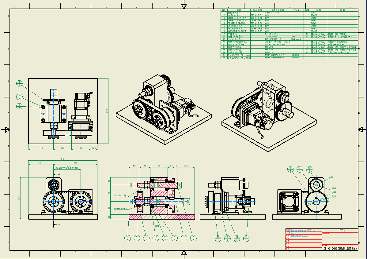

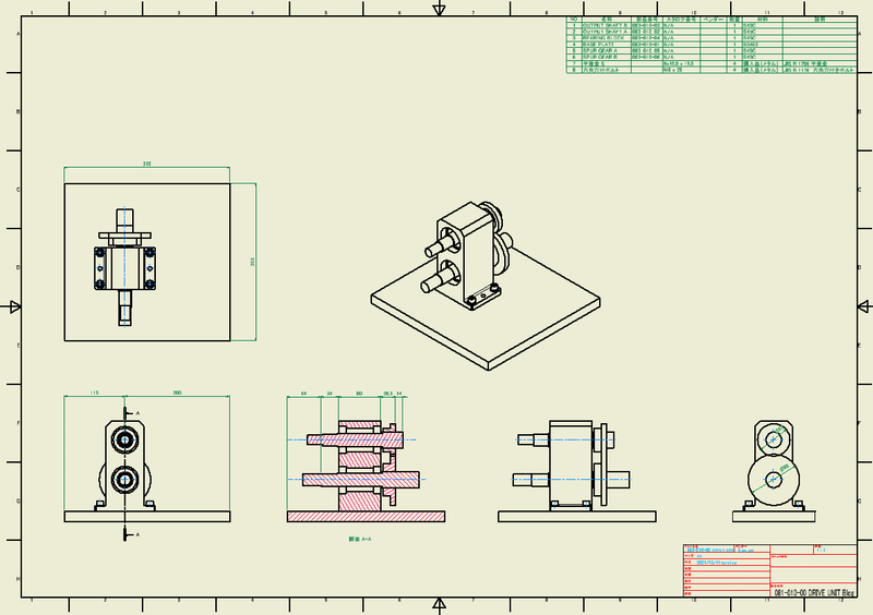

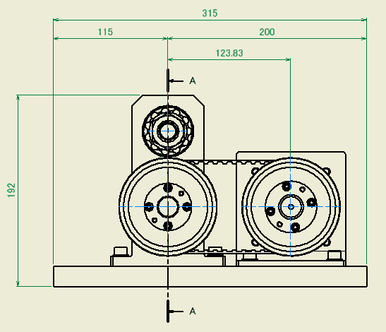

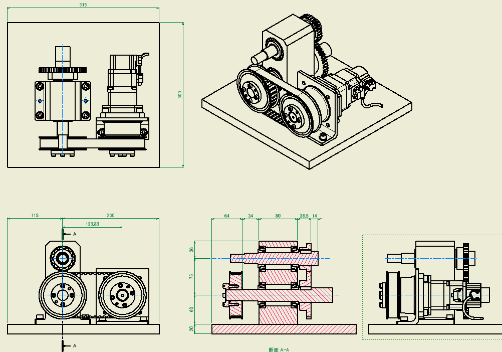

Step 9: LOD300 2D assembly drawing
Complete the 2D drawing.
As explained so far, even while creating a 3D model, the 2D drawing is updated from time to time, so the following drawing is created. I will complete the drawing based on this drawing bellow.
Layout
A1 size, scale 1/2, front view, plan view, right side view, cross section of output axis, rear view, isometric view (2 places) are arranged as shown in the figure. Make sure you can afford to fill in the dimensions and balloons.
This layout is good because it meets the requirements.
In addition, the isometric view on the back will be better if you can see the connection of the output shafts.
Unhide the bearing block in cross section. is. Based on this drawing, I will complete the drawing below.
Dimensions, notes
Add dimensions and notes. It also adjusts their positions. If you don't have enough space for the dimensions, adjust the layout of each view.

Displays the pitch circle of the gear. To do this, add a sketch showing the pitch circle to the spur gear parts model in advance.
I will explain how to modify the parts model.
Open the gear parts model.Create a new sketch on the end face of the gear, create a sketch circle concentric with the hole, and select the dimension from the parameters. Since we are designing with a spur gear component generator, the gear properties are registered in the parameters. Use the value of this parameter.
This is a method to display the pitch circle on the drawing.
Select Include Model Sketch to display the sketch. Then use the properties to make the linetype a dashed line.

The tooth profile has disappeared because the diameter of the outer diameter circle of the gear has not been corrected.
The tooth profile is displayed. But this time it is interfering with the base plate.
Change of axis height
To avoid interference between the gears and the base plate, open the LOD100 skeleton and change the shaft height from 60 to 80.
There is no interference.
The shaft height of the motor assembly has also been changed correctly.
Correction of tap hole position
Use the bolt fastening generator to correct the tap hole position.
Check the change result in the 2D drawing
Make sure the changes are correct in the 2D drawing.
From
To
It is completed by aligning the dimensions and the position of the balloons.
