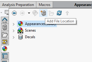

In the new pane, click the chevron next to appearances to get a drop down of different categories of appearances. You can look around in here for the texture of your choice, but unfortunately, in our case, that texture doesn't exist... yet.
We need to add the folder of images that Solidworks already has on file for materials. We'll do this by collapsing the Appearances drop-down we just opened and selecting the "Add File Location Icon".
The folder that I want to add is found in under Program Files->SOLIDWORKS Corp->SOLIDWORKS->data->Images->textures. I want to add the "textures" folder, as that contains a lot of the images that I would want to apply.
Once you have the folder you want to add selected, click the "OK" button. It won't look like anything has happened, but once you expand the "Appearances" drop down again, you'll see a "textures" folder available.

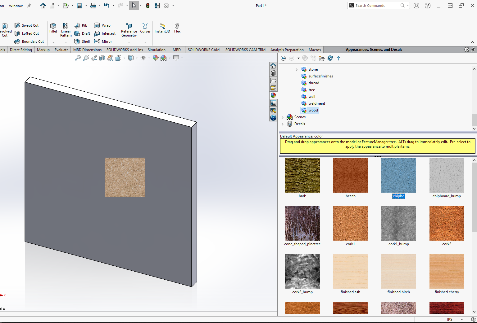

Open your new "textures" folder, and scroll down to the "wood" sub folder. When you click on this you'll see a variety of wood textures that you'll be able to apply. We're going to grab the "chipbd" texture and drag and drop it onto our part.
Once you drag and drop the appearance on the part, you'll see a little pop-up of options with absolutely no text, so let's talk about this:
This pop-up allows you to select at what level you wish to apply your appearance. You can apply (from left to right) at the face level, feature level, body level, and part level. The hierarchy that will be followed when applying the appearance is from left to right here, meaning that any appearance applied to a face will always override any other appearance applied to a feature, body, or part.
I generally just stick with using the part level appearance, though occasionally when I want to highlight a face, or simulate some kind of painted surface, I'll use the face level appearance.
In this case, let's choose the body or part level appearance.

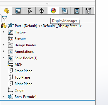

Once we've done that, we may want to edit the appearance and tweak it further. This can be going over to your feature manager and selecting the DisplayManager tab.
Once you select the DisplayManager tab, you'll see options to edit your appearances, decals, and any scene related stuff. We're focusing on the appearances for now, so make sure that the tetra-colored icon is selected and you are seeing "Appearances" in the title bar.
Mine defaults to the sort order of "History", but I find that a hierarchical drop down is more useful in some cases. It will show you what level things are applied at (face, part, etc.) You can use the "History" or "Alphabetical" view to see all of the active appearances.

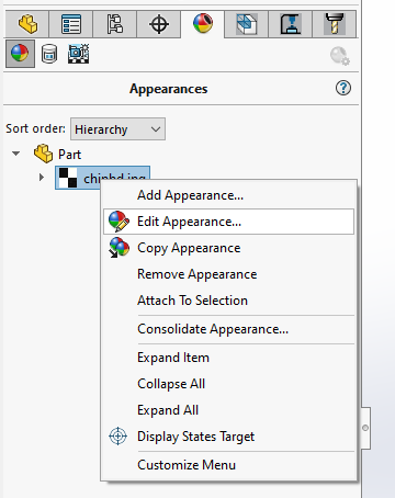

From here, you can always right click on any appearance that you have applied and modify its properties. Modifying these properties is beyond the scope of this particular tutorial, so feel free to explore the options and see what they do.

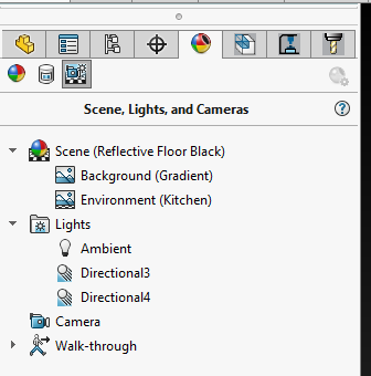

Environments are set up in the same way that appearances were. Navigate the to the Taskpane on the right, but instead of dragging and dropping an appearance, you'll drag and drop a scene into the main view window.
Below I'm apply the reflective black floor scene. But you can apply whichever scene you like.
Over in the DisplayManager, you can click on Scene Editor to modify elements of the scene. The scene contains appearances for the background and environment, any lights that are active, cameras, and any walk-throughs. Walk-throughs are an entirely difference ball-game, and not what we are doing here. In all my years of SolidWorks, I've never really had use for it.
Feel free to add any lighting that you like here by right clicking on "Lights" and selecting the desired light. This is more of a trial and error sort of thing, so have fun playing with it!

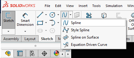

Once you have the 3D sketch active, choose the spline tool.
In this tutorial we are going to make a simple curved path. You can make it as complex as you like, with the only caveat being you can't have self-intersection on the curve.

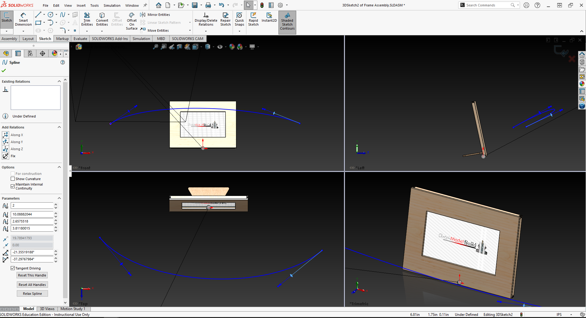

I have found that setting your main display into the 4 quadrants mode is very helpful for this step.

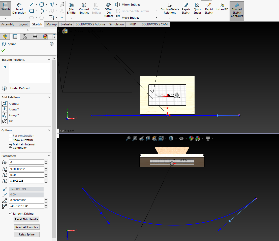

Now that we can see easily what we are going to do, I'm going to create the basic spline with two points. To make it curvy, we'll modify the tangents in just a minute. Click to place the two spline points and then hit ESC when you've finished.
Click on the spline in order to see the tangent handles.
Click and drag them until you get the shape that you want.
The nice thing about the 4-quadrant set up is that we can easily change the height of the spline as well (without modifying the other axes). You can do this by clicking in any of the other quadrants and dragging the points and tangent handles around...

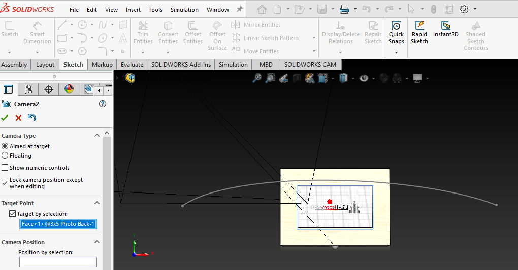

Step 6: Adding a camera
The point of the 3D sketch spline was to make a path for our camera to follow. Let's add that camera now. Navigate back to the DisplayManager, right click on "Camera" and add a new camera. I've already got one in the picture frame file, so you'll need to add a second camera.

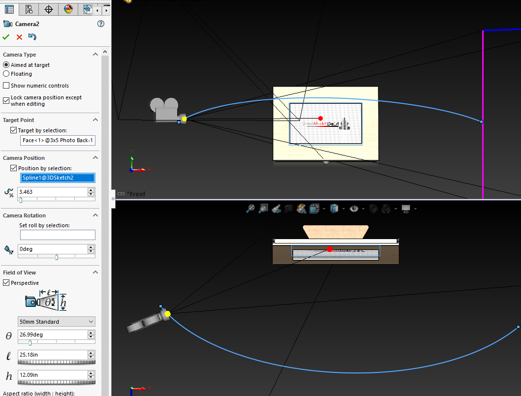

In the new properties manager that opens, we'll be changing three things. The first is the target point. This will keep your camera locked on this point. I'm going to choose the window pane of the frame. You might find it useful to create a reference point or a piece of construction geometry for the camera to focus on as well.
Next, we are going to select the "Position by selection" box and then select the newly made 3D sketch.
Below the "Position by selection" box, there is now a numerical entry. This number represents the percent along the path. If we were to put 0%, it would start at the left most point (at least on the curve that I created). It we selected 100%, then if woul dbe at the right most point. This is the value we will be modifying in our motion study to have the camera move along the path.
Last but not least, we will make sure that our camera roll is set to 0. Sometimes this can get wonky, and I just want to make sure the roll stays constant. Though you might be thinking that this would be something you could animate later, and you can!
Next, we'll make sure our camera is see what we want it to see. Click the check to save the camera.
Revert to a single viewport in your main display, and then use the drop down to select the camera view. This will have the main viewport display what that camera is seeing.
Right click on the camera in the display manager and edit the camera. Here you can now update the Field of View parameters and see how it changes what the camera sees. Modify these values until the your model is displayed as you want it to be in the viewport. I chose a perspective 24mm wide angle camera.

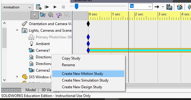

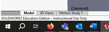

Step 7: Creating the Motion Study
This next step may be a complete new things for some people, so I'll try to help you get acquainted with how a lot of animation software operates. But first, let's create our motion study. Down at the bottom of the main display window, you'll see a default "Motion Study 1" tab. If you don't, just right click anywhere down there and select "New Motion Study".
When the new motion study is created, you should see an screen something like the one shown below.

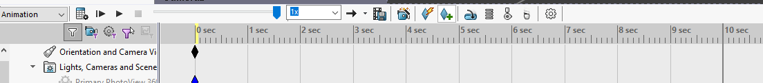

Motion studies and animation software operate on the basis of a thing called "key frames". These are special points in time that the software will interpolate motion between. In our case, we will be using two key frames, one at the start of the camera travel, and one at the end of camera travel.
Key frames are shown in the timeline at the bottom of the screen. Wherever you see a blue diamond, that is a key frame. Initially, we have key frames a the beginning of our timeline.
Each element of your assembly, including cameras, lights, parts, mates, can all have key frames. For example, you may want a mate to be active only for a certain time frame during an animation. You could do this by having a key frame where it turns on or off. You may want a part to travel between two key frames. For more advanced simulations, you can even create motors and simulate gravity!
For our purposes, we are just being really simple and animating a camera.

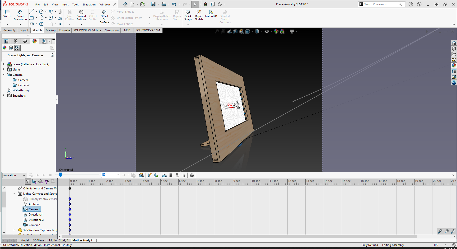

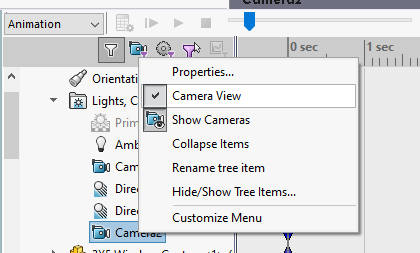

First, we will make sure that we are using our new camera for the view port. On the both left of your screen, expand the "Lights, Cameras and Scenes" folder and right click on your new camera. Make sure "Camera View" is active.
We now have the camera view active. Let's move our timeline marker to the 10 second mark and add a new key frame. Click on the timeline bar to move the vertical bar to 10 seconds and then click the "Add new key frame" icon.
You should now have a brownish highlight between the two key frames. Awesome. We're almost there. Now we need to modify the camera position at each of these frames. Let's start with the beginning.
Double click on the blue diamond along the Camera track. You'll see the camera dialog open up.
Modify the distance along the camera position curve to zero.
Click the green check to accept the changes and then double click on the right-most blue diamond key frame.
Modify the camera position in this key frame to 100. You'll see a turquoise line show up along the brownish highlight between the key frames. This indicates that there is some kind of action happening for this item during this time frame (the camera is moving). You'll also see the display window change.
That's all we need to do for animating the camera! Let's see our work! If you haven't clicked the green check to accept the changes you made, do that now. Use the slider at the top of the motion study to rewind, and then click the "play" arrow to watch your animation in all of its glory!

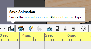

First, click on the "Save Animation" icon.

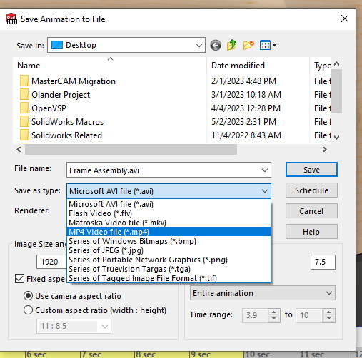

You can save as a native AVI file, but I prefer the .mp4 format, so select the drop down and choose that as your file format.
Pick a file location to export and then press Save. Solidworks will run through the animation and save it where you specified. If you want to change the frames per second, you can, but be warned that more frames will take longer to run through. It'll be more smooth, though.

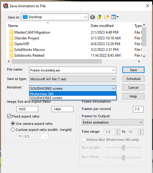

That's the fast way to do this. However, if you have a presentation and you want to use all of that fancy texturing that we did then, we can use PhotoView 360 to export our animation. This takes a lot longer, and significantly more computer resources, but it can make a really polished video.
First, make sure that PhotoView 360 is active. Then, go to the same "Save Animation" dialog, but this time choose PhotoView 360 as your rendering tool.
There are options for motion blur, but leave that blank for now. It can really mess up a short render, and it can be annoying to have your computer crunch for an hour only to spit out something unusable. But when you have time, play with it!
Set your other options as before, and then click save button (alternatively, you can schedule it to run at a different time when you aren't needing your computer).
Solidworks will run through the animation, and then a pop will appear showing rendering progress. Solidworks first has to solve the animation, then it goes in an renders each frame, calculating reflections, shadows, etc. It takes a while.
That's it! you've gone through the whole process. The mp4 file that you made should be viewable in most video software! Hope that was helpful.
