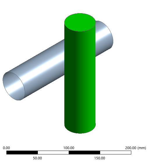

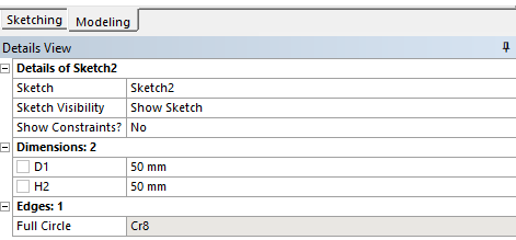

    • The modeling parameters for Rigid Side Pole (Solid Body) could be seen below:

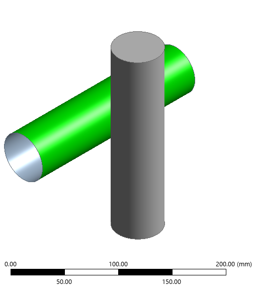

    • The modeling parameters for Crashing Component (Surface Body) could be seen below:
