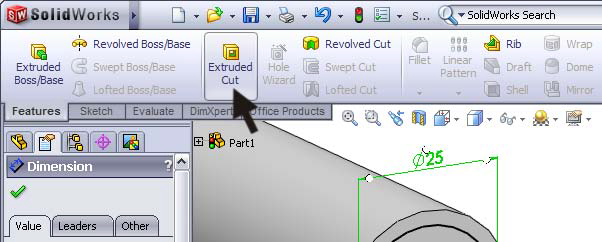

    Click on ‘Features’ to show the functions for adding or removing material.
  27. Step 27:
    Click on Extruded Cut. You can remove material with this command.
  28. Step 28:
    Next, enter the following features:
    1. A depth of 55
    2. Mark ‘Flip side to cut’ to make sure material on the outside of the circle, not the inside, is removed.
    3. Click on OK.
