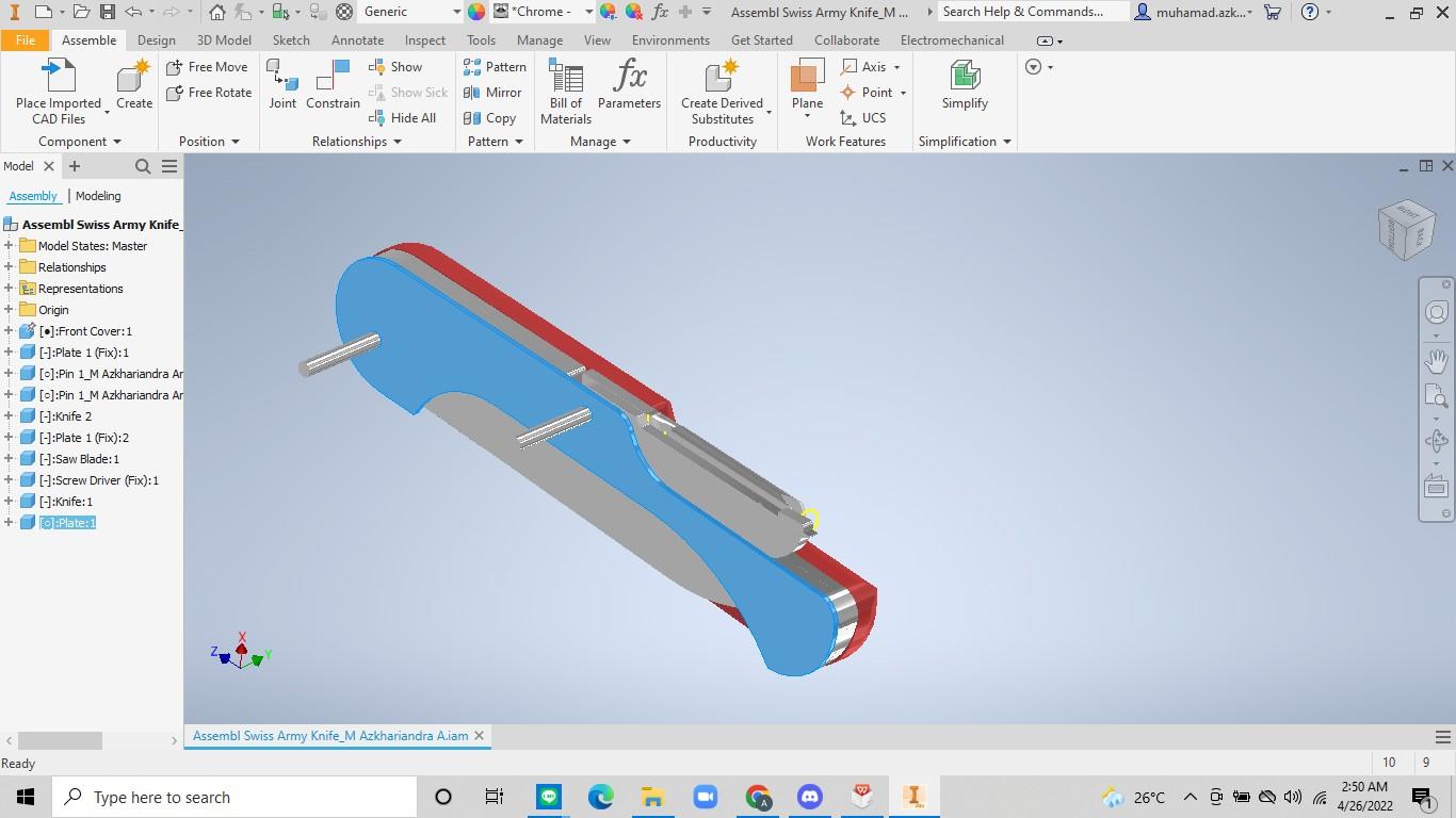

  1. Step 1:
    Put the Front cover and constrain it with the plate 1, Use mate and tangent
  2. Step 2:
    Insert the Pin 1 (2 of them) and constrain it with the two hole (in the picture) in the cover using insert constrain

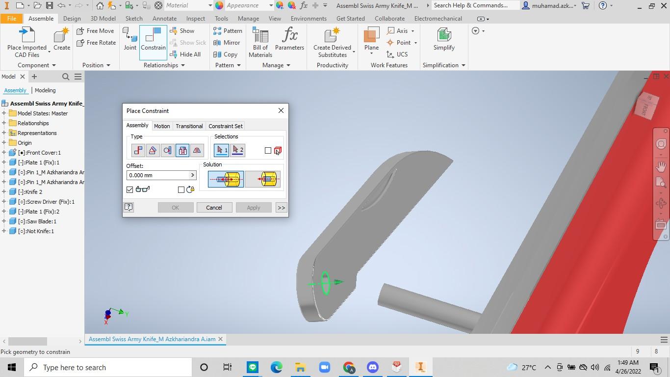

  3. Step 3:
    Insert Knife 2 and constrain the hole with the pin with insert constrain
  4. Step 4:
    Insert screwdriver and constrain it with insert constrain with the second pin

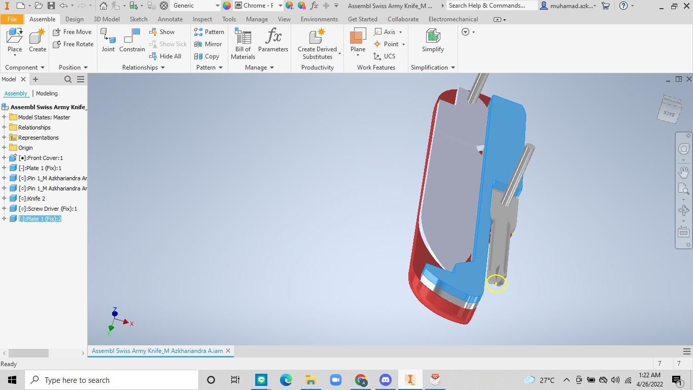

  5. Step 5:
    Insert Plate 1 again and cpnstrain it with the previous plate 1 with mate constrain and tangent constrain

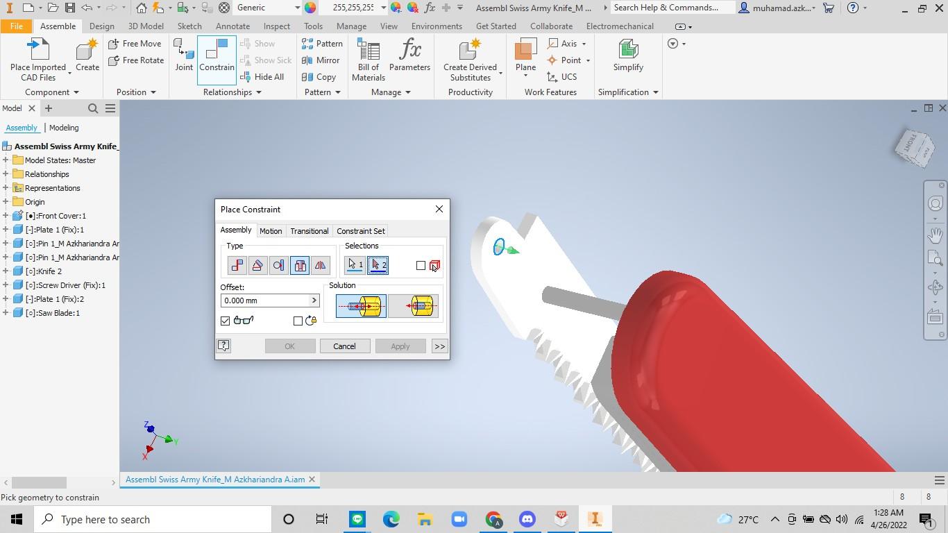

  6. Step 6:
    Insert saw blade and constrain it with the pin with insert constrain
  7. Step 7:
    Insert Knife 1 and constrain it with the second pin and constrain it with insert constrain
  8. Step 8:
    Insert main plate and constrain it with mate constrain

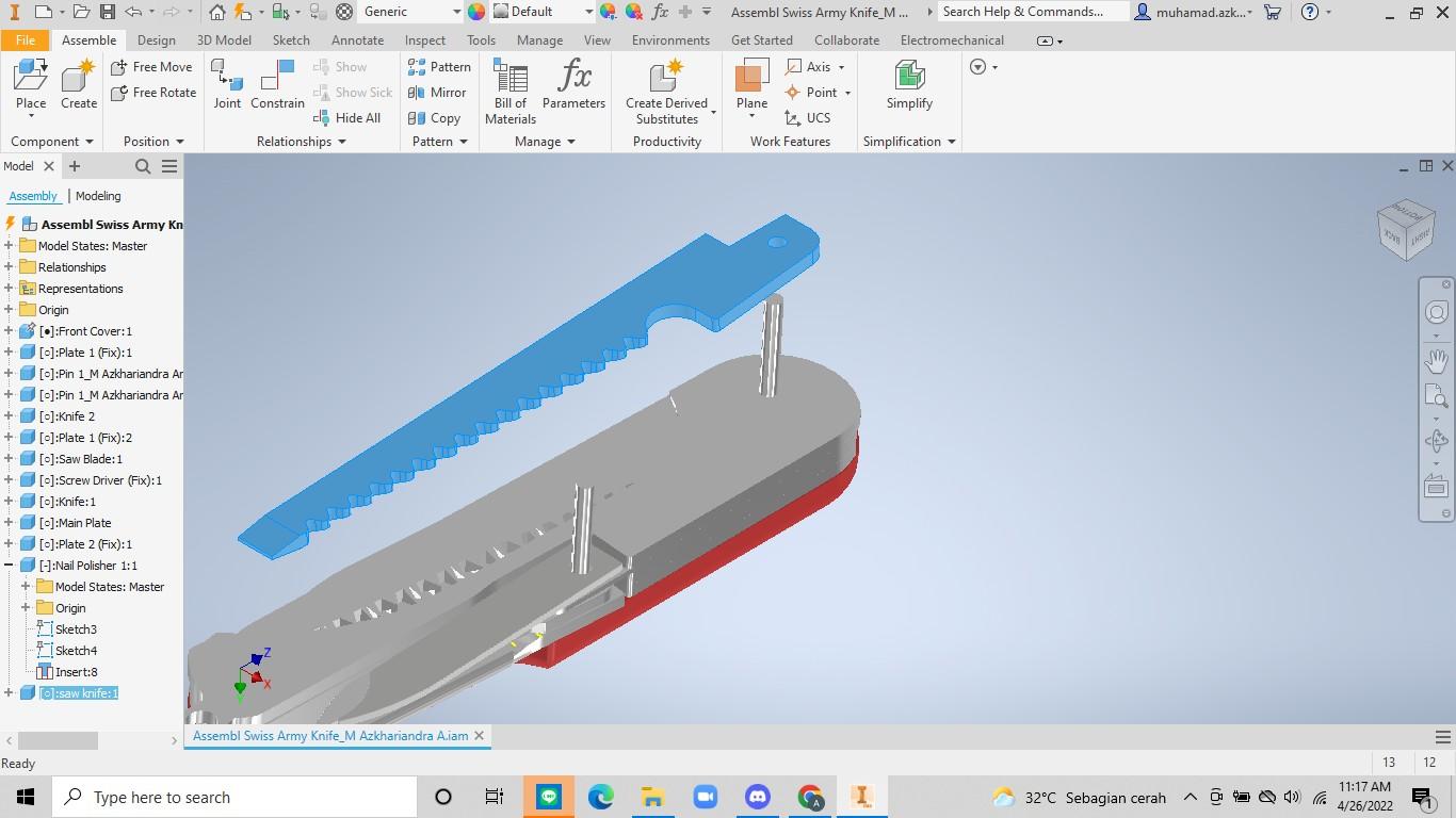

  9. Step 9:
    Insert nail polisher in the second pin with the insert constrain

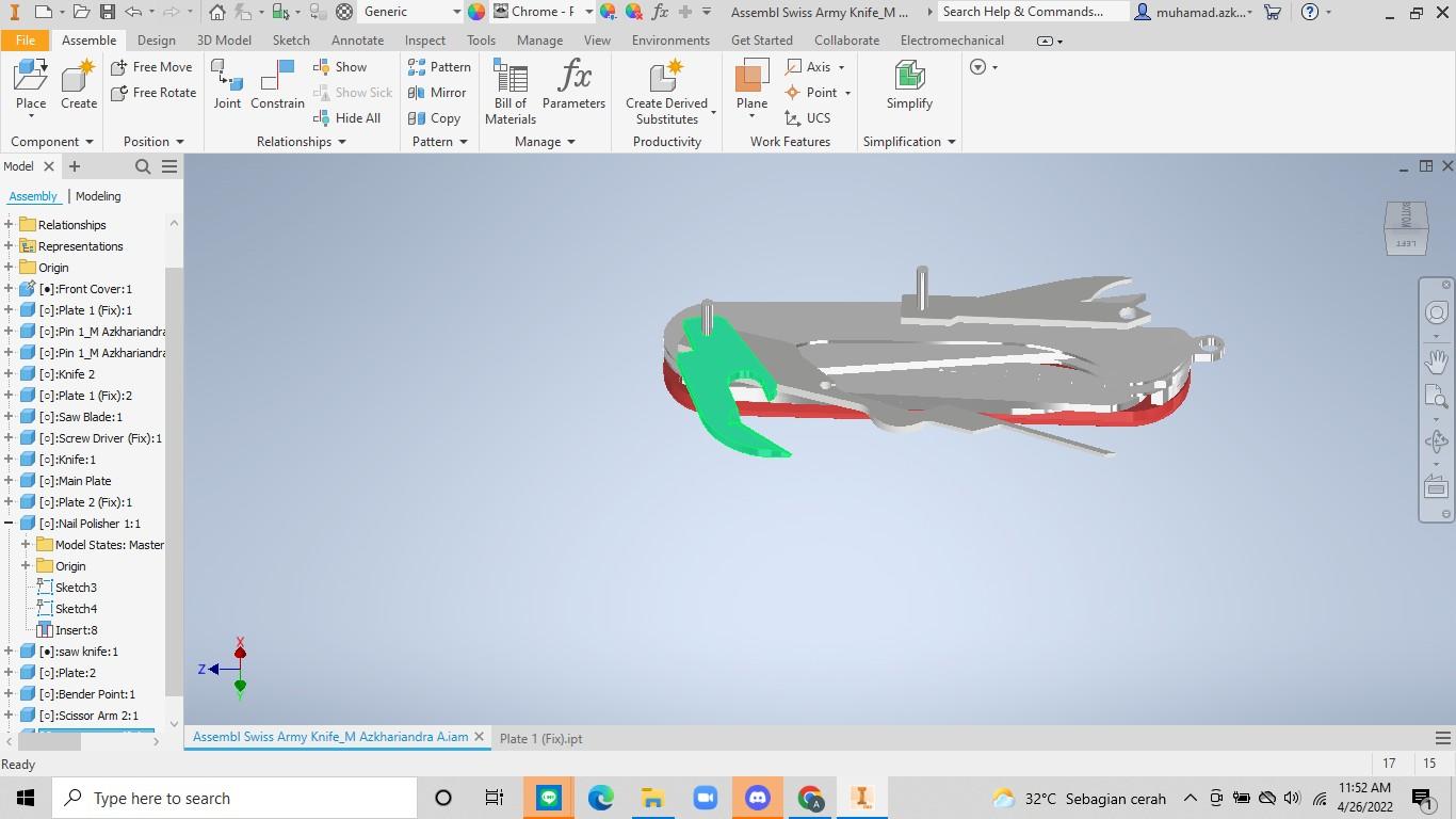

  10. Step 10:
    Insert blade in the first pin with the insert constrain

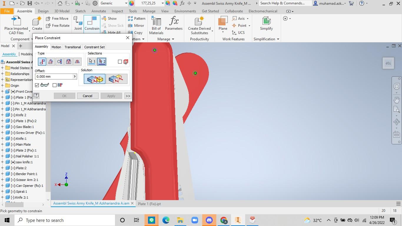

  11. Step 11:
    Insert can opener and constrain it with first pin with insert constrain
  12. Step 12:
    Insert back cover and constrain the hole with the pin with mate constrain
  13. Step 13:
    And the Swiss Army Knife is done
