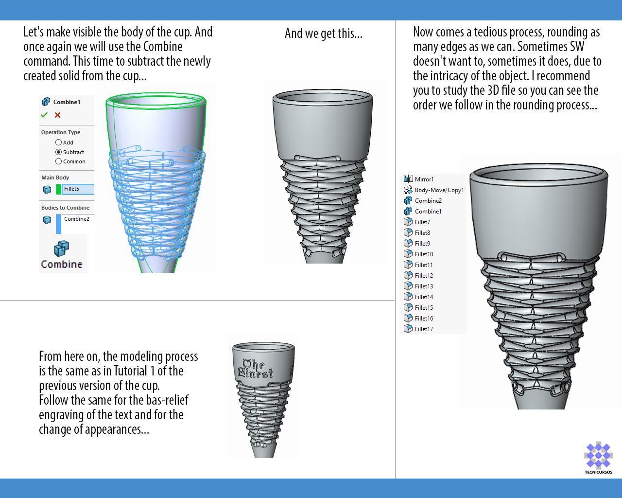

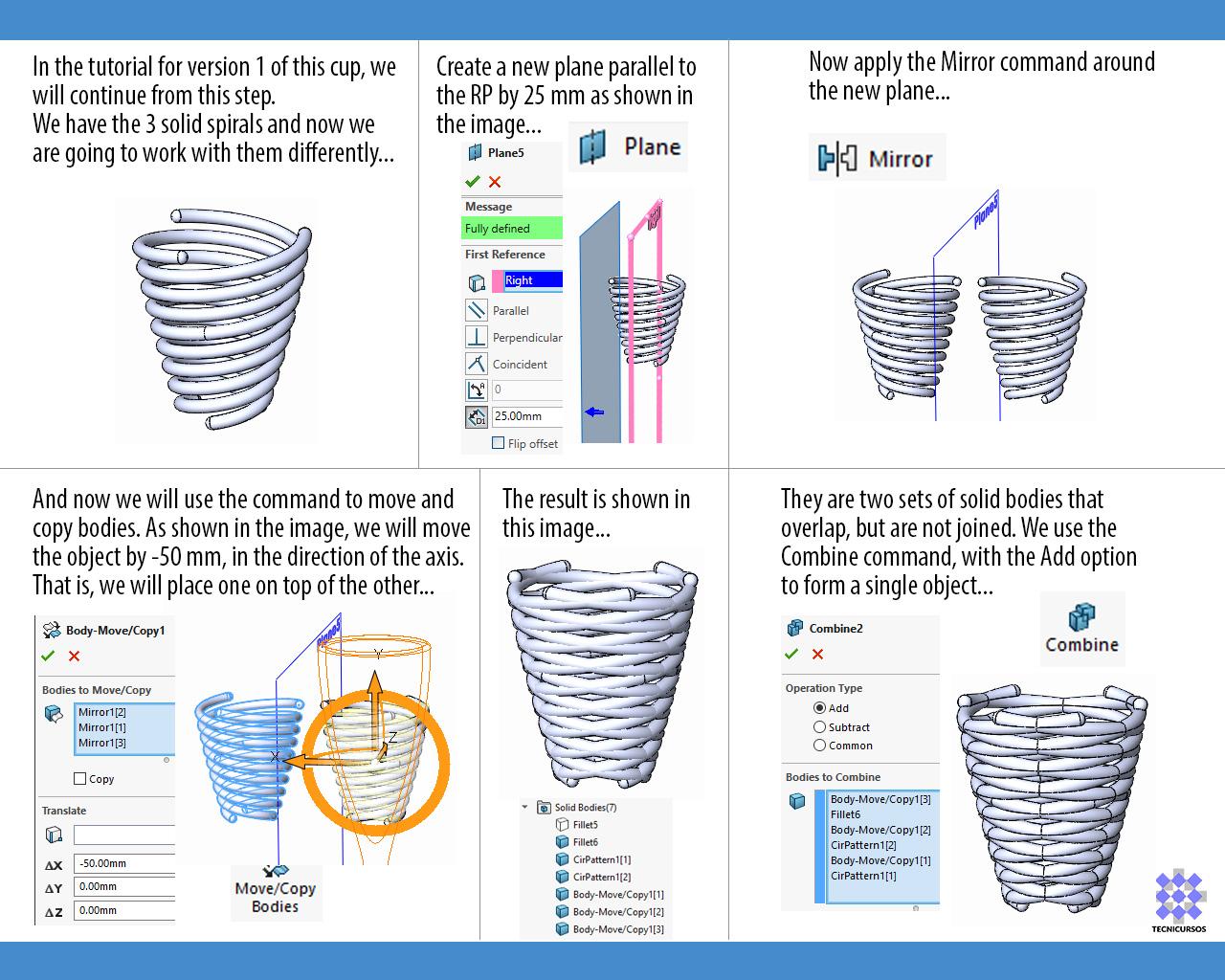

As we can see, here we deviate from the previous tutorial. We create a mirror copy of the three solids that form the spirals, and then mount them one on top of the other...
Step 2: Subtracting...
And this is the whole trick to get a faceting like the one we have achieved.
