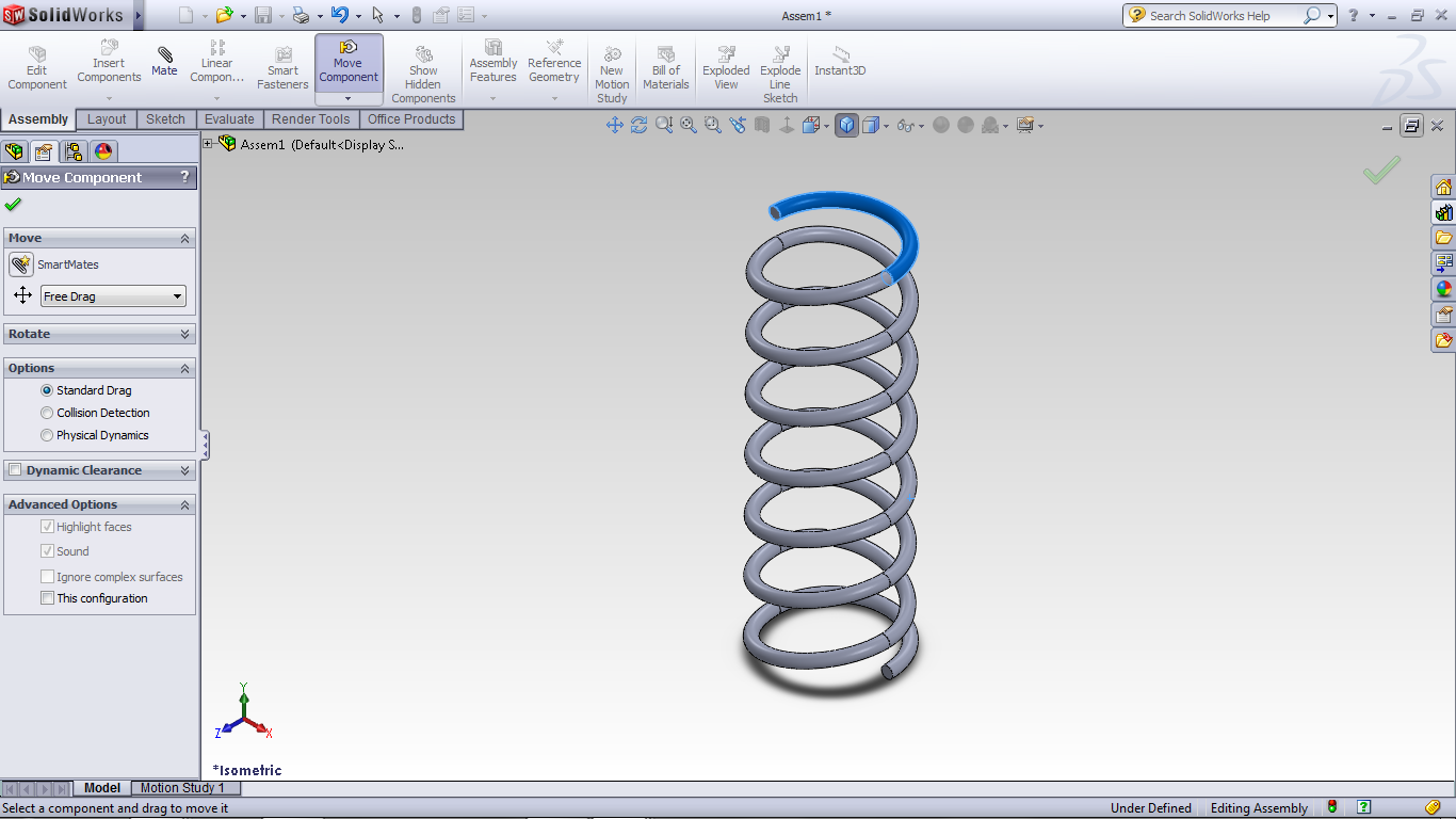

Step 1:

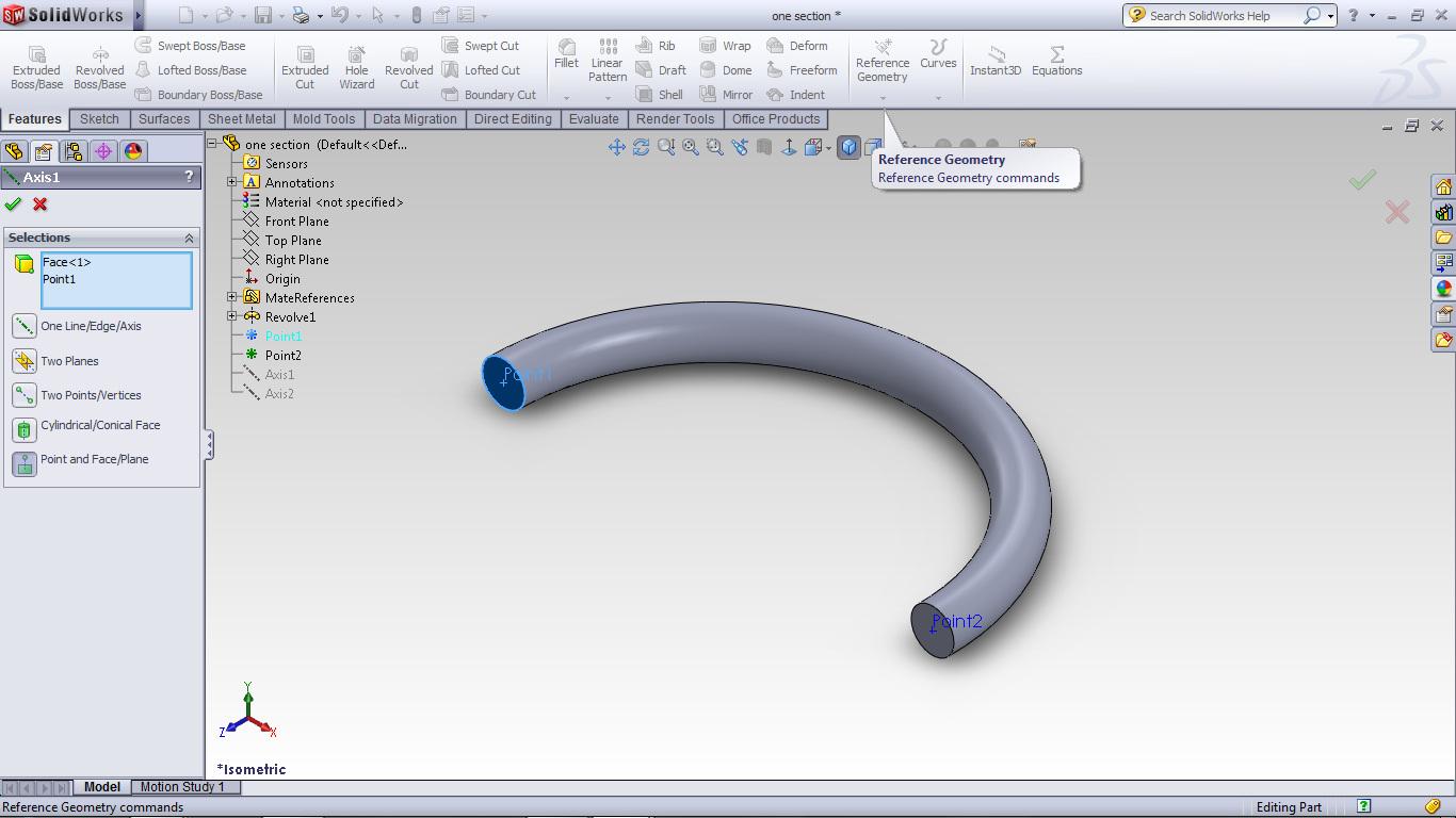

1. Draw a Sketch in Front View as shown in fig. and revolve that circle around center axis to 180 degree.

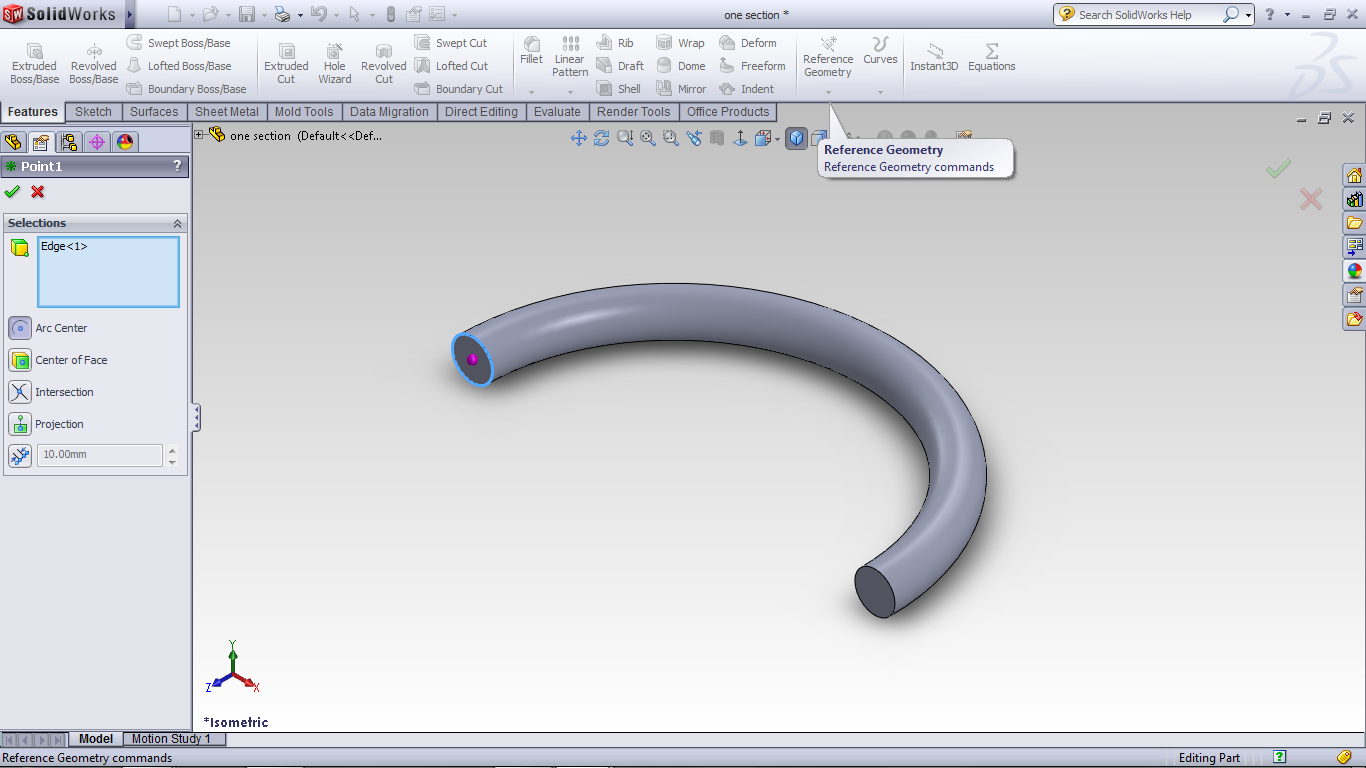

Step 2:
2. Make a reference point from reference geometry. and select the edge of circle as in fig.
do same as in other side -
Step 3:
3. Make a reference axis from reference geometry. and select that point and face of circle is in fig.
Do same as in other side -

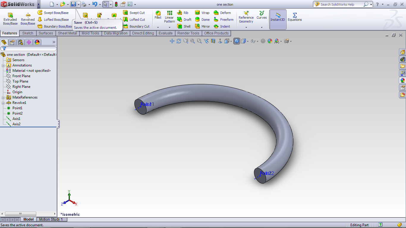

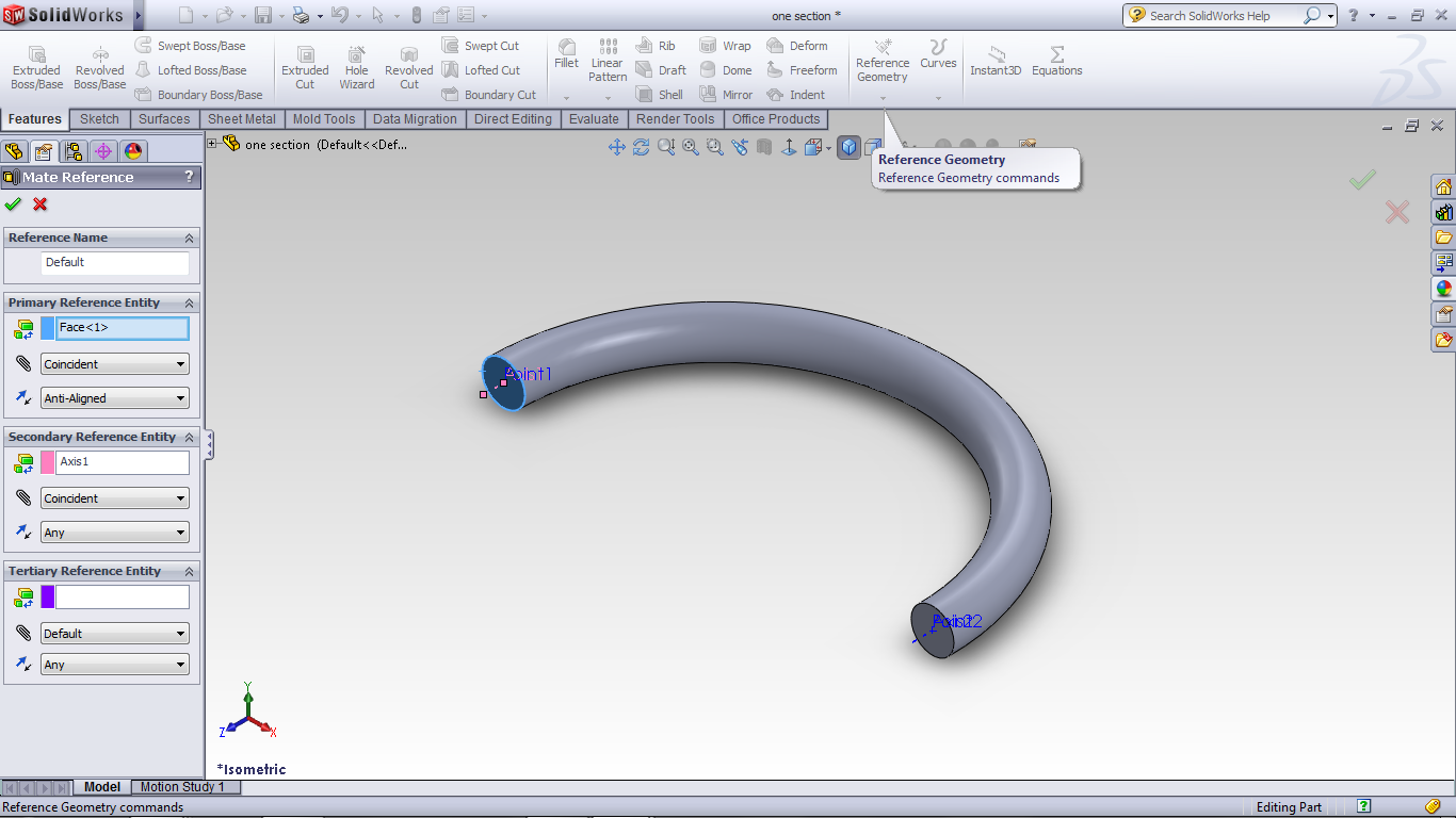

Step 4:
4. Now make a mate reference from reference geometry. in primary reference entry select face.
And select coincident in mate reference type. and select anti-alined in mate reference alinement
In second reference geometry select axis.
And select coincident in mate reference type. and select any in mate reference alinement -
Step 5:
5. Do same in other side. and save the document in a proper known place.

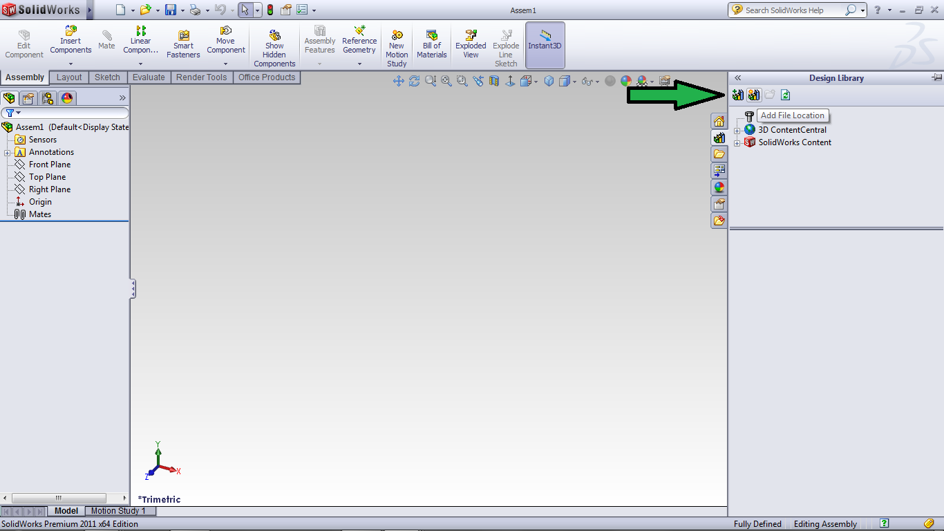

Step 6:

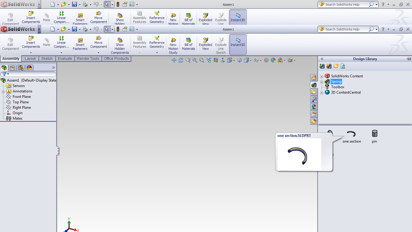

6. Open new assembly..
In design library add file location. -

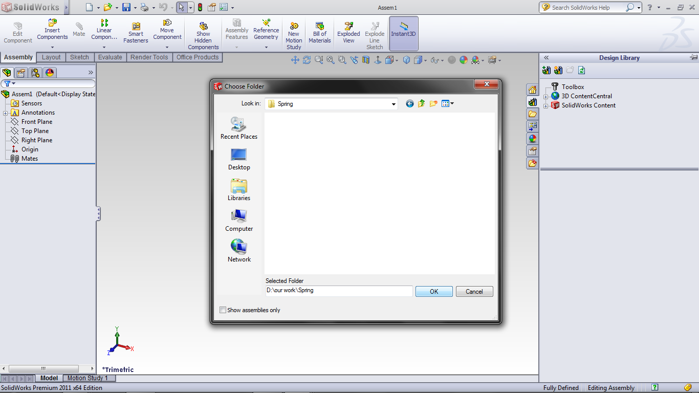

Step 7:
7. Specify the path you saved the document.

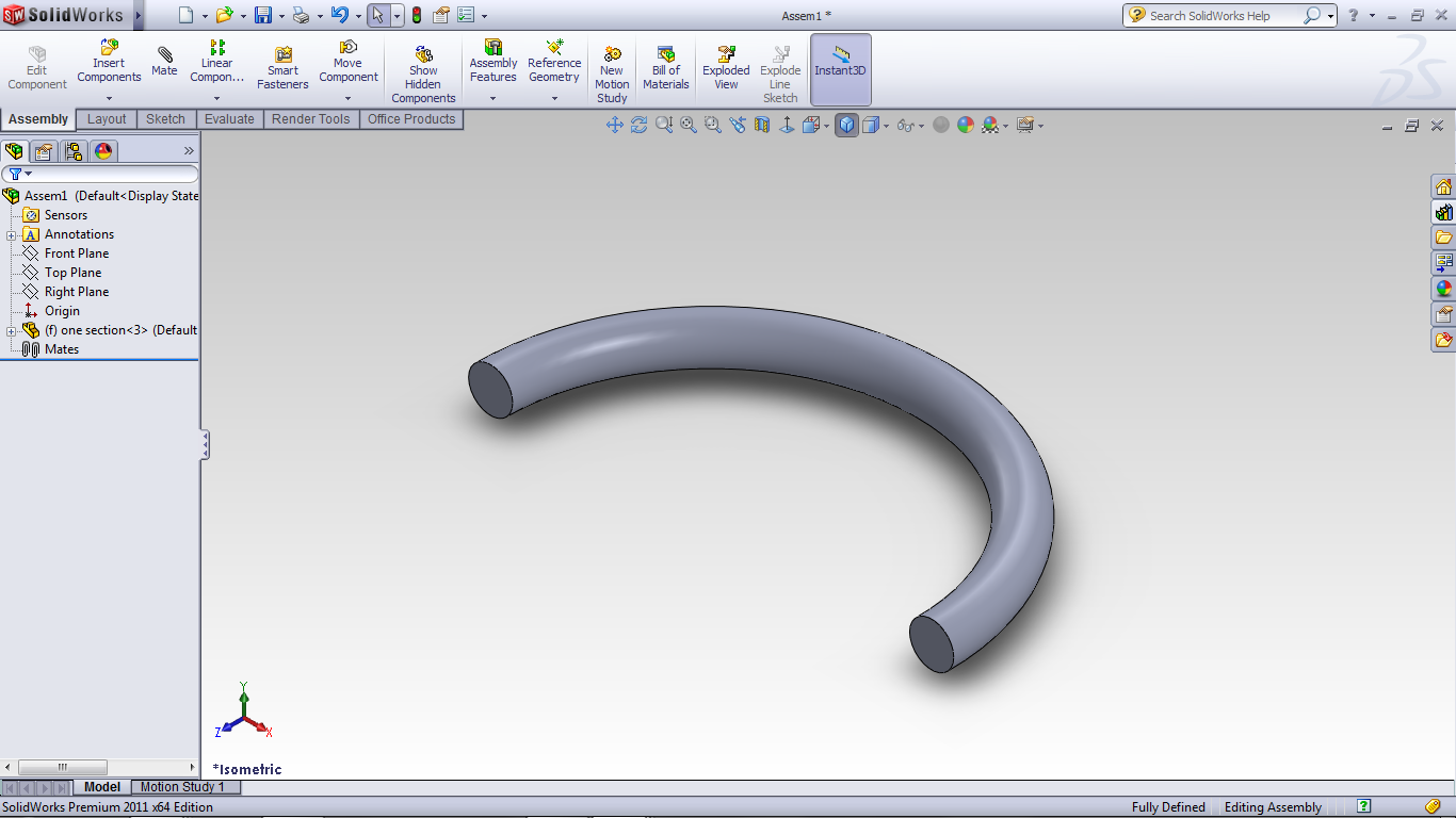

Step 8:
8. Now select the saved part and drag and drop into graphic area anywhere.
Step 9:
9. This will look like this.

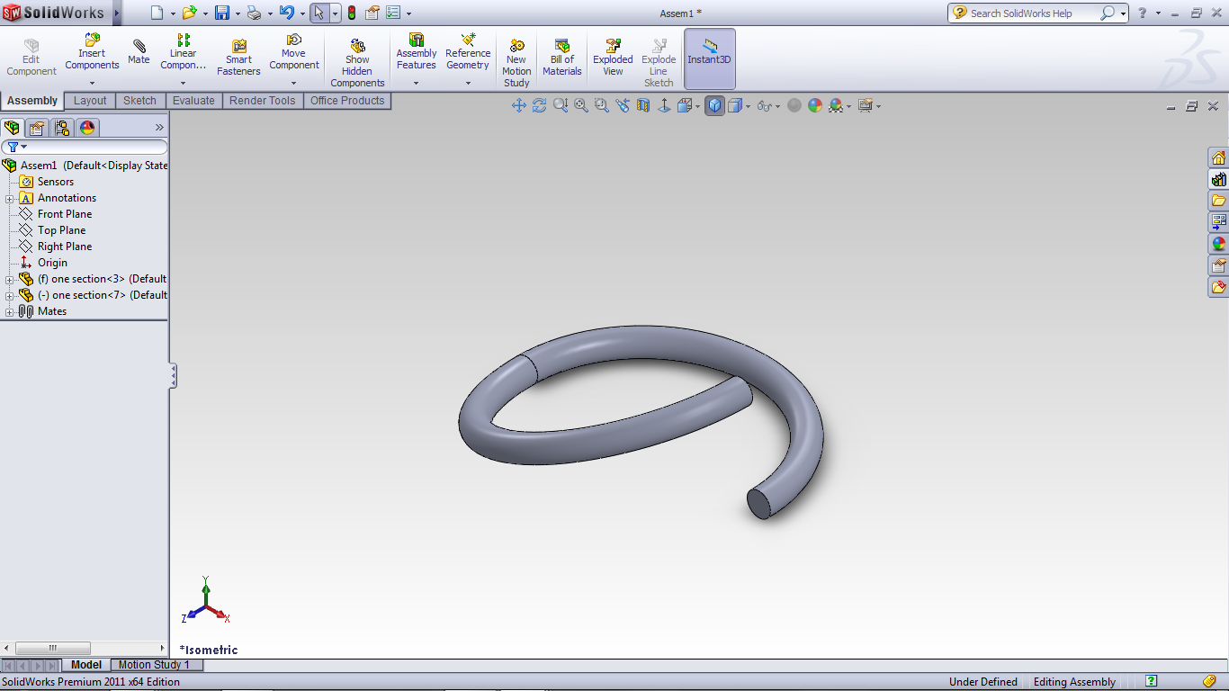

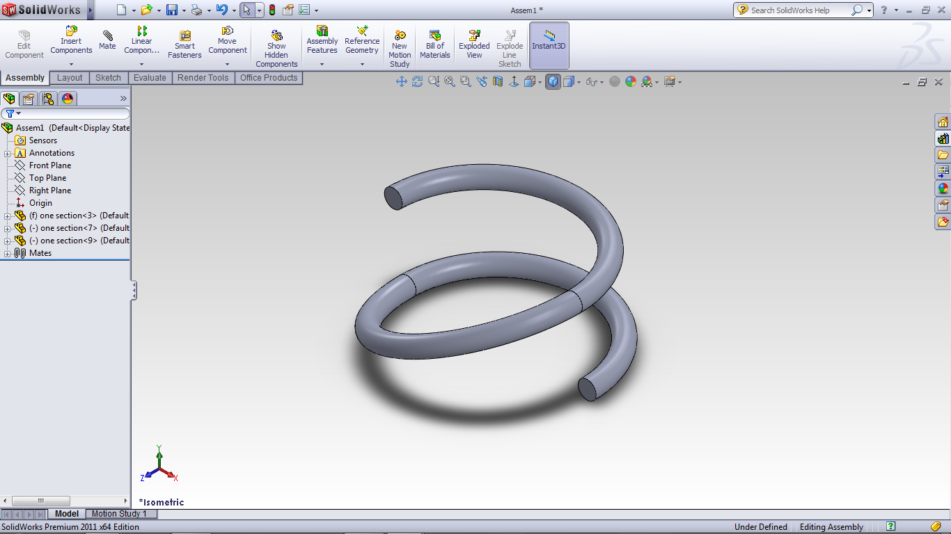

Step 10:
10. When you drag another pert, when you move-over the part on the first one the reference relation
will come and your part will pleased automatically
As shown in this fig. -
Step 11:
11. Now add another part as same method of second one.

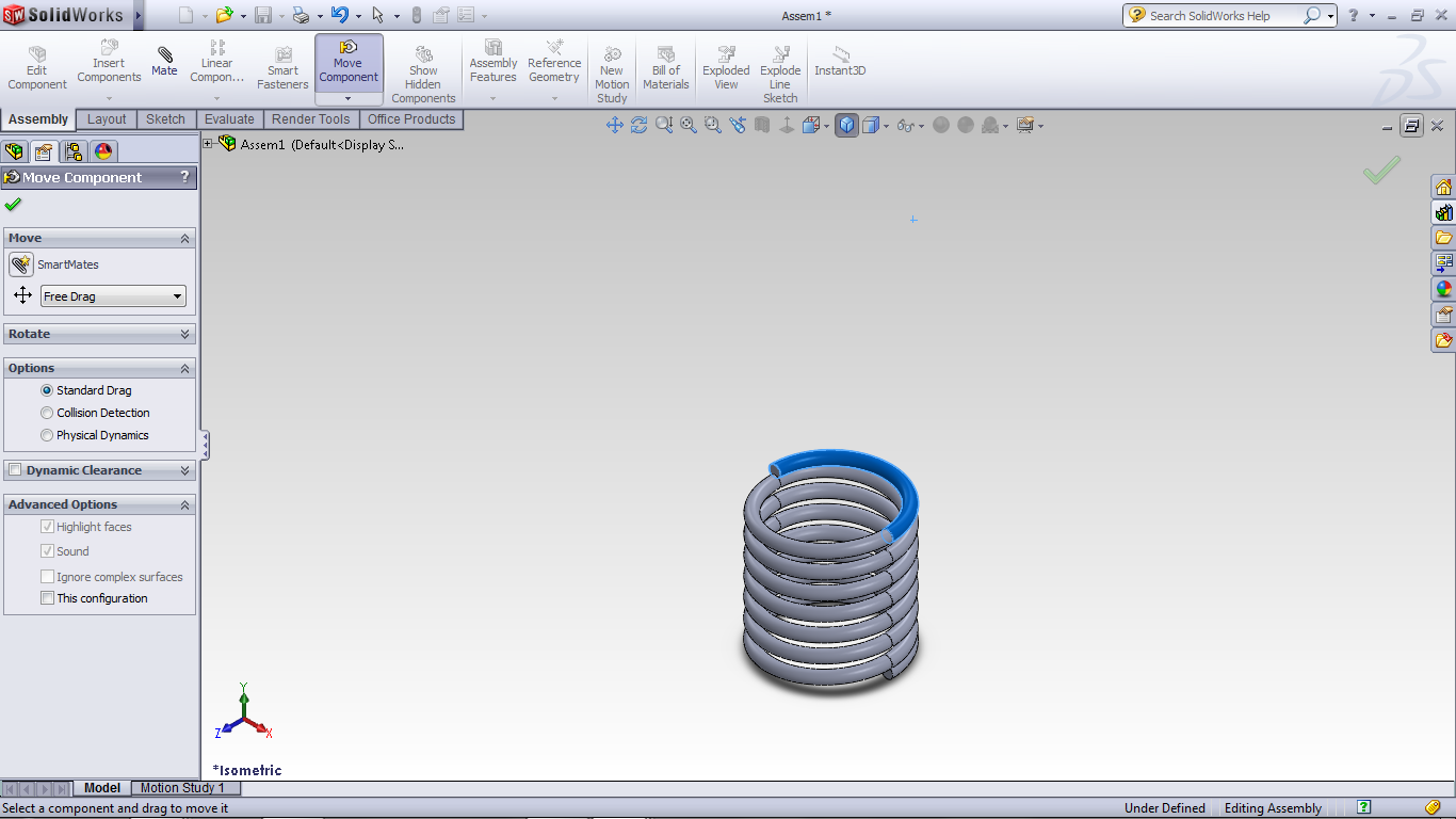

Step 12:
12. Add 15 parts. with same method.

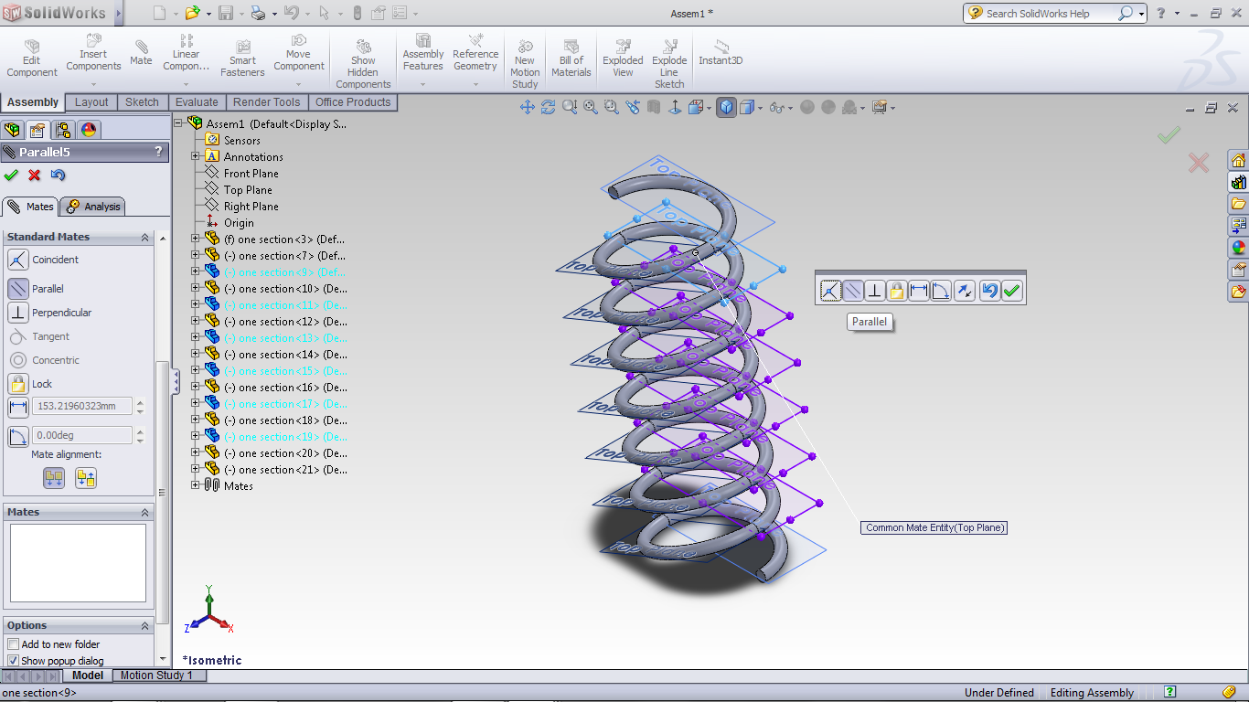

Step 13:
13. First show view planes from the hide show items. then show the top plate of any of the inserted parts.
Step 14:
14. Using multiple mate mode, select parallel relation and select only those top planes that are selected in image.
Step 15:
15. Do same, make another parallel relation for these top planes.
Step 16:
16. Now make parallel top planes of top most and bottom most parts only.
Step 17:
17. Now make right planes coincident of top most and bottom most parts only.
Step 18:
18. Now you are able to move spring in any position.(compressed) using move component commend.
Step 19:
19. Also expended position.
and model is completed.
