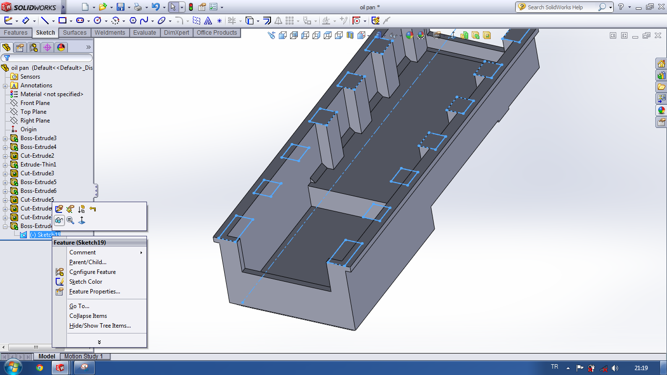

Step 1:
open a sketch on this surface
Step 2:
use cut extrude command
Step 3:
draw shown on the blue surface
Step 4:
please examine the shown sketch. draw the same. then exit from sketch
Step 5:
click on the sketch from feature tree and click on show button

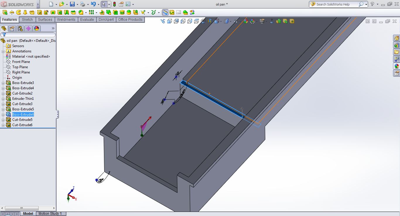

Step 6:
extrude this rectangles up to pink surface

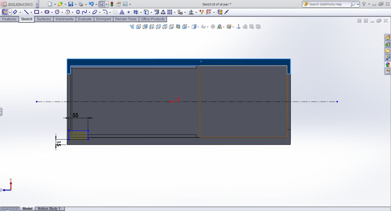

Step 7:
open a sketch on this surface..

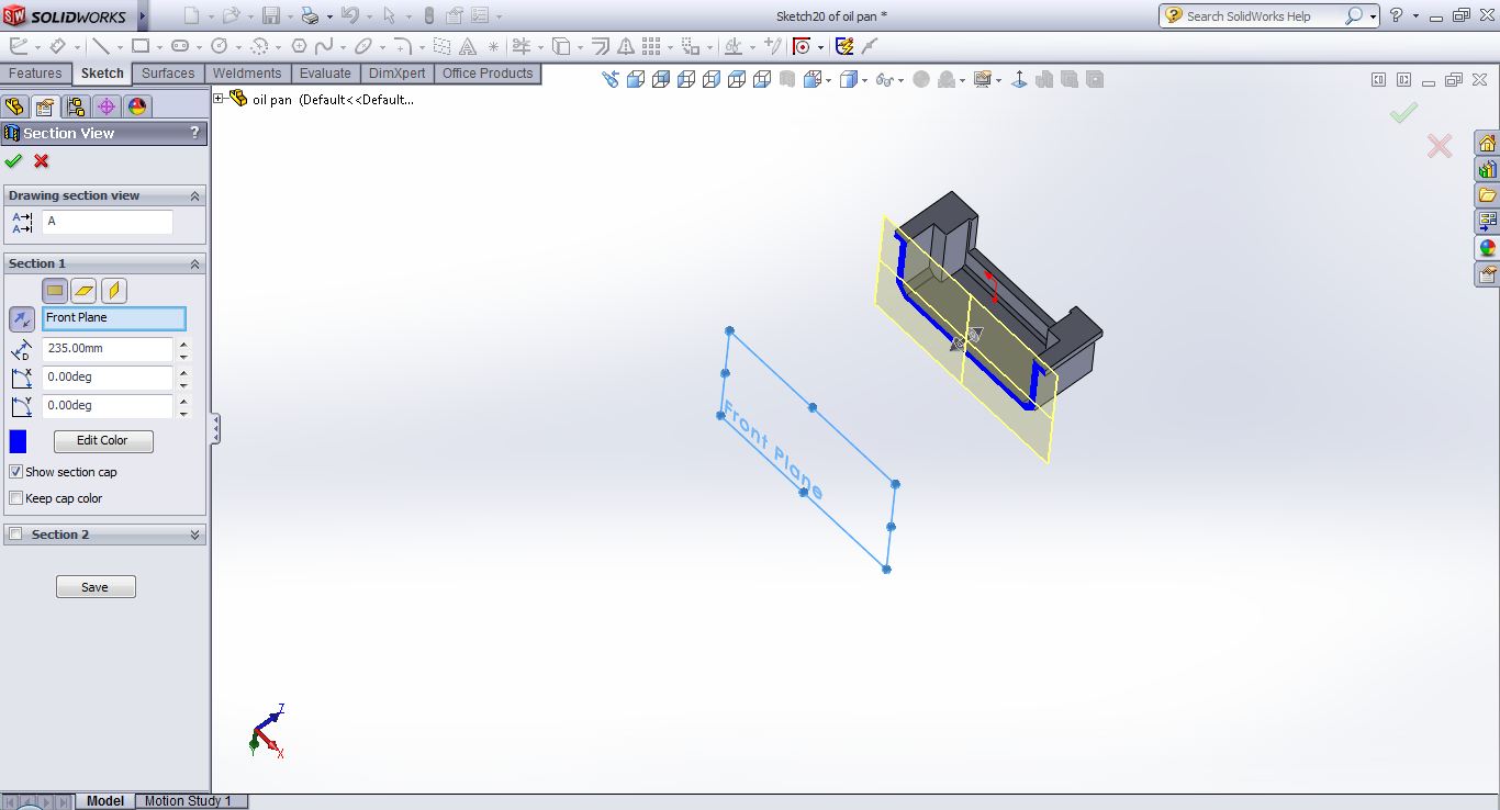

Step 8:
use section view command
Step 9:

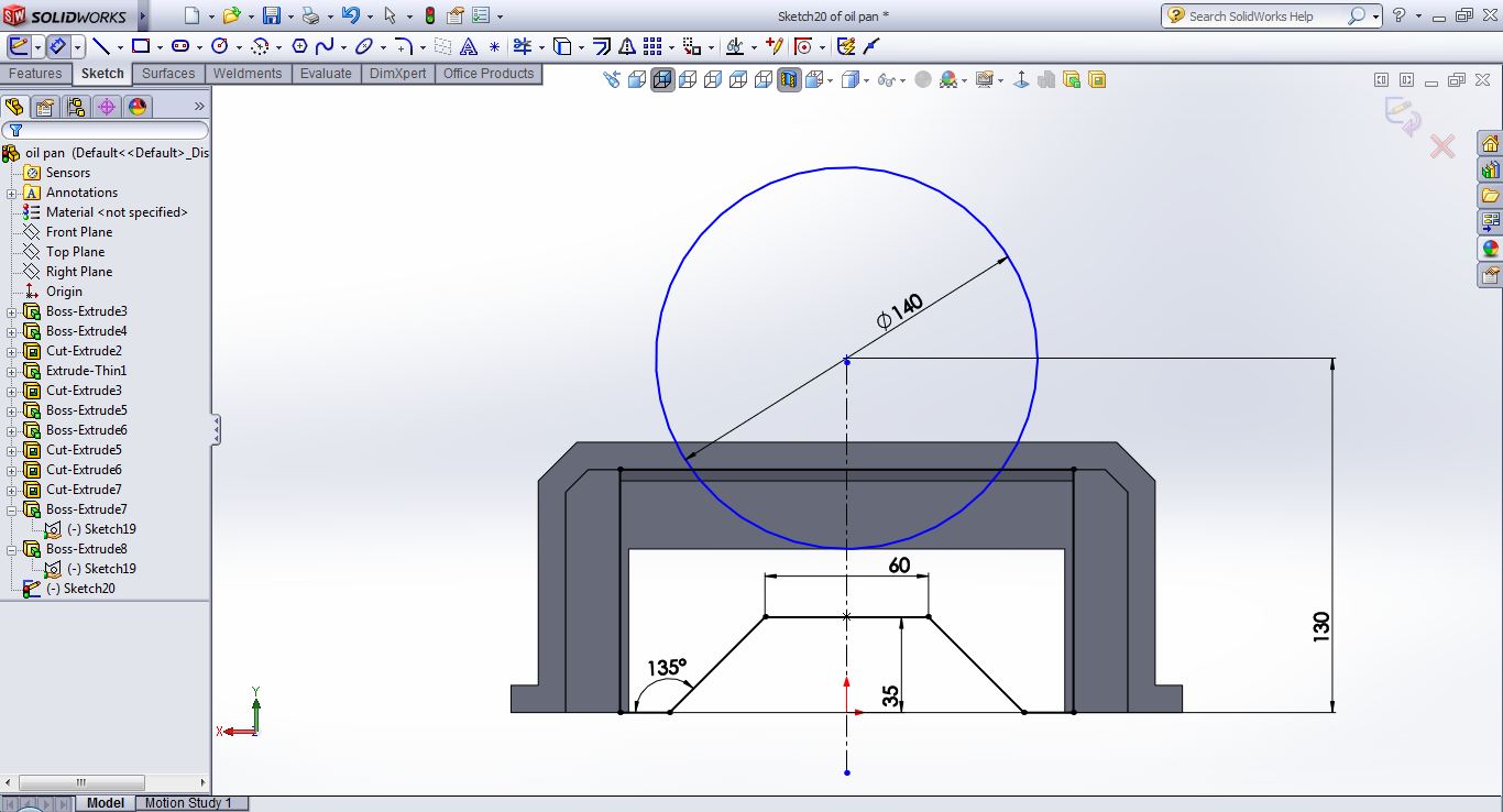

Step 10:
add a circle

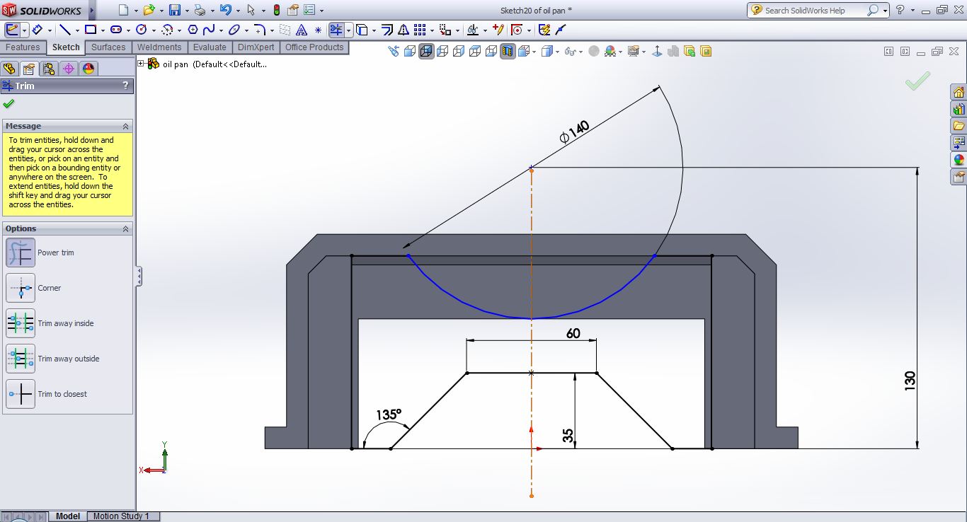

Step 11:
use trim command
Step 12:
extrude the sketch 4mm. make untick 'merge result' option
