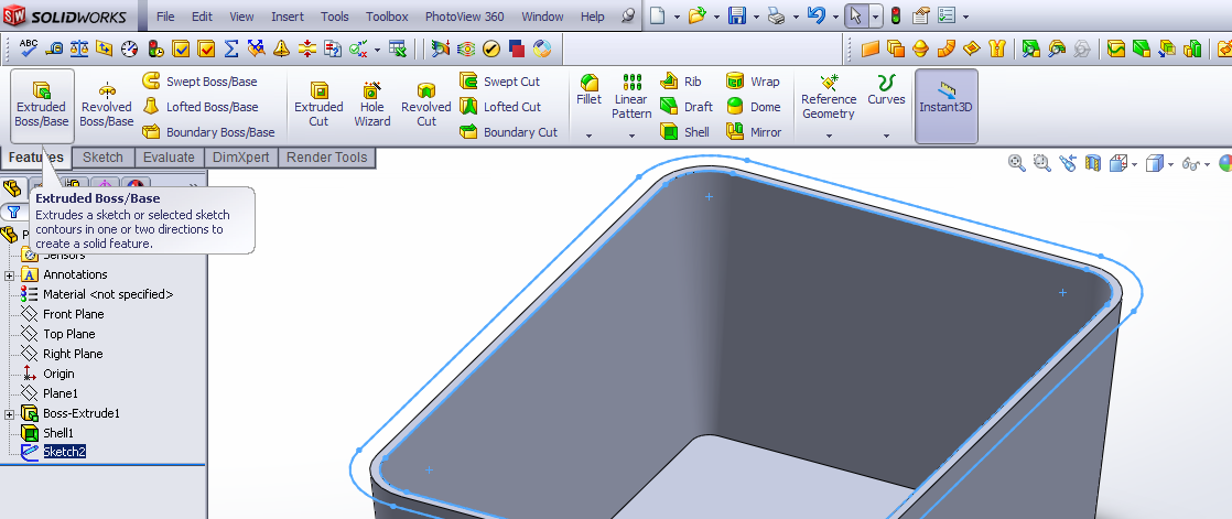

Step 18:
With the last sketch still selected, choose the extruded boss/base button from the features menu ribbon.
Step 19:
extrude down .5 cm.

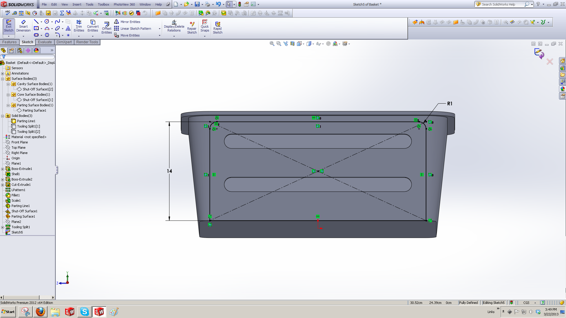

Step 67:
This will open a sketch. I find it easier to sketch with normal to the sketch plane.
Step 68:
create this sketch.
Step 69:
When you exit the sketch, the core property manager will appear.
Step 70:
change the core/cavity body to tooling split one
See picture
