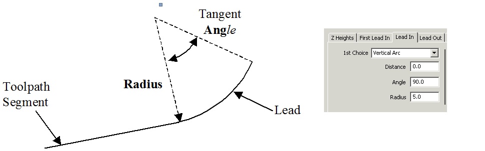

Vertical Arcs
•In the Toolpath Leads and Links Form, select the Lead In tab.
•Select Vertical Arc with a Radius 5 and Angle 90 and press ApplyVertical arcs Leads creates a circular movement downward at the start and upward at the end of each tool track.

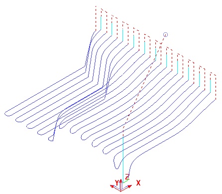

All but one of the Leads has been applied. By default PowerMILL will not apply Leads and Links where gouge would occur. To apply a Horizontal Lead Out to this tool track a different Lead option will be applied to the 2nd Choice area of the form.
•In the Lead Out 2nd Choice area select Horizontal Arc with Angle 90 and Radius 5 then Apply.
PowerMILL has applied a 1st Choice, Horizontal Arc to all parts of this tool track where it can do so as a gouge free move.
At this position the 2nd Choice - Lead Out has been applied in preference to the 1st Choice - Lead Out due to the latter being a potential gouge situation.
As long as the Gouge Check flag is ticked, if both 1st and 2nd Choice options would result in a gouge then a direct Z move will be applied instead. -

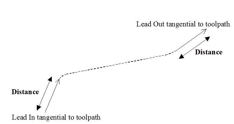

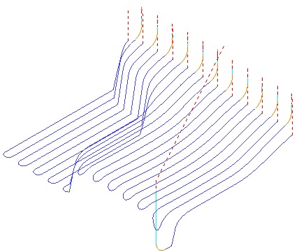

Extended Move
Extended Move inserts a linear, tangential move on to or off the end of a tool track. When selected, the Distance box becomes highlighted ready for the insertion of a suitable value.
Step 9:
Set the Lead Out 1st and 2nd Choices to None.
•Change the Lead In to an Extended Move with Distance 10 as shown and Apply.
The Lead In to each tool track is modified as shown below.

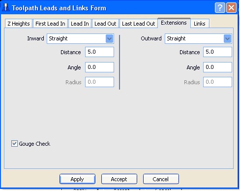

Extensions
An Extension is an additional part of geometry to be added to the start or end of a Lead. For example, a Straight Extension could be added to a Circular Lead In/Out where a machine tool cannot apply cutter compensation on the arc move. The relevant adjustment will occur during the linear extension move.
The geometry options for Extensions are exactly the same as for Leads.
•Activate the toolpath 1_1_1.
•Set the Lead In as Vertical Arc with a Distance of 0, Radius of 5 and an Angle of 45 degrees.
•Select the Copy to Lead Out button.
•Open the Extensions tab and set values as shown and press Apply.Extensions running tangential to the original vertical arc leads are created and can be quite useful to allow an approach from outside of the component surfaces.
•Set the Extensions Inward and Outward to Straight with the values shown.
The Angle in the Straight Extension area is calculated from the direction of the Lead In. To confirm this we can change the angle and view the results. -
