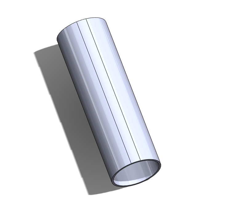

Step 1:
create a split line using two lines as shown, (uncheck the single direction option)
Step 2:
right click on the part in the study tree and define shell by selected faces. Place the force on one of the split faces and a fixed geometry on the other. You shouldn't have any issue with getting relatively accurate results.
Step 3:
Keep in mind that my setup is just a guideline and not indicative of exact boundary conditions
