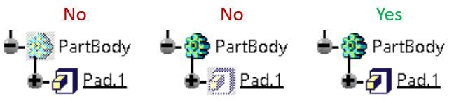

How do I get my hidden part back? KUNJ THUMMAR 10 Dec, 2019 10:26 AM I am hiding a part while giving constraints to the inner parts of the CATIA V5 Assembly design. But when I select the hidden outer part and click on show again, the part is still invisible and is not shown back. 2 Answers DKS Answered on 10 Dec, 2019 01:40 PM this is the option CATIA V5 - _Part1_ 12_10_2019 7_04_59 PM.png Carlos Vargas Answered on 7 Jan, 2020 12:45 AM Go to the tree and show all; if the operations or the main body are hidden, you cannot see it. See attached picture. Catia 02.JPG
