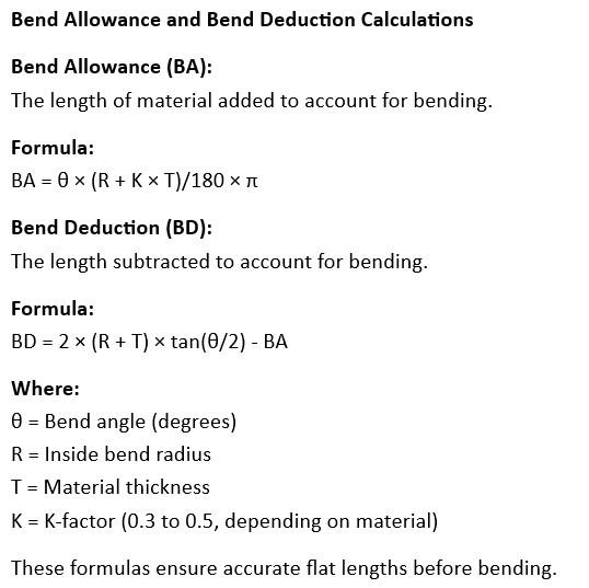

How do you calculate bend allowance and bend deduction? Mohammed Almeldein 18 Aug, 2024 08:10 AM How do you calculate bend allowance and bend deduction? 1 Answer Athul Gopinathan Answered on 20 Aug, 2024 07:28 AM I couldnt type the formula here so please refer to the attachment formula 1.jpg
