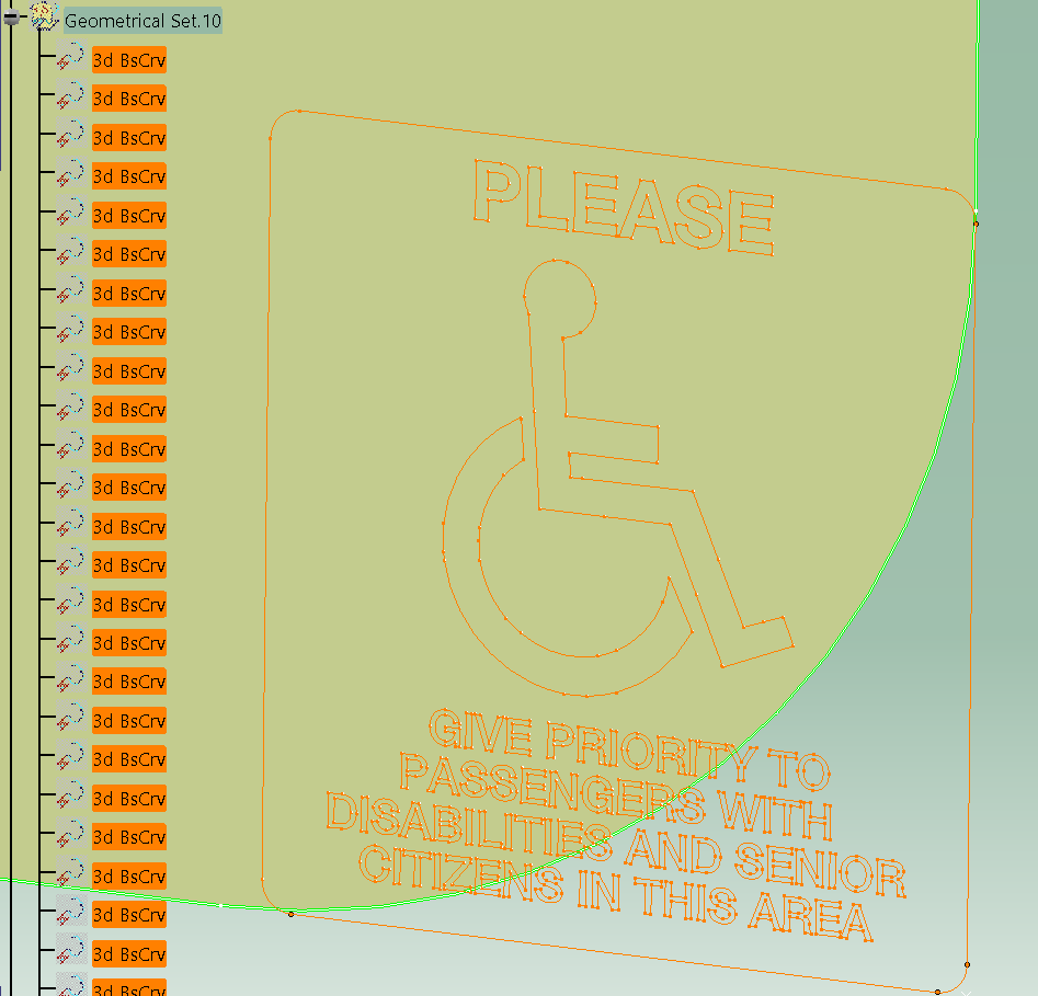

How to export from a dxf into a geometrical set in Catia? Rolando Stc 28 Aug, 2024 01:57 PM As you can see in the attached picture, we have some dxf labels coming from adobe illustrator, each line was added into a geometrical set to process them on the generative shape design module. Do you know how to perform this export? DXF-Geometrical Set.png 1 Answer Jack K Answered on 30 Aug, 2024 01:16 PM Open the dxf file with CATIA. Depending on the dxf file format, it might open with all the lines and curves in a Geometric Set as you want. If it opens as a drawing; copy all the lines and curves and paste them into a Geometric Set.
