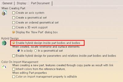

Hey there CATIA users,
I have a problem with the placing of the Geometrical Set into the Body. I installed version 27 and everything works fine except for that.
Could you, please, help me?

You must be in Hybrid Design mode in order to have Geomeric Sets with a body. Do you need the steps for how to do this?
To reset the option for Hybrid Design:
1. Tools (top menu) + Options
2. Infrastructure (left side) + Part Infrastructure
3. Part Document (top of panel)
4. activate (orange) the Enable Hybrid Design option
You probably should close any CATIA files you have open before you do these steps. And then re-open the files after resetting the options.
In the Hybrid Design mode, you can insert Geometric Sets in a Body.
sorry to bother you, but I had another idea.... Are you trying to insert a new Geometric Set into the body, or are you trying to reorder an existing Geometric Set?
If reordering, you have to place it in the tree above all of it's children. When using Hybrid Design, bodies and Geometric Sets are ordered (sequential) and parents must come before the children.
