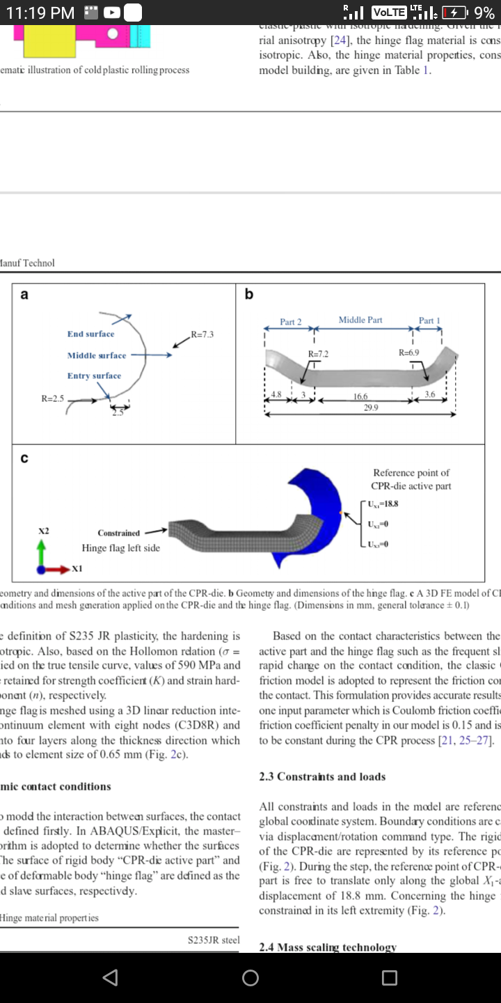

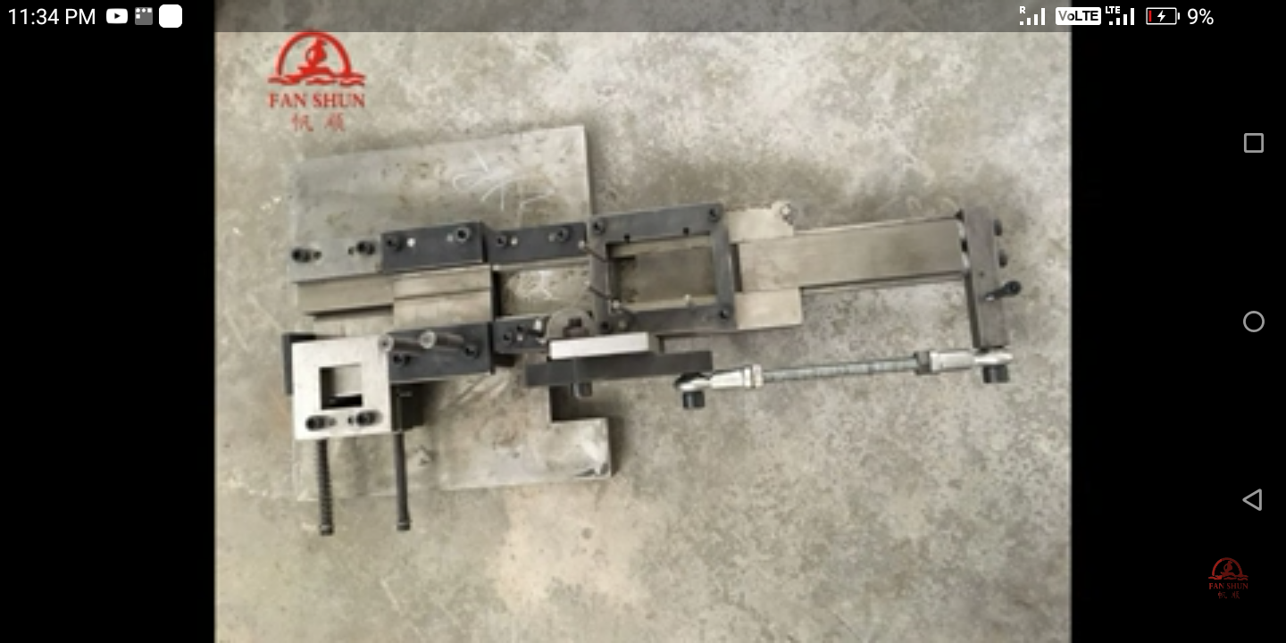

How can I calculate dimension for hinge making die according to rod inserted in hinge .. this is the 1st process hinge flange making and after it is crimped in die I am unable to calculate this dimensions video in the link
