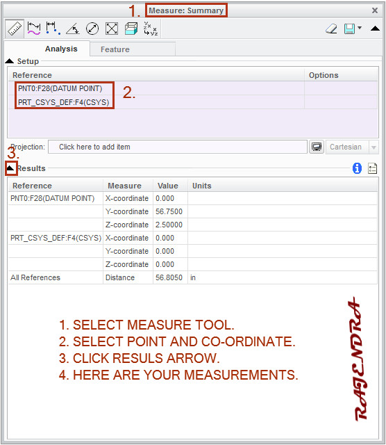

what is measurement summary mike thompson 27 Jan, 2014 02:52 PM How do you display the X Y Z coordinates when using the measure command 1 Answer Rajendra Kinkar Answered on 23 Aug, 2014 10:22 AM see the image Snap1.jpg
