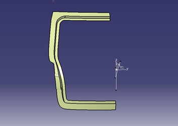

Outer Panel: The outer panel serves as the outer styling skin surface of the backdoor. It is coated with multistage coatings that provide properties such as scratch resistance and rust prevention. The outer panel is wrapped around the inner panel using a hemming process.

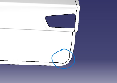

Corner Relief:
During the hemming process, the use of multiple rollers can result in vibrations and stress concentrations at certain locations, particularly at the corners. These conditions can affect the design intent of the panel, as the desired outcome is for the panel to spring back to its original formation once the roller is removed. However, corners often do not behave in the same manner, and the panel may not return to its intended shape.

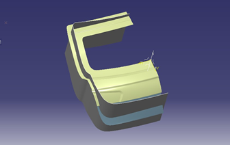

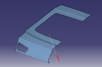

Step 4: Creation of tooling axis
First, we need to create the Tooling direction for the Deep drawing operation. It shows that all the operations like embossing are done by considering this vector direction and it will help in manufacturing the part,

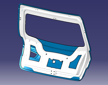

Step 5: Design of inner panel
Then we will be creating the Back door inner panel flange by offsetting the outer surface at a distance considering the sheet thickness and thickening direction.
Then created the connecting flange to join the inner panel and sealing flange.
Then for the windshield panel mounting, the windshield panel is created and joined with a sealing flange.

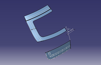

Offset the class A surface downward direction. To perform Hemming, offset the present surface to 0.95mm (inner Surface Thickness- 0.75mm, Inner panel thickness- 0.75 gap between Outer and Inner panel – 0.2mm, Hemming area bent region- 0.75mm, the gap between hem and Inner panel- 0.2mm)
Use the parallel curve option to 10mm to create the surface.
Using the sweep command sweep the parallel curve with the tooling direction.
Using the split command split the offset surface.
- Now, use the offset of 1.7 to trim the sweep and creating a surface.
- After creating the boundary surface of the inner surface, extract the windshield area and extract it.
- Now create a sweep inside with an angle of 25 degrees and trim it with windshield extract.

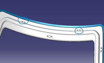

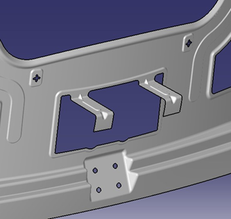

The inner panel base surface is complete. The next step is creating the embosses, Gas stay mount, Hinges mount, Sticker mount, creating mastic data and wiper motor mount
Step 6: Engineering Features

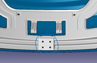

Hinges support mount
Gas stay mount
Wiper motor mount
Embosses
Mastic data region
Sticker mount
Hemming and corner relief

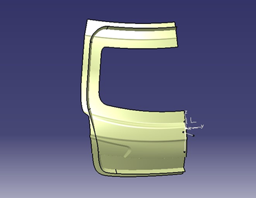

Step 7: Draft Analysis
Draft analysis of inner pannel

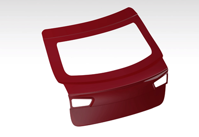

Step 8: Back door parts
Outer panel:
Inner panel:
Assembly of the outer panel and inner panel:
