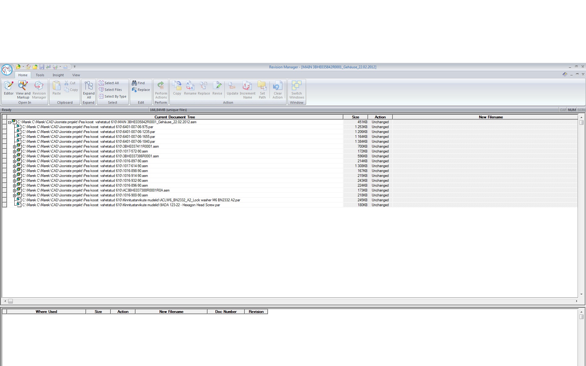

Step 1:
Open with revision manager your main assembly file. Also it can be your main assembly draft file.
Step 2:
Then:
1.Select all
2. Copy
3. Set a path (the new folder can't be inside of your main assembly folder)
4. Perform Actions
You are done.
