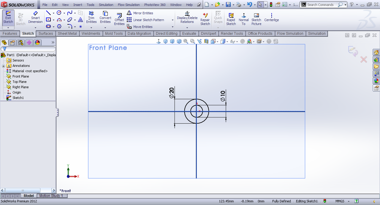

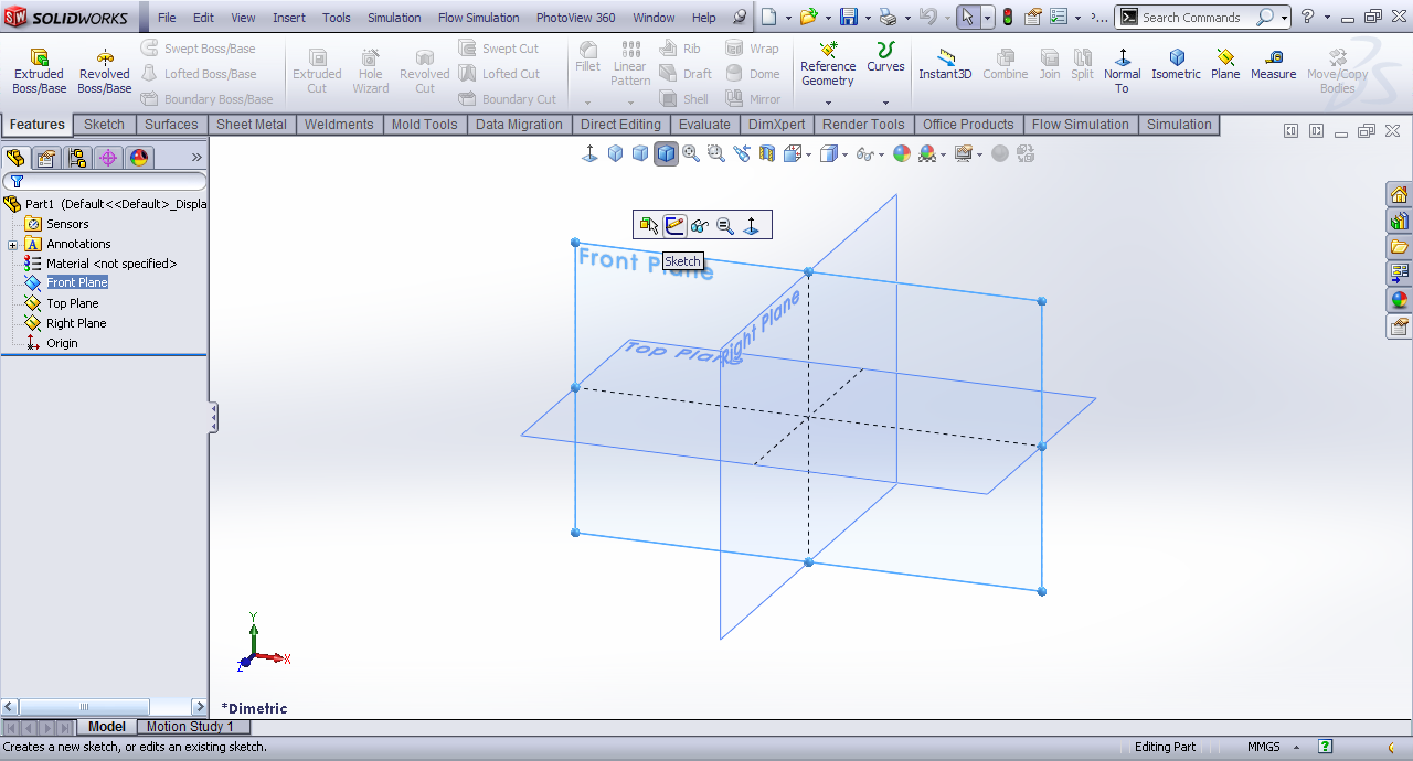

    Front Plane>>Sketch.

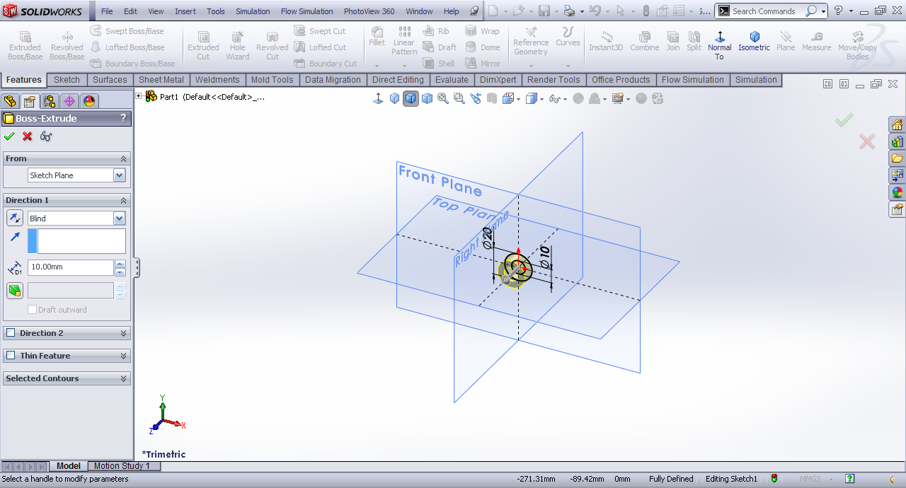

  3. Step 3:

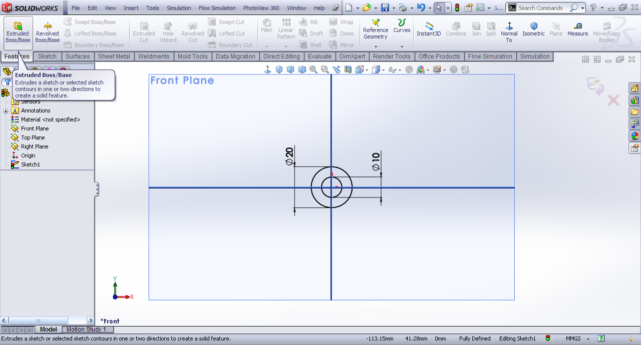

    Draw two circles of 20mm and 10mm dia.
  4. Step 4:
    Extruded boss/base.
  5. Step 5:
    Extrude it by 10mm.

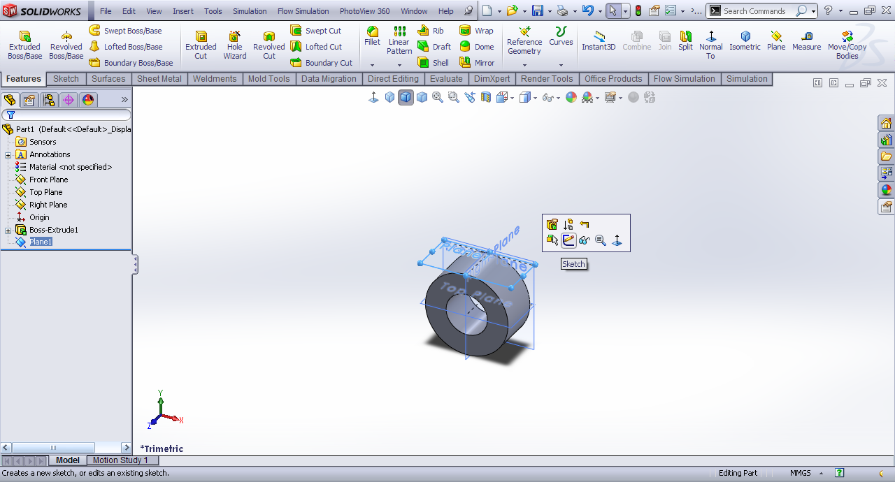

  6. Step 6:
    Reference geometry>>plane and then select top plane at 10mm.

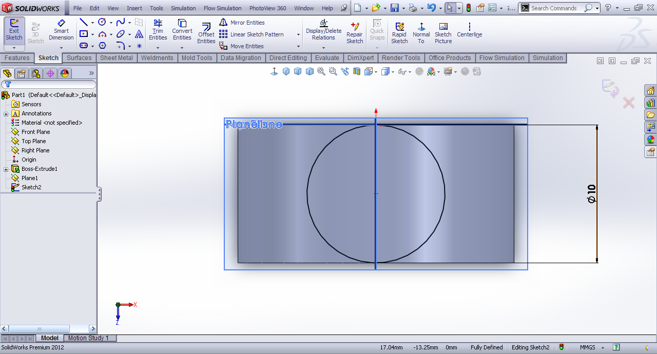

  7. Step 7:
    Plane1>>sketch.
  8. Step 8:

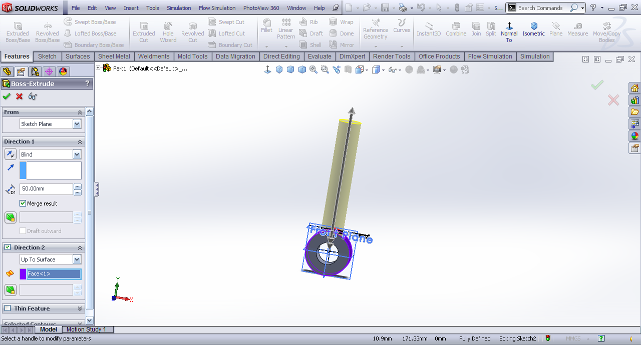

    Draw a circle of 10mm dia.
  9. Step 9:
    Extrude it by these settings.
  10. Step 10:

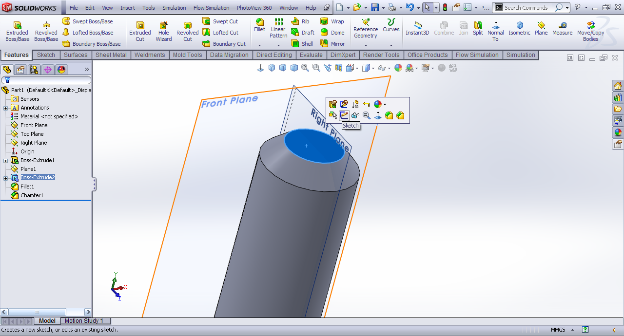

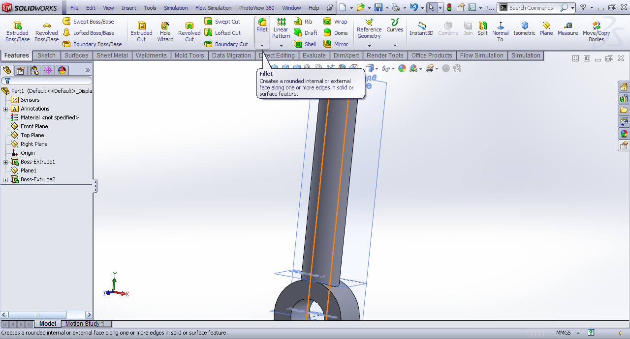

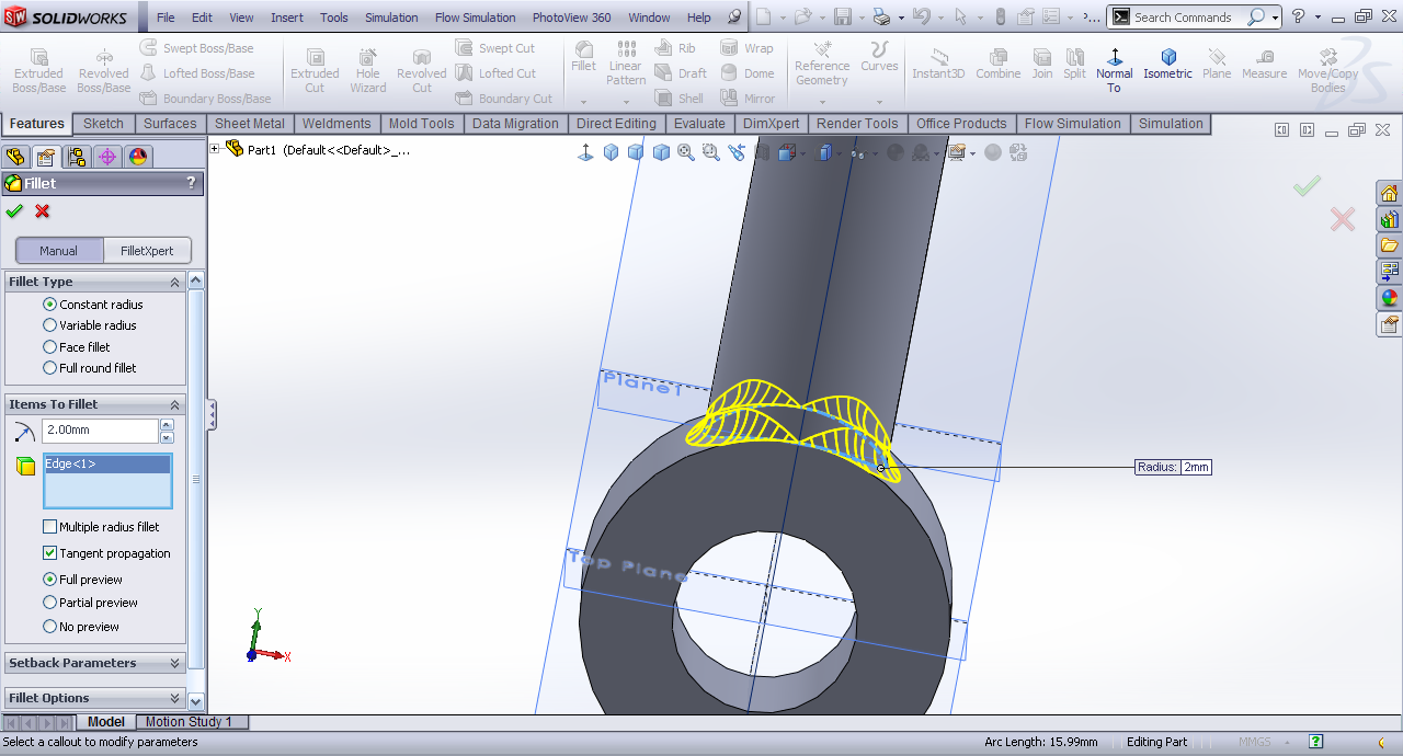

    Choose fillet.
  11. Step 11:
    Fillet the intersection edges.

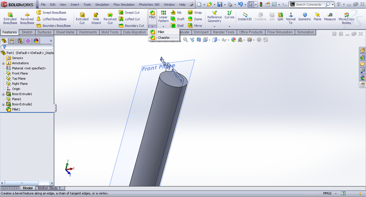

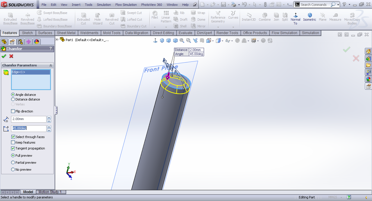

  12. Step 12:
    Chamfer.
  13. Step 13:
    Top edge at 2mm and 45º.
  14. Step 14:

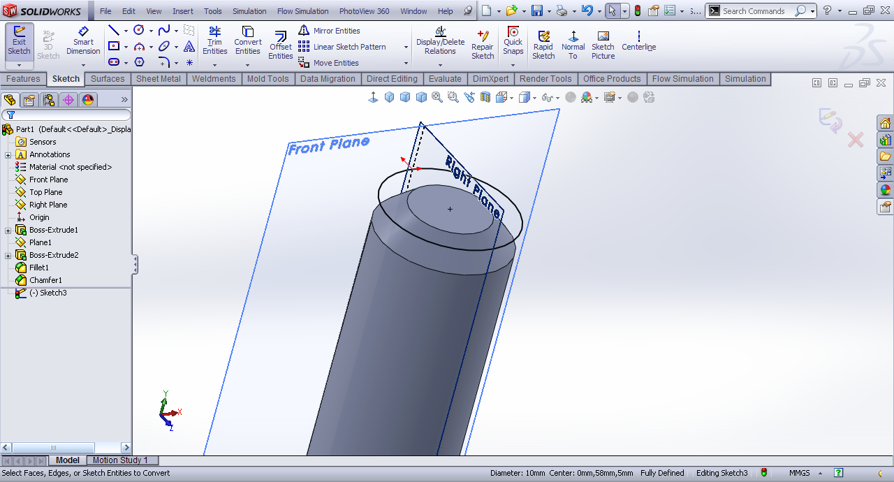

    Top face>>Sketch.
  15. Step 15:
    Convert the outer edge.
  16. Step 16:

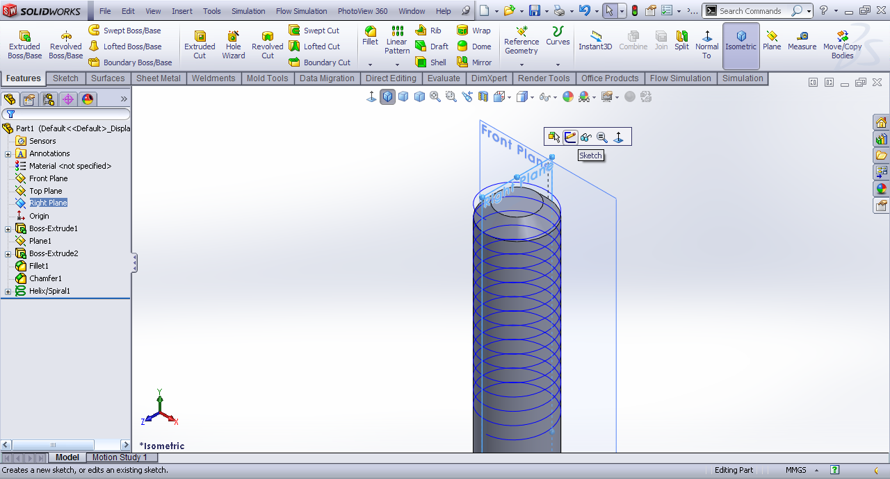

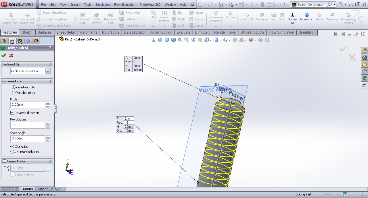

    Helix of 2mm pitch and 15 revolutions at 0º start angle.
  17. Step 17:
    Right plane>>Sketch.
  18. Step 18:

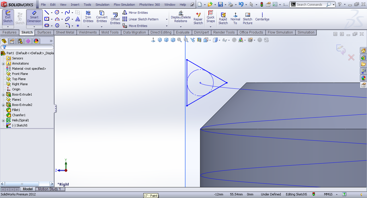

    Draw a profile like this co-incident to the helix using polygon tool.

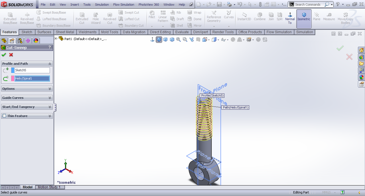

  19. Step 19:

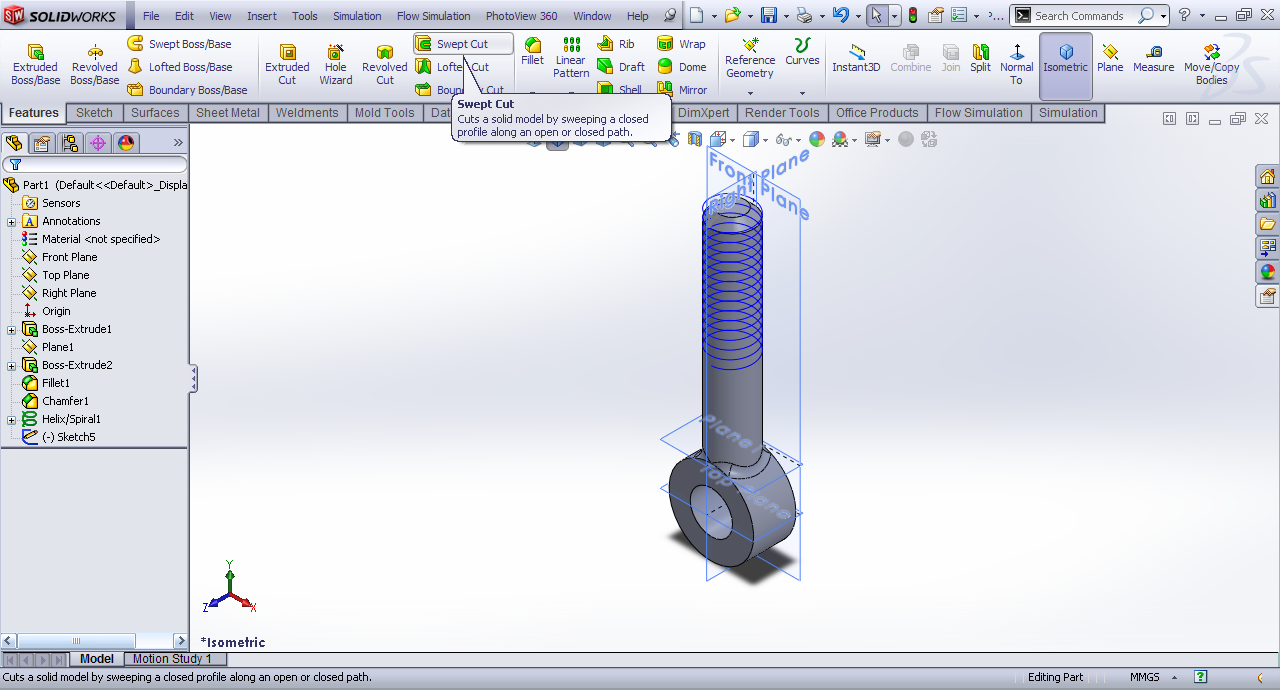

    Sweep cut under features tab.
  20. Step 20:
    Select the triangle as profile and helix as the path.

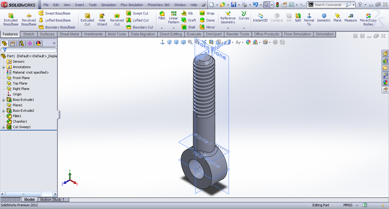

  21. Step 21:
    And we have the bolt.
